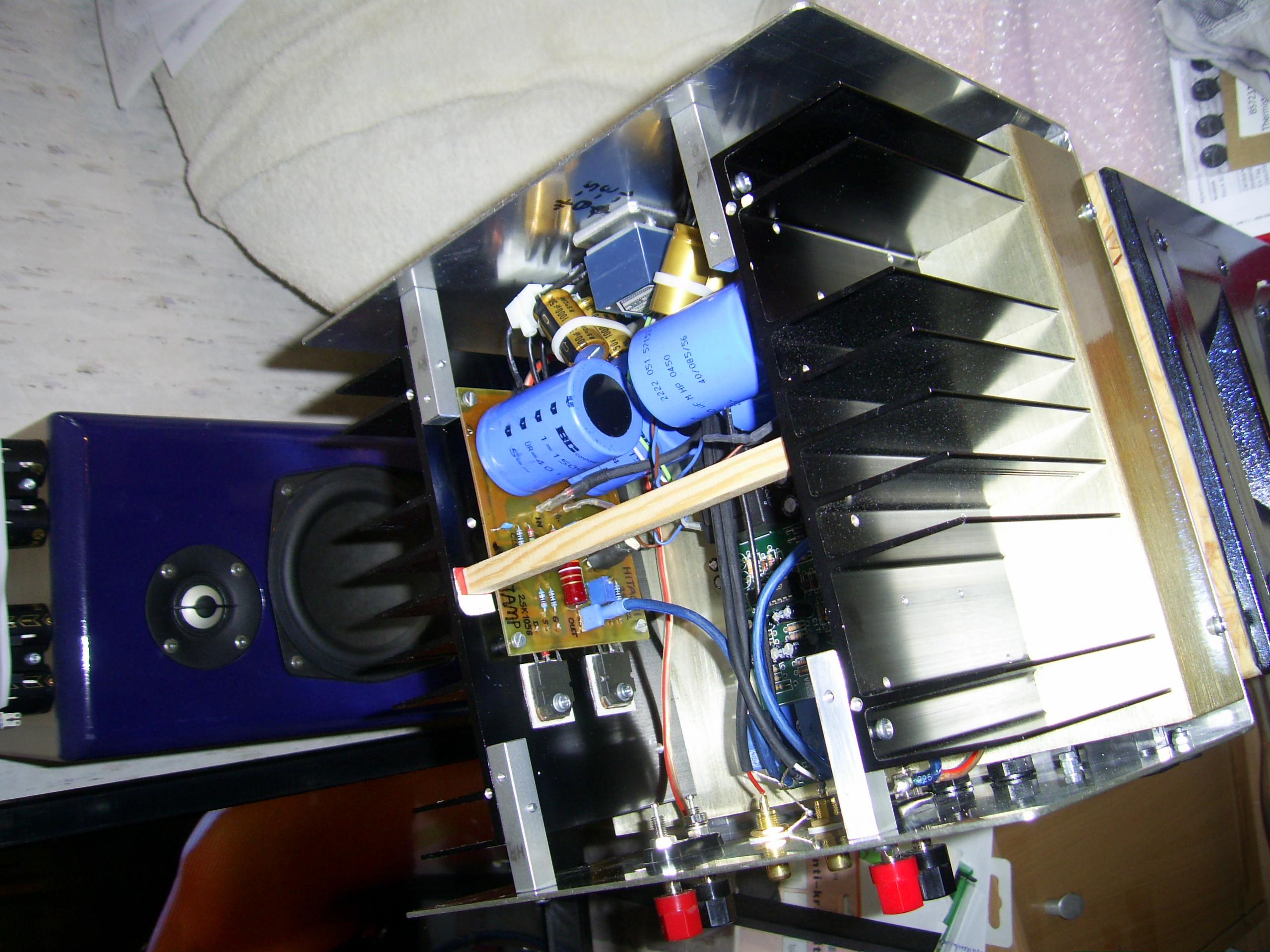

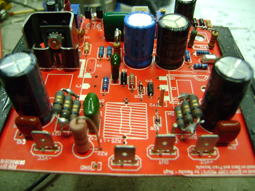

Hi Fellas,
first to all thanks for the good and kind working together (ideas, boards, help, advise, explanation)- a nice project to enjoy and learn a bit.
after several days listening with burn in the foil cap (same as in FetZilla) this amp plays very cool. 😀 😀
The PSU is only 28VDC- 2 x cap bank each 4 x 6800uF/40V + MUR820.
On Input is a 100k pot- and this animal has a lot gain- dynamic goes forward, if you turn pot more cw- wow.
It has an fresh breath. From mids to topend it is very clear and transparent-
nuances in micro details are easy listenable. So you mean losses in bass- no no- it plays deep and well contoured too- even slimm not thin!!!
Stage is on speaker line and with good material goes easy form speaker forward, backward and also wider out of speaker with more clear separation
as other builds- FX8 is a bit more closed together.
This amp is close in neighborhood with other who i like in tonality- every is a
bit different what is preferential.
And here comes the Fetzilla in to the game. 😛 half finished case now
It could be because i have add a PIO to the input foil cap this gives a other
coloration?
That is the point where wins the FZ to me. The female vocals, brass and strings have a bit its own color and bit more fuller bodied tonality- difficult to describe, but i like that more for long listening.
Could it have to do with LatFet there? on other hand the LAPT Sanken plays
fresh, not harsch- i know.

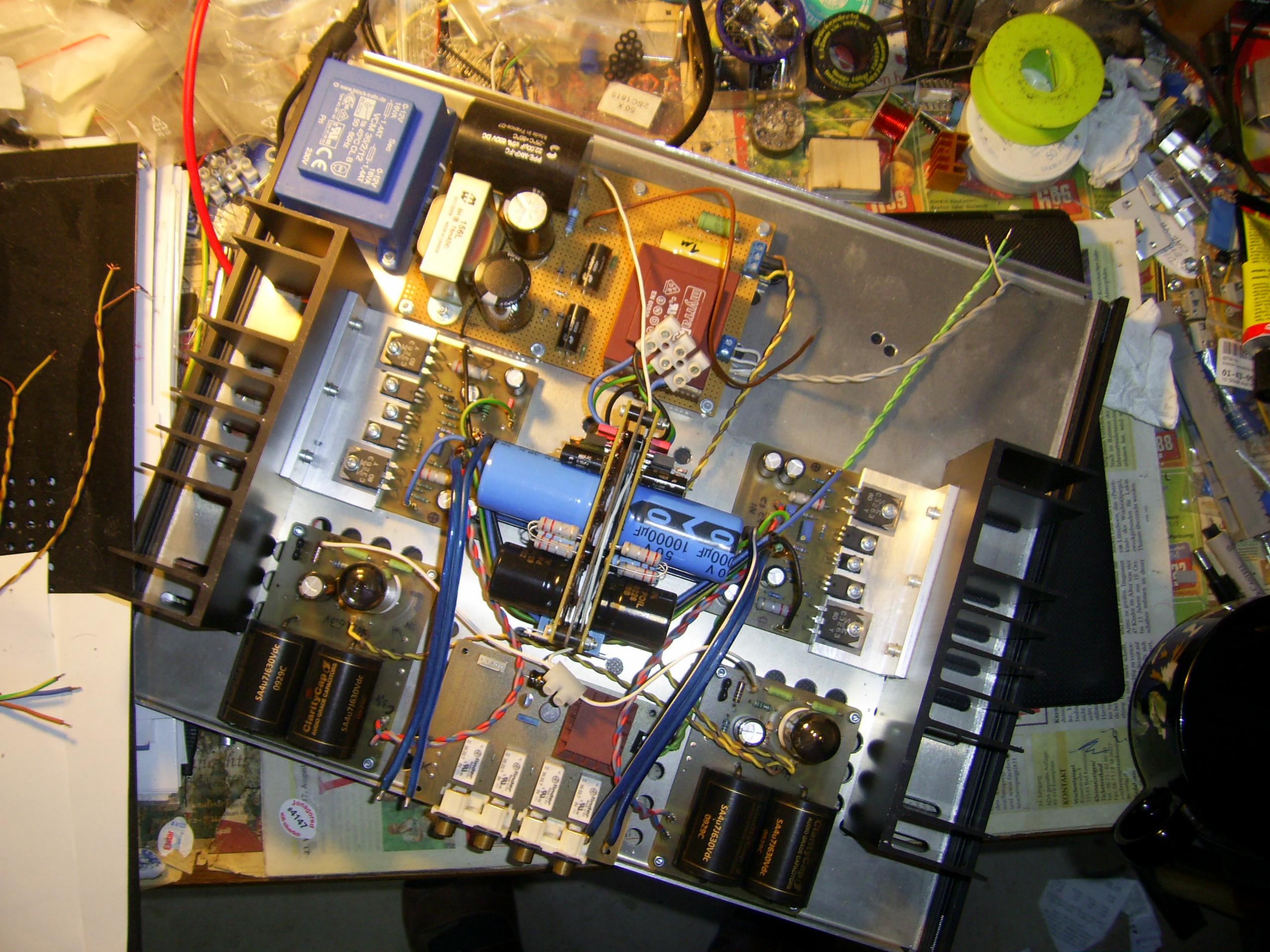

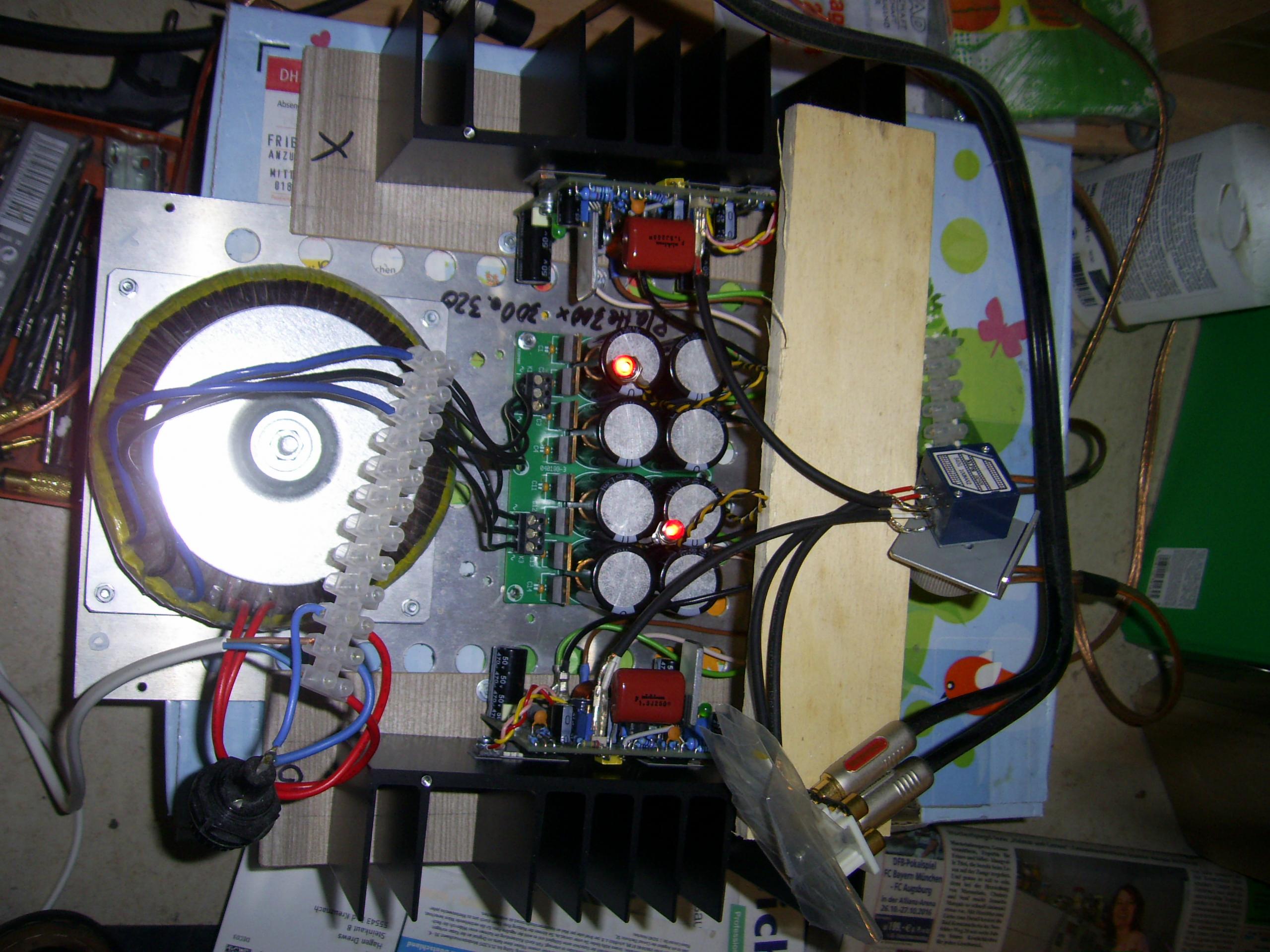

With Sanken 3263 i have build the W.d.Haan Nishiki Quasi Hybrid Amp, but
not fully wired now- pic. It has a 6N1P in srpp on input with ~320V Ub anode.
That one plays in same league for my opinion- have to finish wiring.
And than its time to create a new case for that Quasi animal. 🙂 and get a steady place.

Are you using the same input cap on the Fetzilla and Quasi ?
If not, can you run the Fetzilla and Quasi test using the same input cap ?
Edit:
I just noticed that you did say.. after several days listening with burn in the foil cap (same as in FetZilla) this amp plays very cool...."
Can you describe the 'difference' ( if any !) between the amplifiers 'with the same input cap' ?
Thanks.

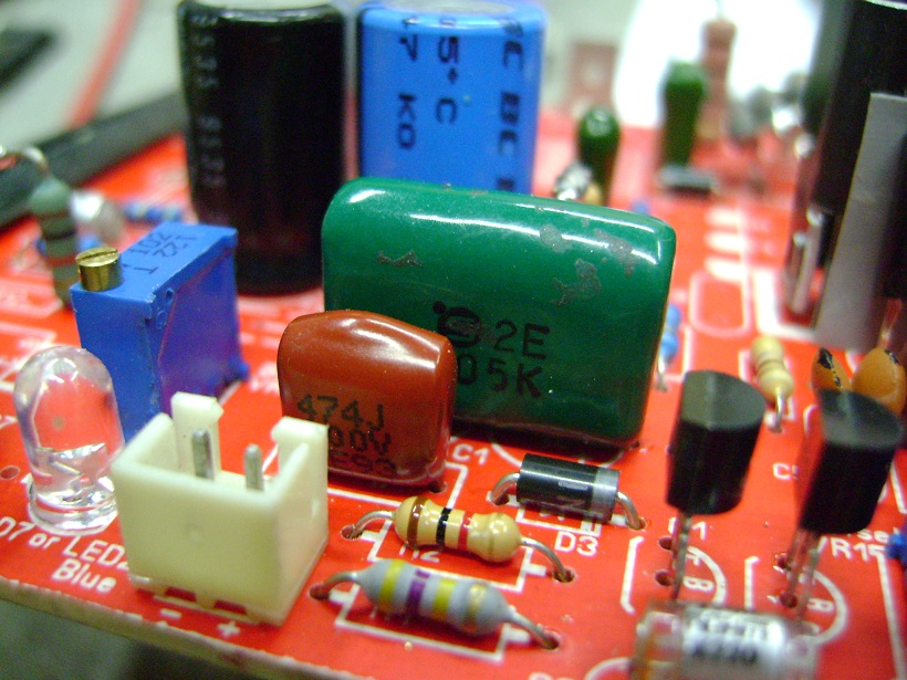

same QXP on Input
Hi guys.
Thanks for kind reply.
Ashok the only different is the paralleled 10n cap- on Quasi is an old FKC-polycarbonate (ZM used 1uF- there is borrowed idea).
The FKC i have tested on Apex FX8 with 10uF electrolytic with surprisingly
very good clean sound- my indicator is clapping hands- very precise, same on
Quasi.
Today i have better ears and registered again a very good 3D imaging of
Quasi and fluide musicality- one song plays very delicious :sax: :yummy:
The Fetzilla is there a bit different i would say- LatMos as OP, warm class AB
bias point and the refined PSU- CRC, what Ranchu has worked out with any
more members and well supported by Hugh. 😀
If there is more interess- MM has done a great offer to us- not many registered that- of course that one is a bit more expensive...... and so on...
I have add to QXP there the K40Y-9 PIO cap- same experiment done on Jasons VSSA (with long antennas cap legs- bad!!! 😕 😛 ) and a DME
10uF- works also great with any magic in sound- i like it.
I tough every one does it's own experience with caps and what he like. 😱
Another impressing thing is: if i switched off the Quasi it is slow discharging-
near a minute you can listen on speaker- like a tube amp- electrodes flowing.
Makes me little smile there- only nice. 🙂
Could it be because the VFet stays permanently ON?

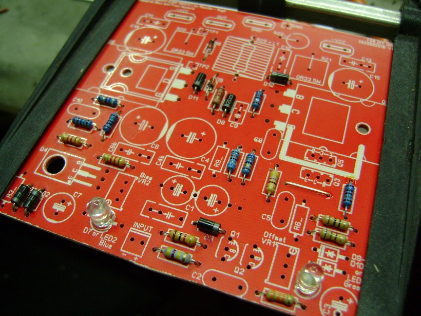

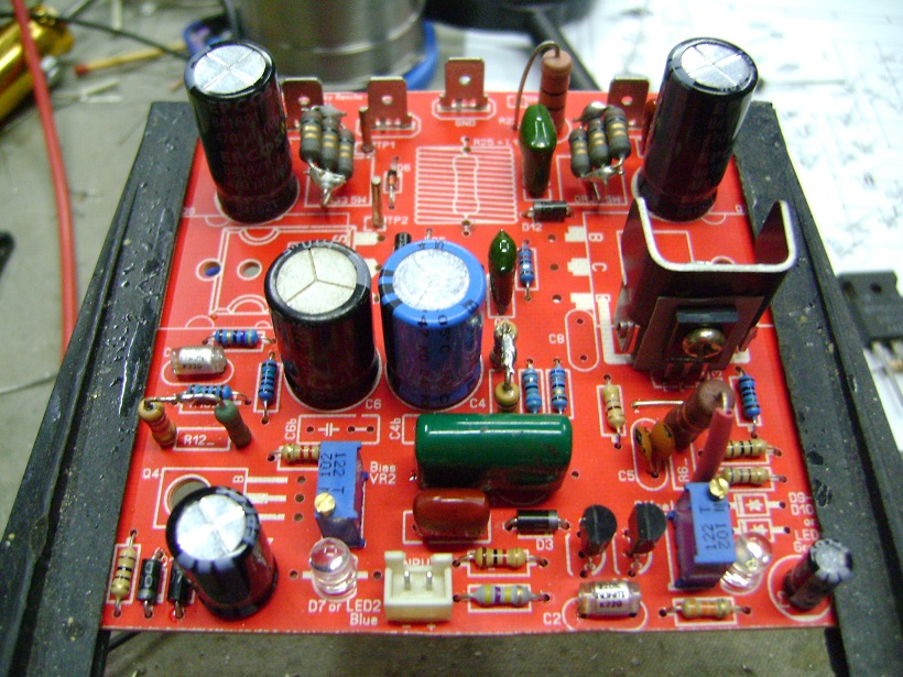

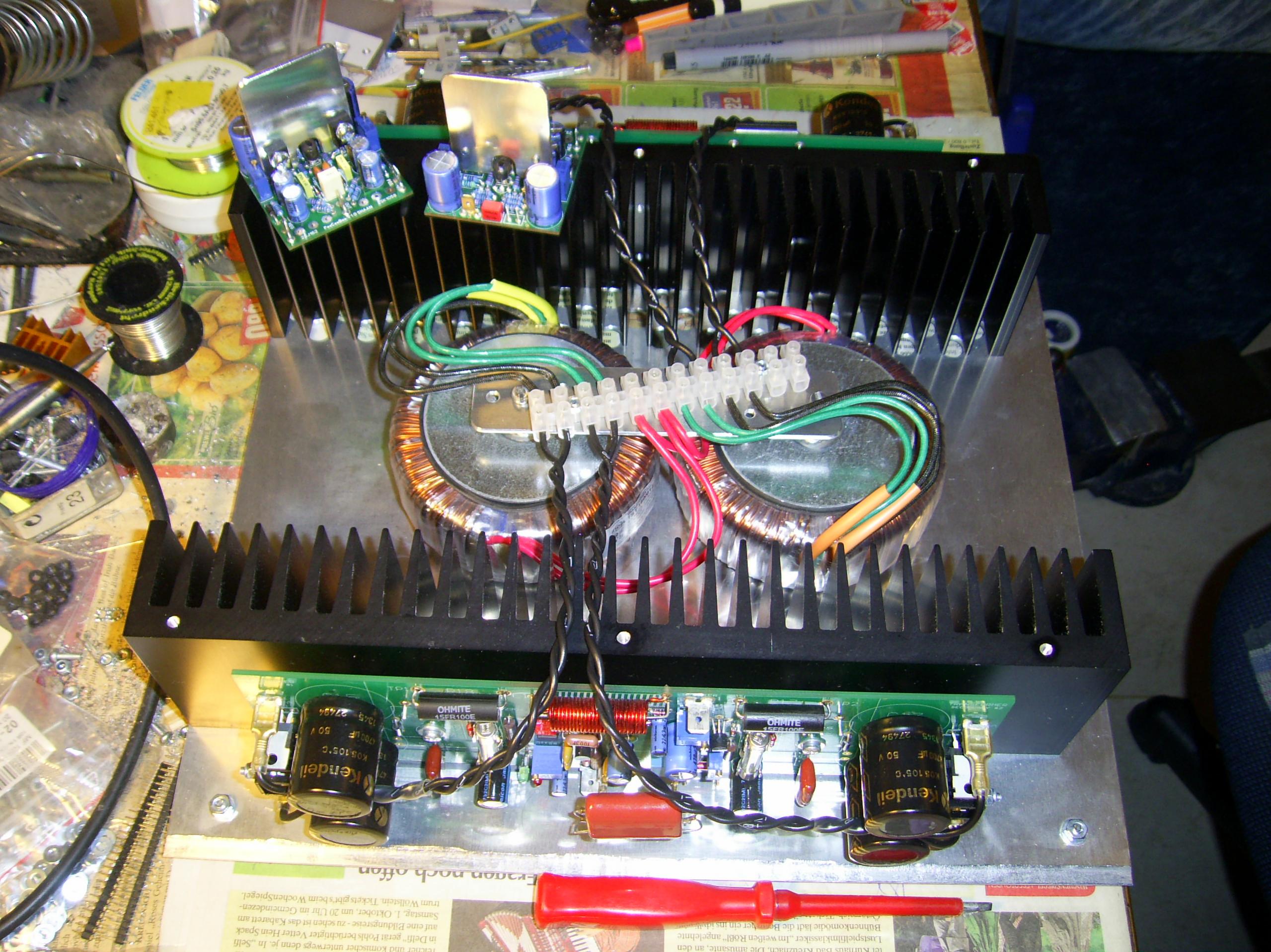

Some progress so far... 🙂

Nice work, Max. Seems to me the quasi has attracted some very good builders!
Is it your best sound yet?
The harmonic profile of this quasi is high at H2 and H4, which I have found give warmth and 'body', a sense of solidity, a bit like a strong tube amp.

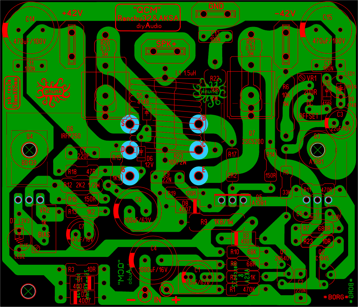

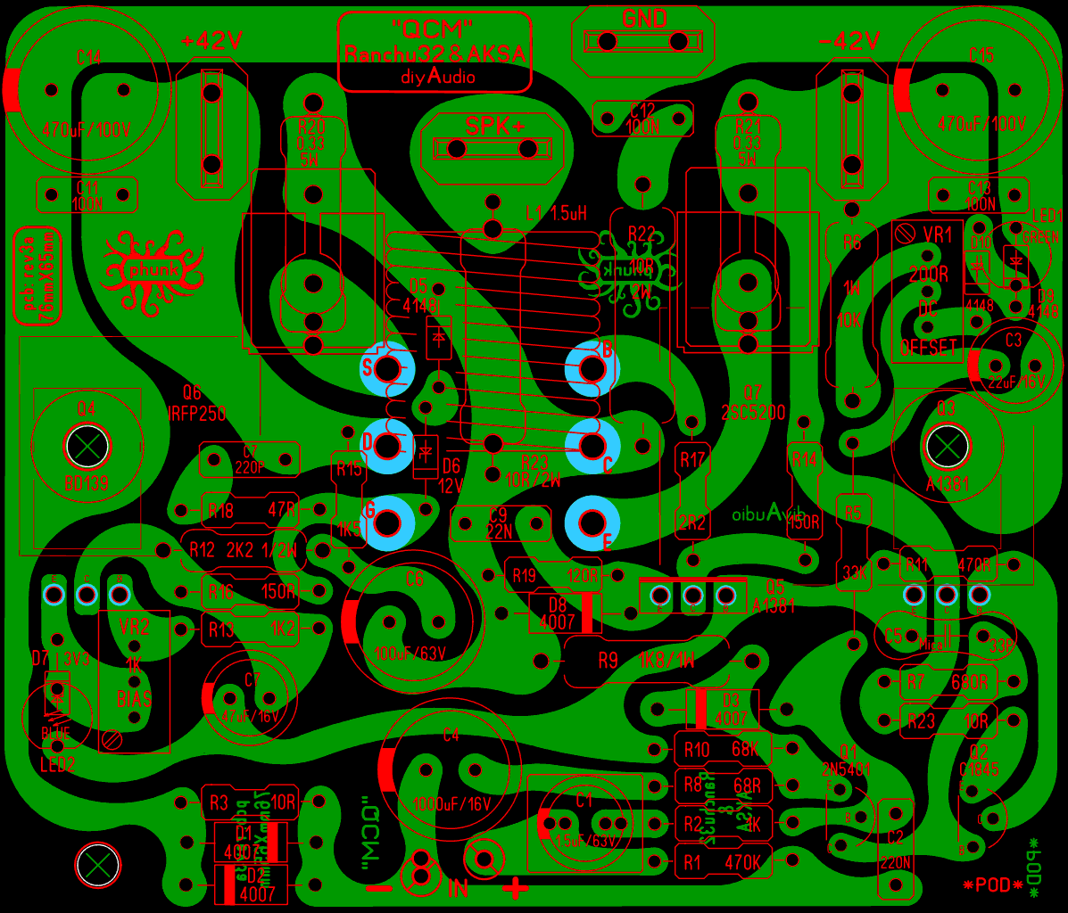

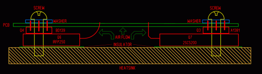

As promised

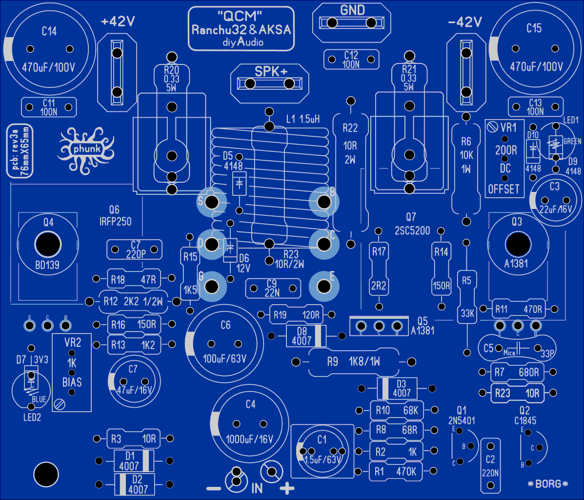

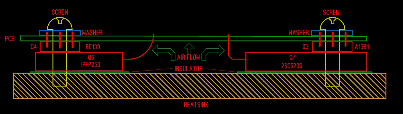

It seems a bit quiet here,so let get to more quasi.I`ve got a surprise and i think you will like it.The layout was promised last week and i`ve been trying to upload since last week Tuesday on my cellphone.Definitely a nightmare.
Without further ado,let`s get cracking.
First a thanks to everyone for the positve feedback.I`ve made a couple of changes which i think is for the better.
Let`s not drag this out and let the layout speak.
Regards
phunk
ps:There are gerbers,pdf`s and a Sprint lay file of each version in the zip files.

Nice! Organic looking paisley shaped tracks - very cool. 🙂
