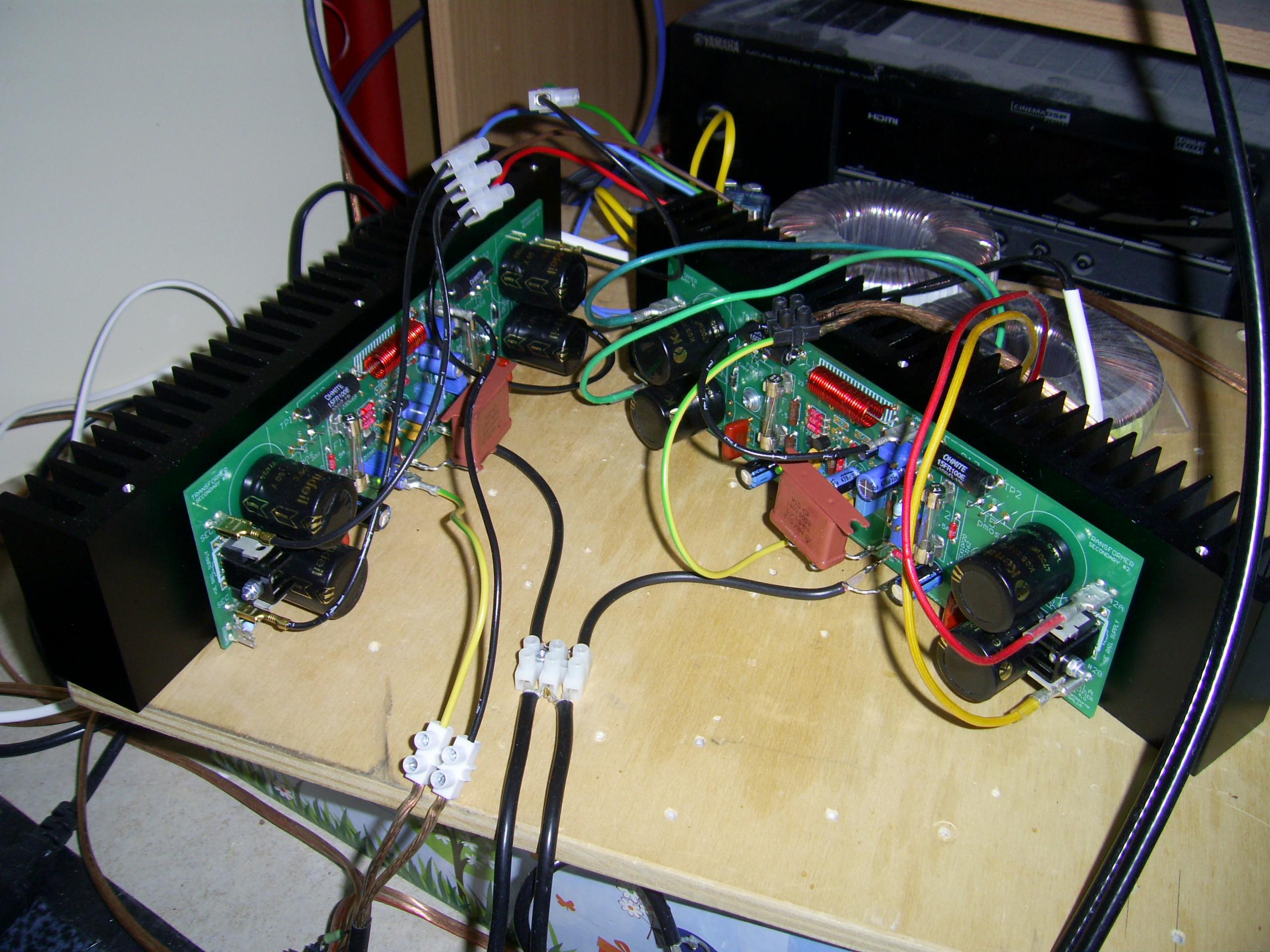

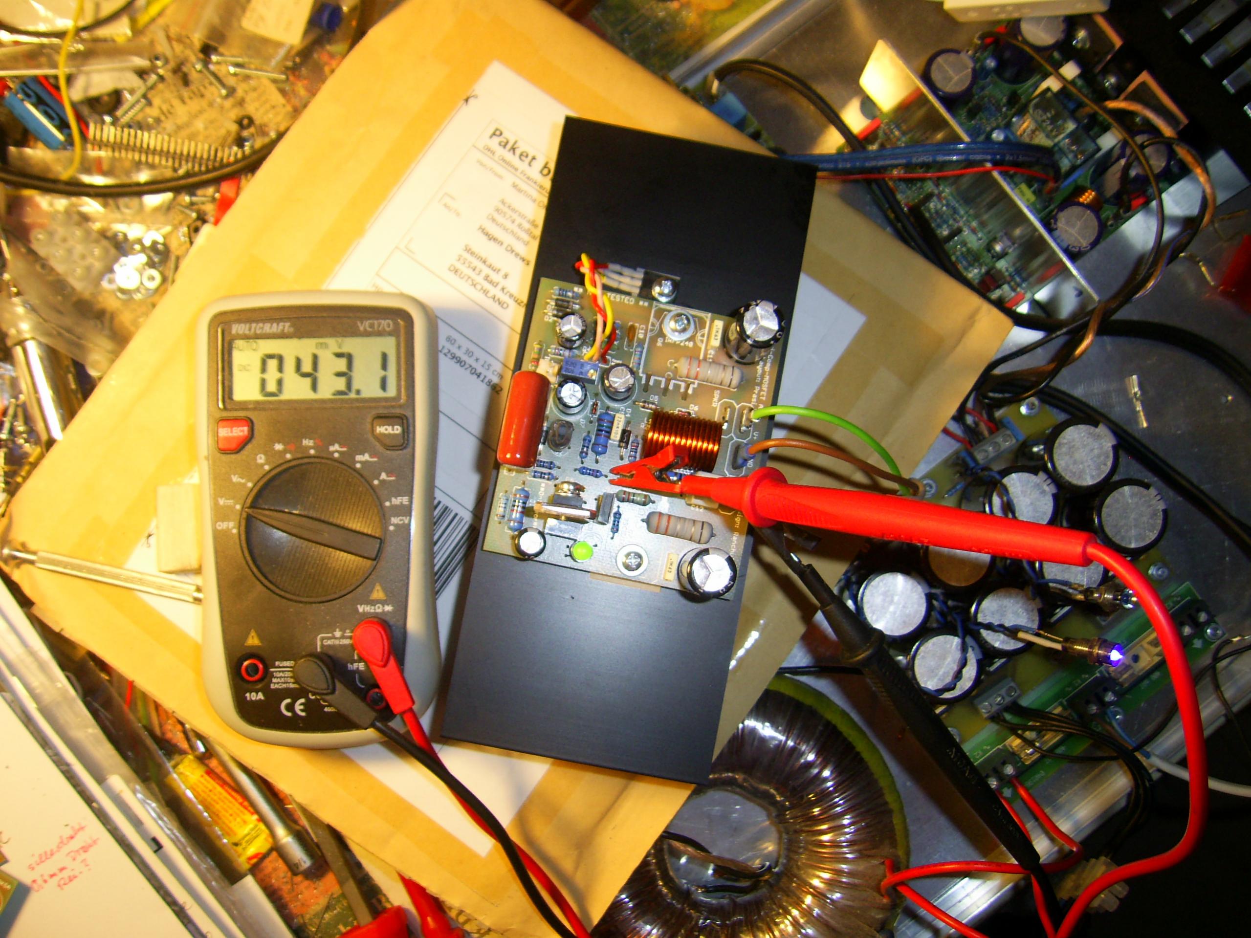

Hi Fellas.
Now i have finitely finished the boards paralleled to other projects.😉
First i could say: it does not zeroes the Offset with two red LED- 1,8V- to much
voltage left over ~1,7V with fully cw turned 500 Ohm trimmer.
I soldered in only one greenLED and it works fine than.
R5 is 100k; D7 is 3,3V; N-VFet is: FQA 19N20 Vgs ~4,6V; BJT is 2S3263 LATP Sanken.
Bias runs stable 39,4.....9mV and offset from 1....4mV.
Heat Sink is a Fischer SK53 75mm high- dissipate 0,75K/W.
Now its time to fix both channels for stereo listen test.

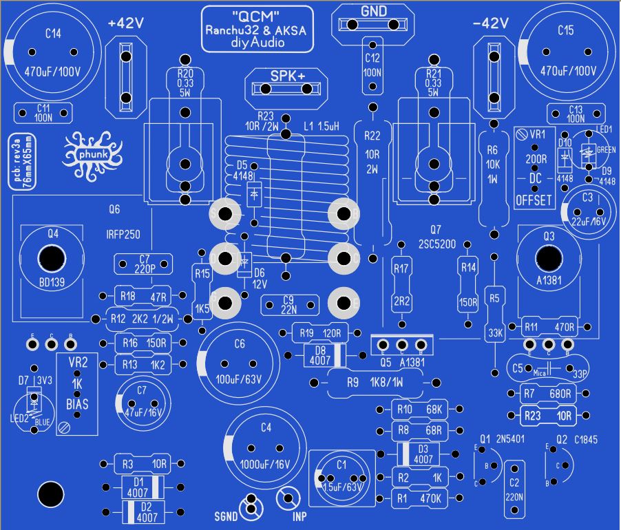

Here is PCB with final figures.
Tested and working.
Sprint attached file.
Regards
Thiago

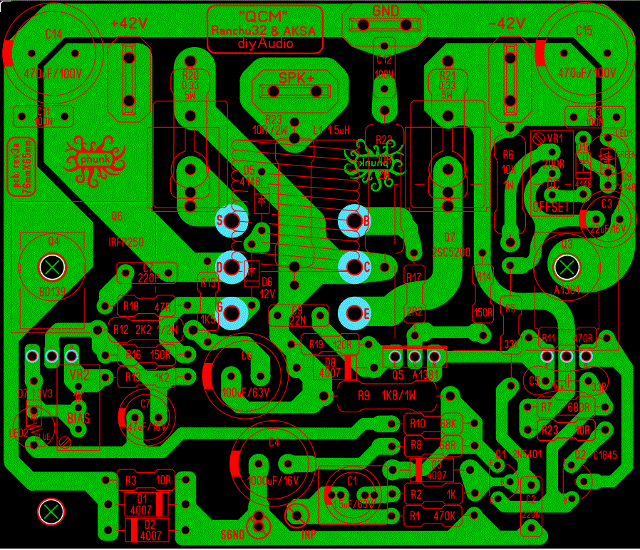

I have implemented the changes to the layout.
I have also made a couple of changes and have included the old layout in zip format as reference:-
1.D1,D2&R3 brought in line;
2.D5&D6 shifted to the front of the output mosfet contacts.Was a bit worried about the lead lenght of the outputs.Datasheet says +- 14,6mm.
3.Led1,Vr1,C3,R6,D9&D10 shifted around to get some clearance because of the 12mm dia caps instead of the 10mm dia caps that were previously there.Left C11&C13 where they were because the only space on top for C13 would have been very close to R21 which i did not like because of R21`s heat.
Let me know which options i should include in the final layout as i want to finalise & order pcb`s by the end of this month(surface mail takes+- 6 weeks,so will be good to go for the big days).

Forgot to mention the extra hole in the left hand corner.It`s for a strain relief clip for the input signal cable(cable tie for quick testing).
whats that green alien doing right at the output connector?.😀 see closely, two eyes and two holes for mouth and nose... niceRighto...

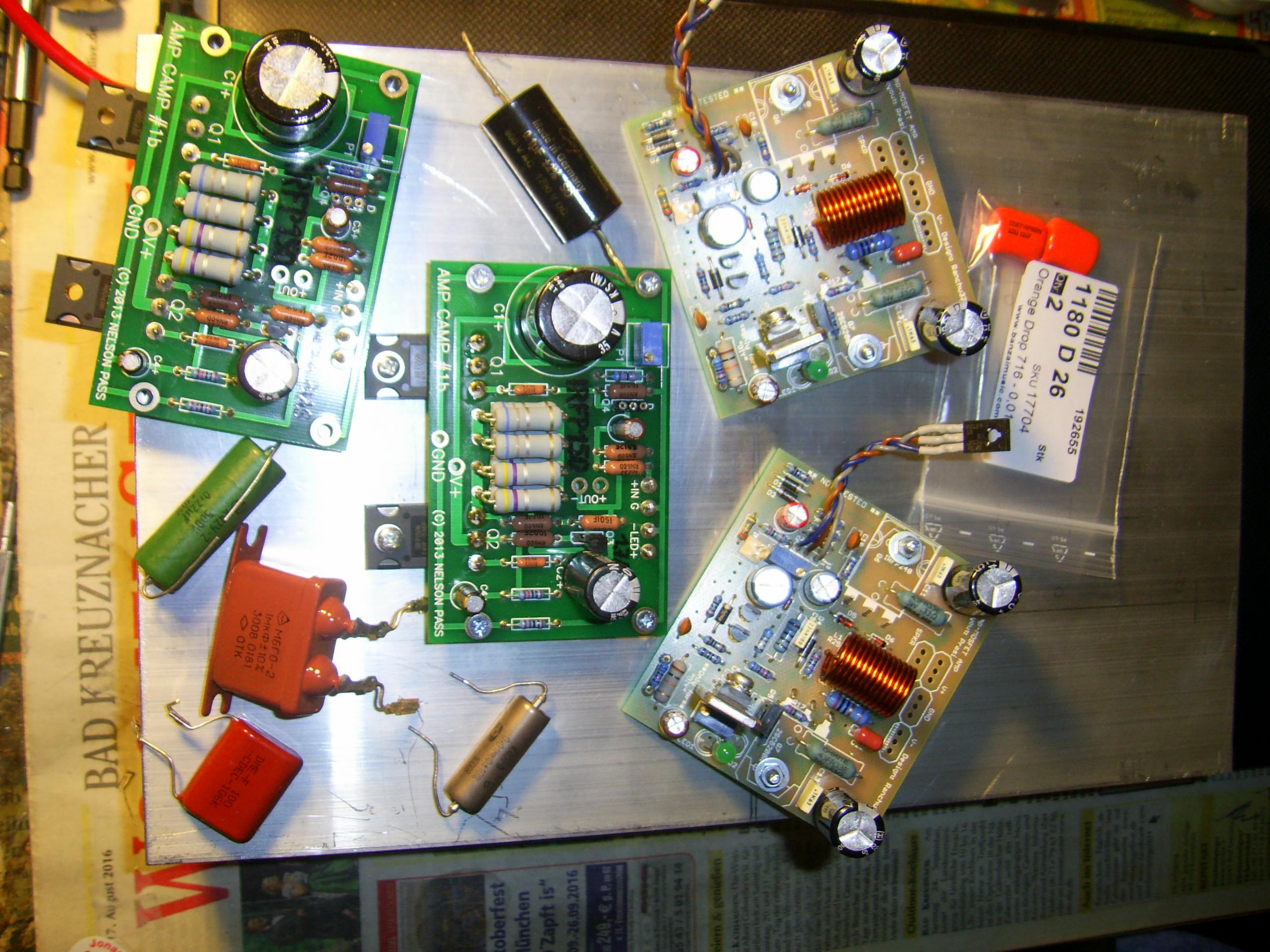

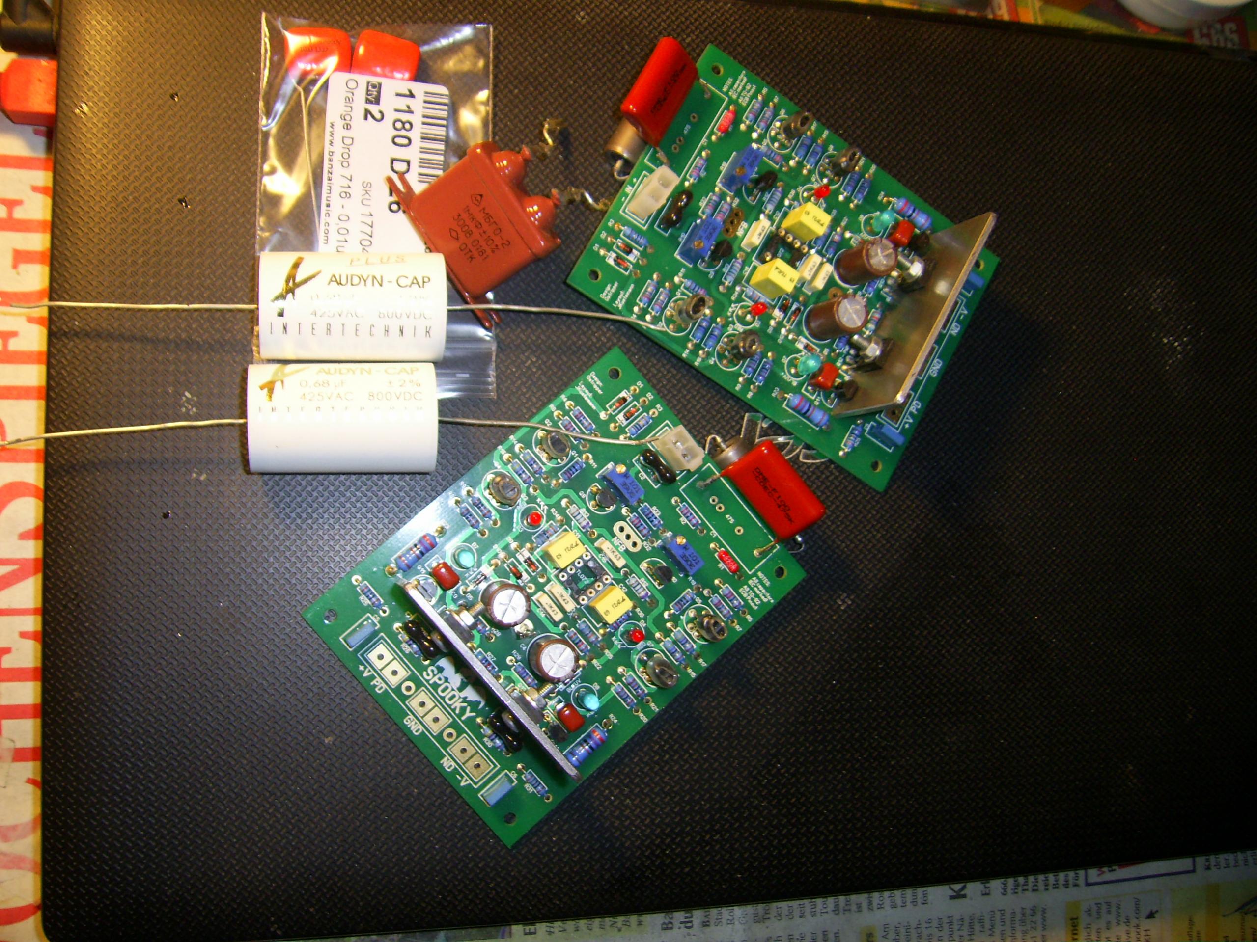

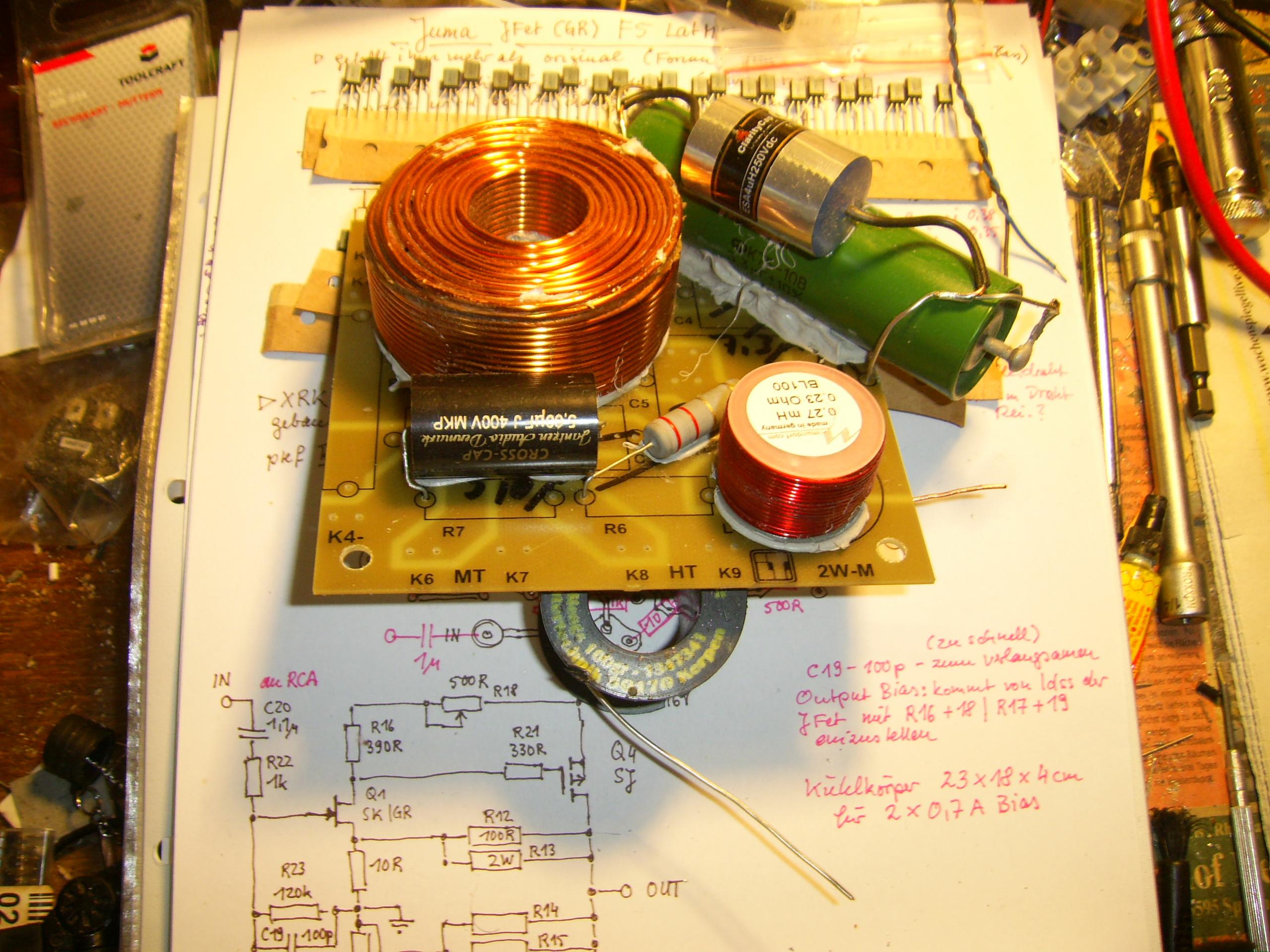

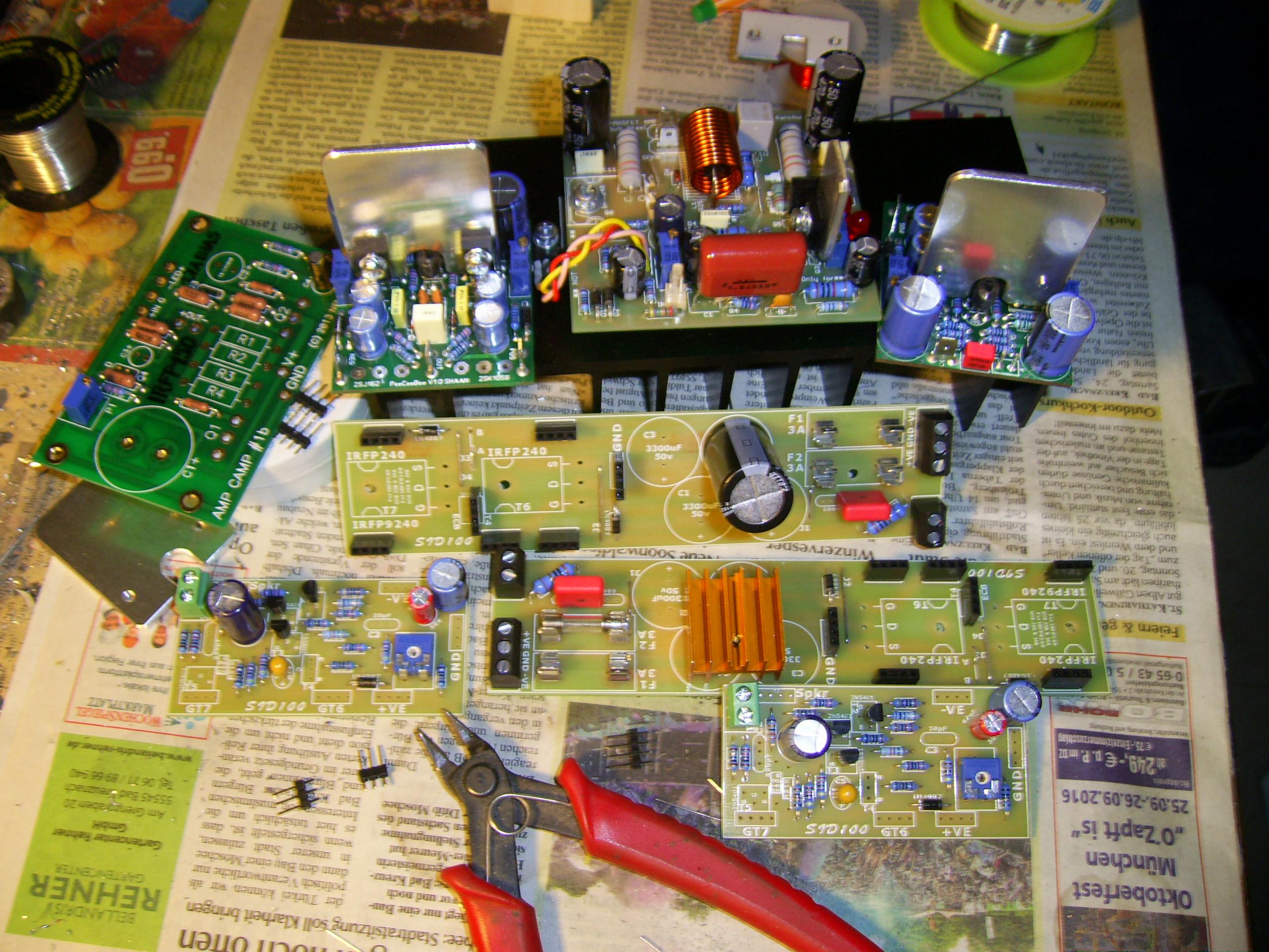

Hi Fellas.
Thank you Prasi for kind words about inductor- it's only handcrafted over a 10mm drill. 😛
Here are some speculation about my used input cup.
It is a Nichicon QXP- other named it Relcap. On Greg's DX Amp side i noticed it
first time and was searching some information.
Reliable Capacitor (RelCap,AudioCap,Multicap)PPFA,PPFX,PPFXS,RT,RTX,TFT
So i bought some 1uF from Mouser and tested it in FetZilla with excellent results- if you keep in mind: size/price/performance relation. 😀 😀
Than i also make tests with MBGCH- really a Favorit too and with MBGO- that is the one i prefer for long time listening- smooth and relaxed, but feels lost a bitin clear transparency to QXP.
Finally i have add a little 10n K40Y-9 PIO to QXP- and if i trust my ears i can live long time with that.
On VSSA/Spooky boards i use a combi with DME cap with very good result.
I send picture about my Favorit tested cap collection.
You can see on 2 way X over board a clarity ESA 4uF to a PIO 3,3uF/250V K75-10 hybrid cap, and believe or not- that is a awesome combi in use for
the tweeter in my unfinished project after long period testing.
Another Favorit in bypass is the Orange Drop P715/716- what i have tested
for decoupling in Tubeamp and on Circlophone.
One of my loved overall performance/price is the Audyn Plus- the white in picture, only 0,68uF/800V- a huge one.
I feel it is not thrown away money if you like to test yourself. 🙄
I am not so good in details to explain but i trust my lazy ears. 😎
