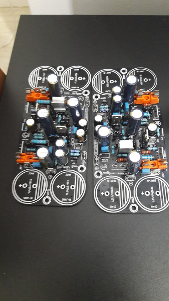

The quasi amps made it into my main system. I tried them on the midranges but not quite enough grunt to keep up. They are working great running the tweeters. Still some neatening up of the total set up required but I had enough work and wanted to sit back and listen.

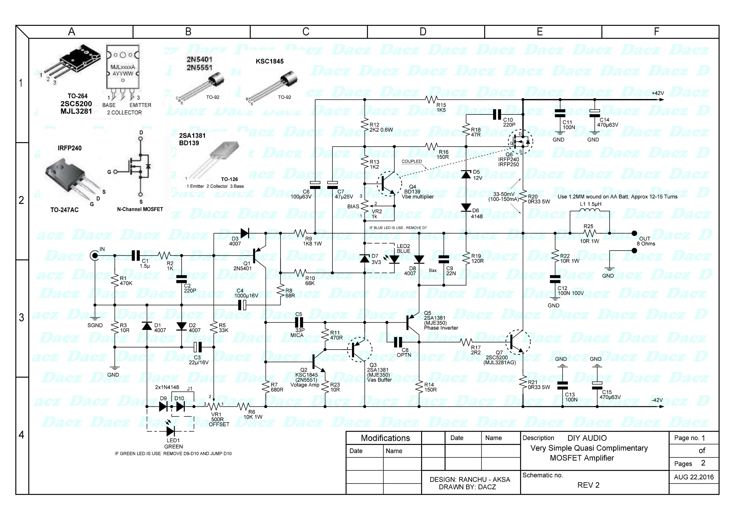

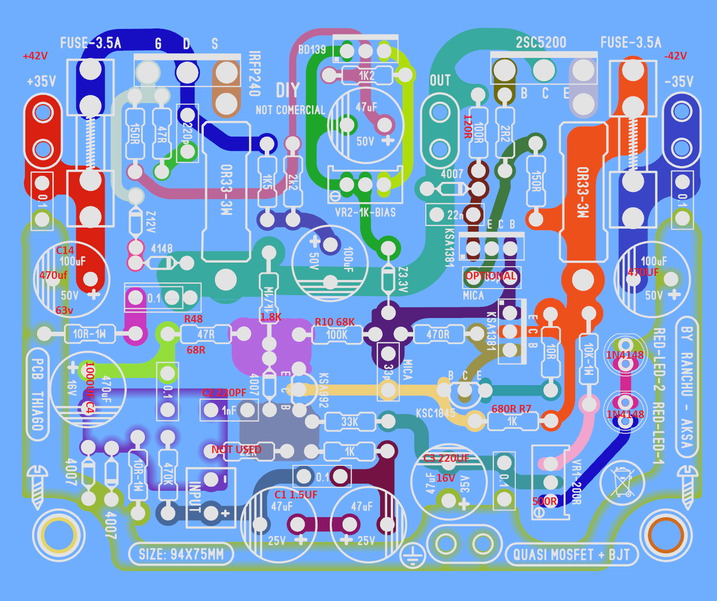

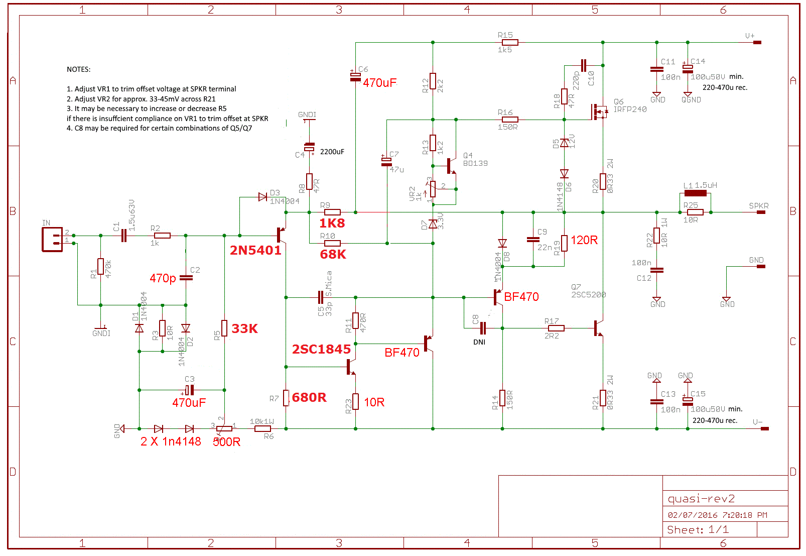

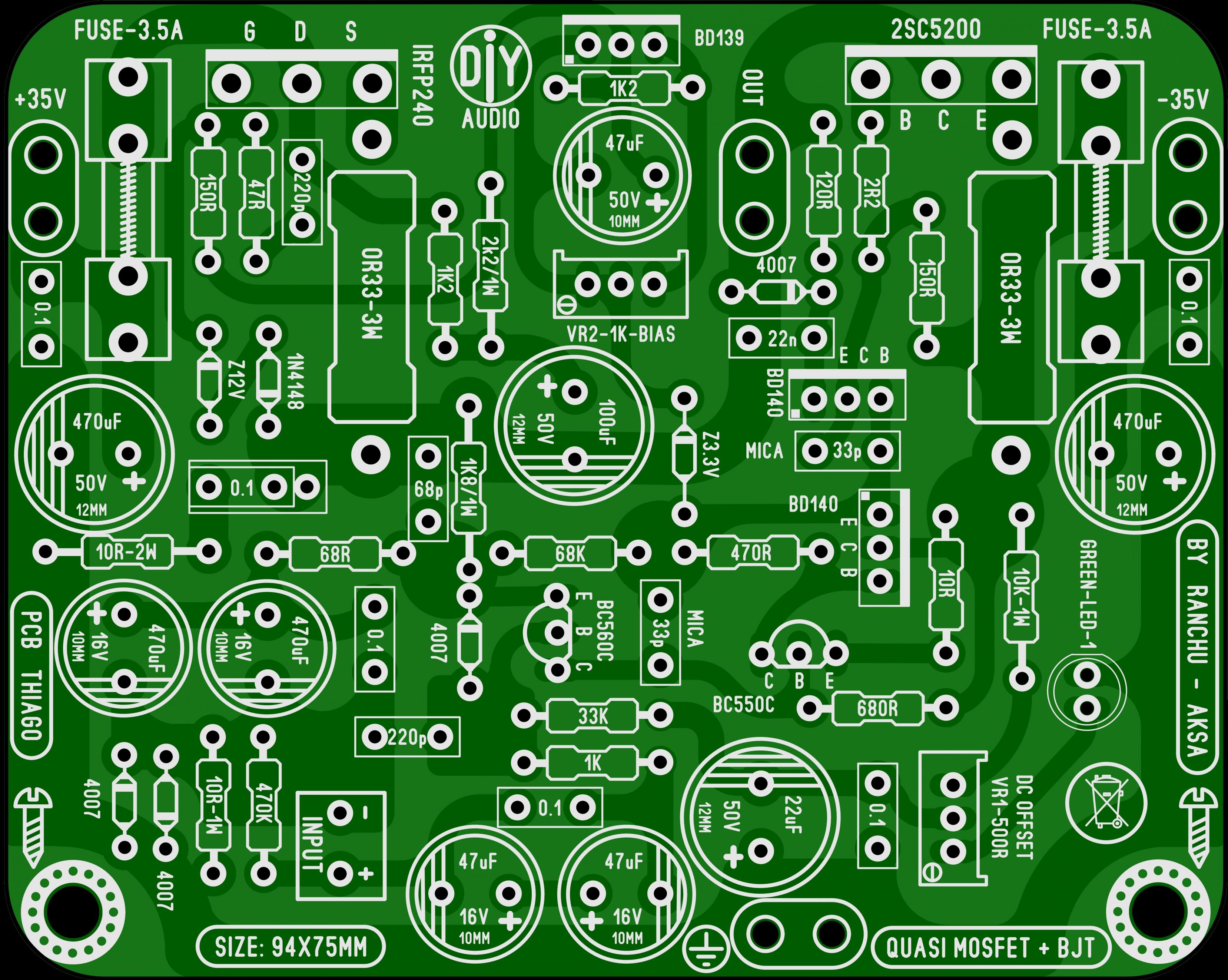

part values
In comparing schematic by DACZ ver2 (latest?)
it seems like I should use those values with Thango's board.
here are the changes I see:

Here is what I think is latest:
DACZ attachments were in 1354
AKSA said:I have redrawn Thiago's schematic with my suggested values for best sound. 988
I didn't mean to mislead. The quasi has great bass. Very full and rich. This was on a couple pair of "regular" passive crossed two way speakers. Both the shop set and a nice pair of ariels.
The midrange in the speakers shown is a beyma 12mi100 https://www.beyma.com/products/lowmidfrequency/112MI108
The horn tweeters came from CSS not shown on their site anymore. There are a pair of rear firing selenium tweeters for extra sparkle.
The 15" woofers are each driven by a 5 pair slewmaster +- 78 vol rails. a mini dsp 2x8 does the crossover.
I had been driving the midranges and tweeters with a 2 pair lat fet amp =+- 72 volt rails. http://www.diyaudio.com/forums/soli...erformance-yet-rather-simple-hybrid-more.html through a passive crossover. With the quasis in place I am running fully active...4 amp channels per side.
At +- 35 volt rails the quasi couldn't drive the midrange loud enough to keep up with the other parts of the system. It sounds great and only lost out at silly high volume.
I've got a stereo 5pr Slewmaster hooked up to Wolverine inputs and they are seriously powerful.
I should think that almost anything will have trouble keeping up with 78V Slewmasters at volumes that would cause those boards to break a sweat!!
Evan, I assume you adjusted the EQ to suit the different gain level of these amps?
