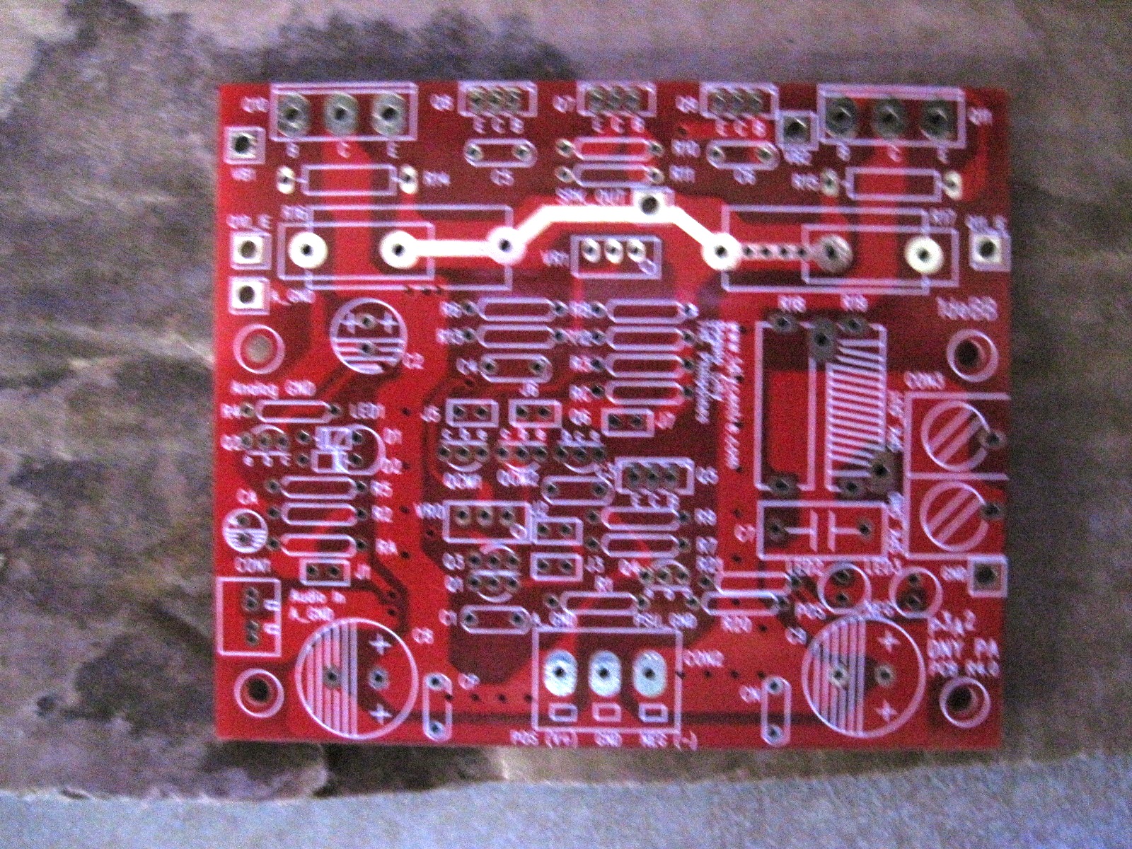

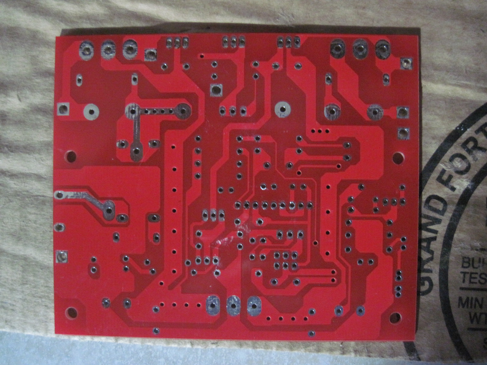

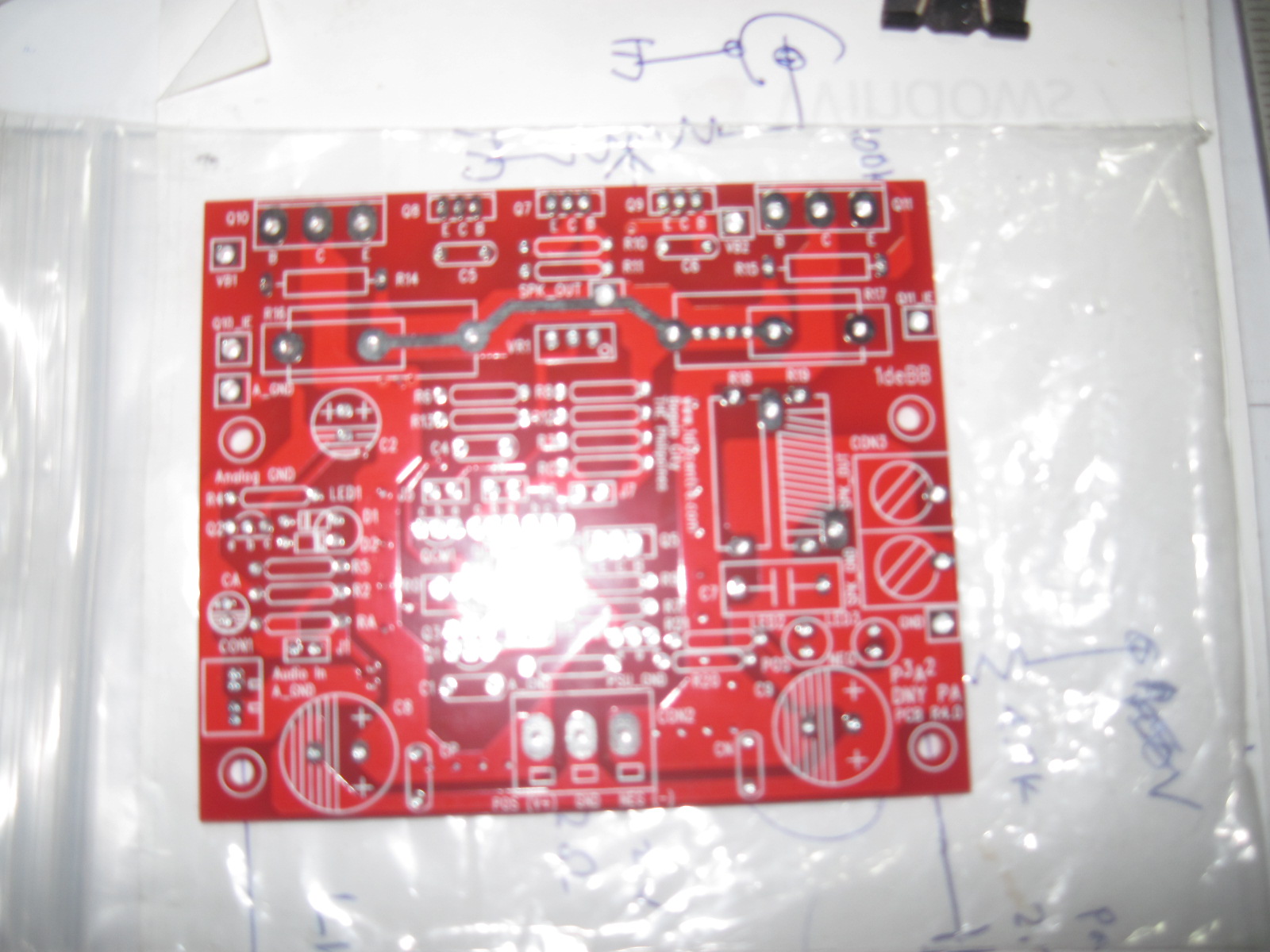

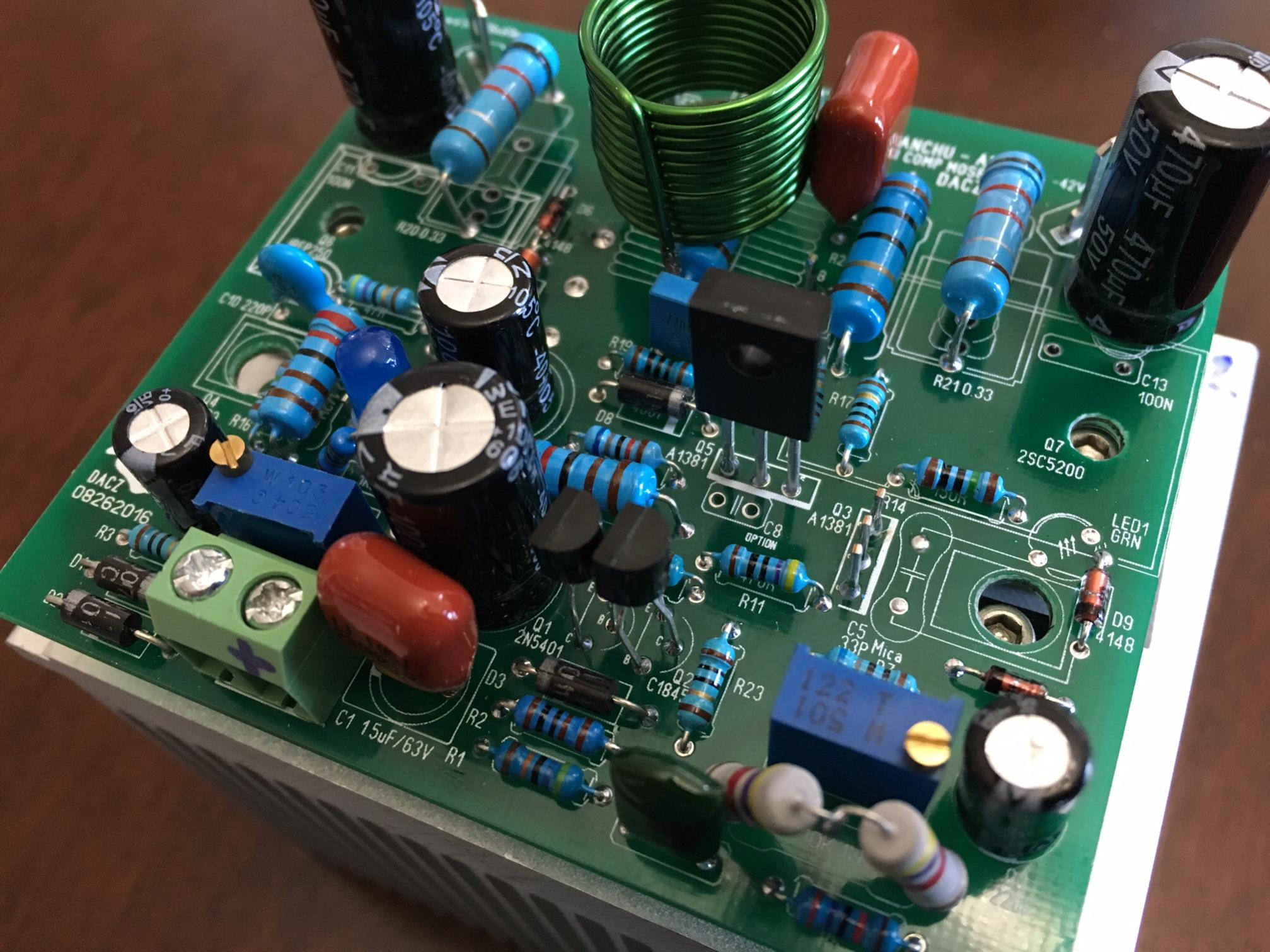

does anyone know why he left the solder mask off some of the traces?
What purpose does that serve?
this trick is done on many boards, mostly smps boards, i see no issues with doing that, you can if you like....
these are amplifier boards.....i think that some softwares do this automatically...
solder is applied to the traces to increase the current carrying ability of the main power traces. the layer of solder over the copper trace increases its thermal mass. by increasing the thermal mass, the traces heat up less and hot spots on the traces are reduced.

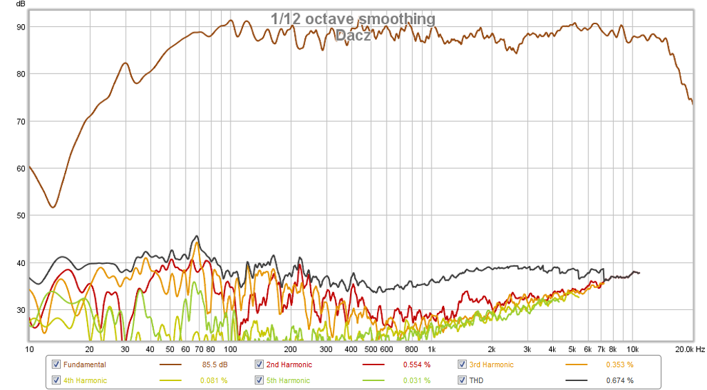

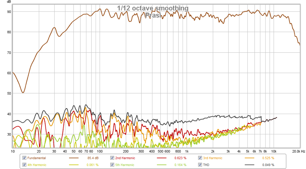

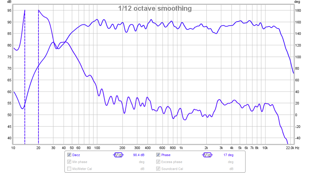

Now that I have put maybe 6 hours of listening on these new amps, I have to say they subjectively sound better than the last ones due to better quality components. I really like what I hear and the measurements bear this out. These are microphone measurements of the effect of the amp on a speaker (10F/RS225 FAST with transient perfect XO). There is lower measured harmonic distortion at the speaker in the bass response and at mids around 600Hz. The impulse/step response looks better with a more ideal step and less ringing. The measured phase also shows better linearity with a 15 deg difference at 6kHz. I listened before measuring so my subjective opinion was formed before seeing the data - it does sound a little better when listening to a lot of different tracks and genres. Now I labeled these amps Prasi and Dacz and that is not to say one layout is better than the other as my components were better on the Dacz and I think that makes a difference. I am using KSA1381 drivers/VAS vs MJE350's and using the Onsemi BJT vs the Toshiba 2SC5200. Also using film cap on C9 vs ceramic.

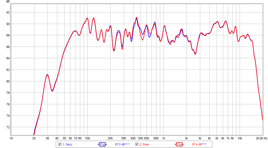

Here are the frequency measurements for both amps with same speaker/mic position and same PSU. Made within 15 minutes of each other (enough time to warm up and adjust for same bias). Measurements made at 50cm from speaker with third party calibrated UMIK-1, CS4398 DAC as the source. +/-36V power supply with 5mV ripple after CRCLC filter. The Dacz has a surprising small (+0.5dB) boost in the mid range from 400Hz to 800Hz. Otherwise they look pretty much identical:
Here is the measured harmonic distortion on the Prasi (cursor at 50Hz):
Here is the measured harmonic distortion on the Dacz, you can see that it is just a bit lower at 60Hz and somewhat lower in other sections (cursor at 50Hz):

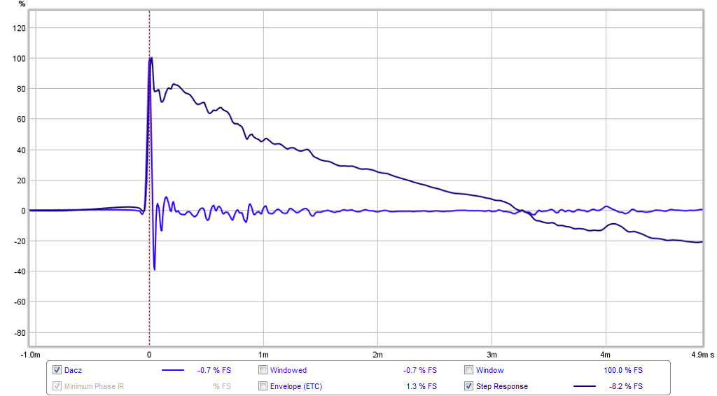

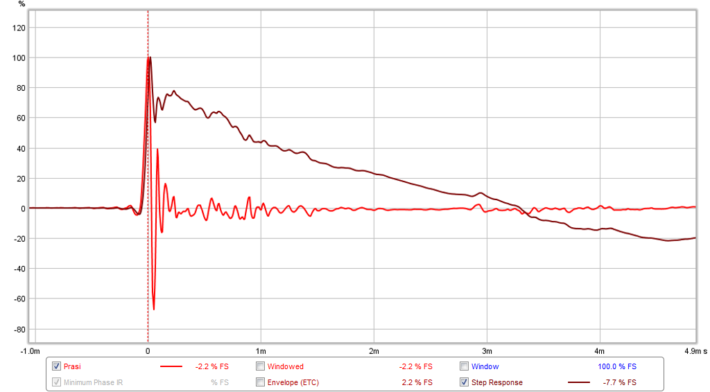

Here is the measured impulse and step response of the Prasi - a small amount of ringing or overshoot in the impulse:
Here is the measured impulse and step response of the Dacz - a cleaner performance for sure and will sound more realistic with percussion:

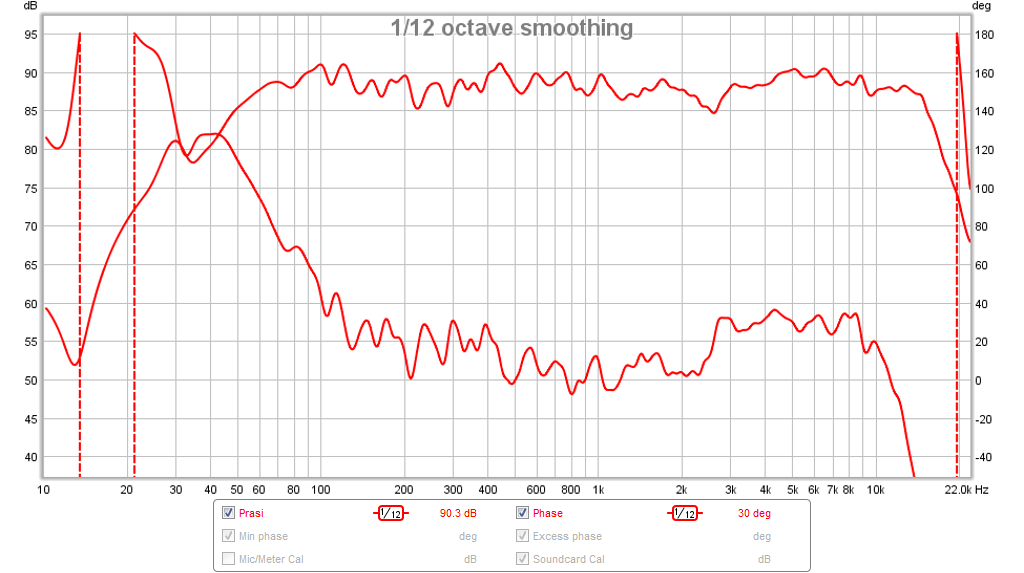

Here is the measured phase response for the Prasi:
Here is the measured phase response for the Dacz - flatter in the higher treble range (3kHz to 15kHz):

hi xrk971.. nice through hole.. did you update the pads in sprint before sending to pcbway? if i could remember only Q3, Q4, Q6 and Q7 have through hole pads for easy soldering when fixed under the pcb. if the price is negligible, then it is a go for all through hole. nice and neat looking 😉

Thanks, Dacz - I agree, they turned out rather nicely thanks to a great layout! A pretty amp to look at and beautiful to listen to. I used the older Gerbers without the drilled holes for the Q's - and it was me who discovered that the holes were missing - so too late to use revised Gerbers. It wasn't hard to drill my own so not a big deal.
Hello xrk971Since there is already a 0.33R source/collector resistor in place, I doubt you need thicker traces to reduce the ohmic drop across that 1in travel of copper trace. The resistive drop there is much smaller than 0.33R.
2oz copper PCBs (under 100mm Sq) cost substantially more (more than 2x) than 1oz. If you are building for home use and fun and trying to keep costs down - doesn't make sense. If you expect a lot of reworking, it makes repairs easier from standpoint of durability from pad peel off. But with good design making pads bigger around parts that need exchangingos often enough. Transistors for example should have bigger oversized pads.
For pcb 10cm x 10cm (1oz) manufacturer that provides exactly the same price as PCBWay but it seems to 2oz tracks the price is much cheaper.

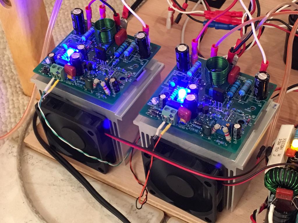

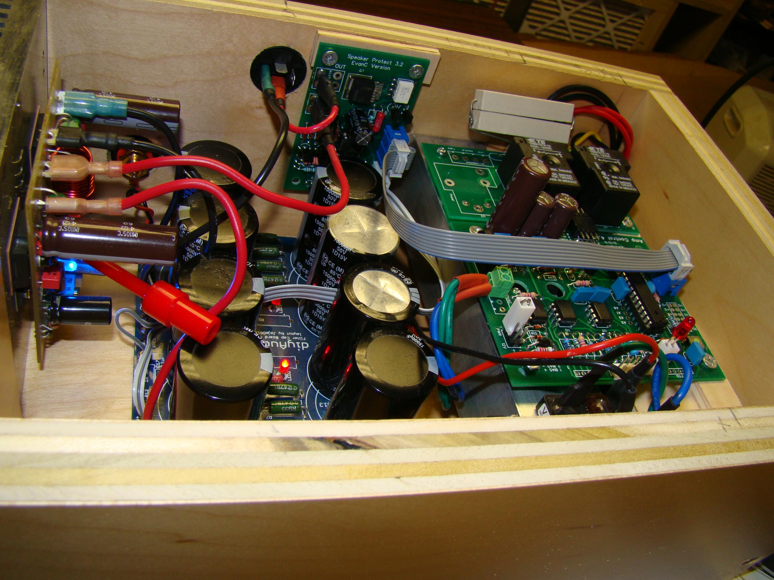

Got one boxed up for real. Putting the case and ancillary parts together takes longer then building the amp. Soft start and speaker protection is the 21st century protection set. Works great. Tomorrow the second should be done and we can have a listen on the big system.
