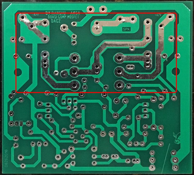

Hello everyone.
I need a little clarification.
In the photo of pcb DACZ, framed in red is a double track?
I'm made of double-sided pcb double for two runs, same thing?
Thank you.
No, it's a single track with green solder mask applied and left middle of track exposed.
thank you for that clarification! 🙂No, it's a single track with green solder mask applied and left middle of track exposed.
does anyone know why he left the solder mask off some of the traces?No, it's a single track with green solder mask applied and left middle of track exposed.
What purpose does that serve?

I have to agree with Andrew here. If the copper trace is wide and/or thick enough to carry the needed current, adding solder on top does not help at all since lead or tin is a far worst conductor than copper. Better have the proper trace in the first place.
Do
Not paying the extra thickness to the boardhouse, and still having augmented thickness trace where You feel it is needed?
I guess you could always solder a copper wire on top but I don't know how good this would be in the end. I checked and making those PCBs in 2oz copper is about 3.50$ /PCB which ain't bad at all but if 1oz copper is sufficient because the traces width make up for it then it is money wasted. Unfortunately not too many of us can really measure this, at least not me. And maybe at low to moderate sound levels it is a no brainer anyways.

Since there is already a 0.33R source/collector resistor in place, I doubt you need thicker traces to reduce the ohmic drop across that 1in travel of copper trace. The resistive drop there is much smaller than 0.33R.
2oz copper PCBs (under 100mm Sq) cost substantially more (more than 2x) than 1oz. If you are building for home use and fun and trying to keep costs down - doesn't make sense. If you expect a lot of reworking, it makes repairs easier from standpoint of durability from pad peel off. But with good design making pads bigger around parts that need exchangingos often enough. Transistors for example should have bigger oversized pads.

do you have any idea what purpose the missing solder resist serves?
I did not design the layout but have seen numerous times, Destroyer X (Carlos), goop on (add many layers) maybe 3mm thick extra solder on the traces - I assume to increase current capability? It comes in handy when you solder the large parts as the solder trace really heats up due to thermal conductivity of a large trace and I fear the resist would just thermally degrade and burn up. Hence better to leave off so it doesn't look like a charred mess.

interesting topic. my question would be what harm does it (leaving the solder mask off) do for the power and spk out traces?
No I think but it's less beautiful! 😀interesting topic. my question would be what harm does it (leaving the solder mask off) do for the power and spk out traces?
I don't think it does a lot of good where prolonged high current is expected as the solder will begin to melt, but certainly for protection against a surge it has some merit. It does no harm. From one who does mostly home etched boards, I don't find it unsightly. 😀
