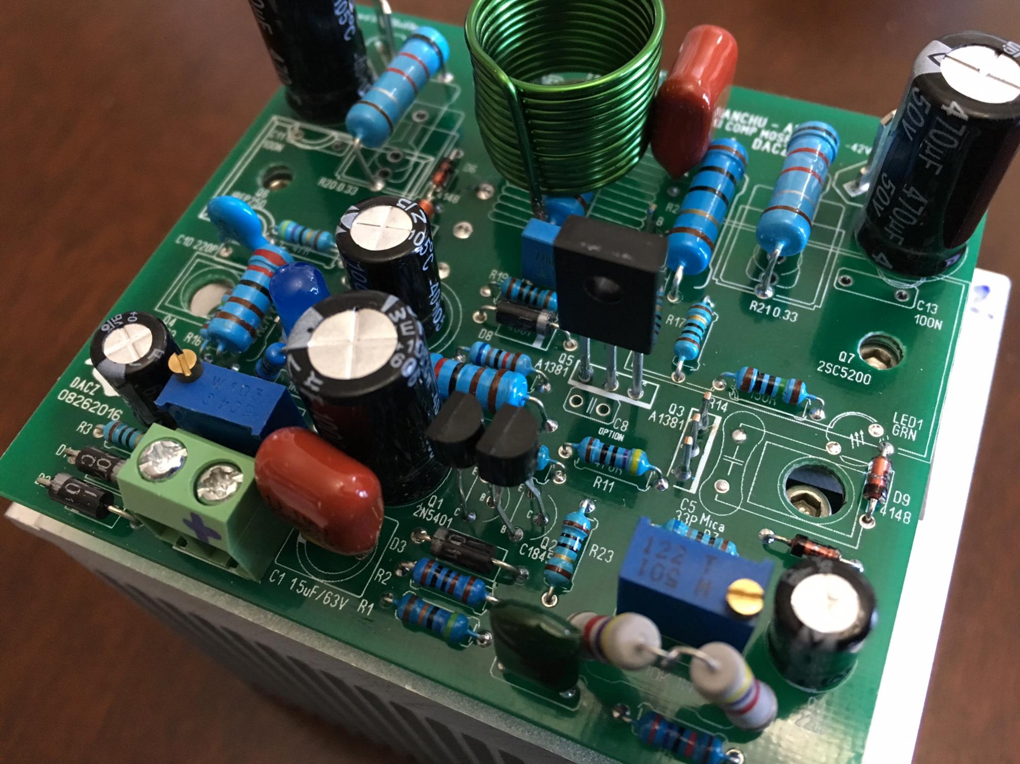

What is the used mosfet?Almost done with new Dacz board. I made a few minor substitutions like 0.22R source/collector resistors and used SMT 100nF bypass caps on underside. Also 22pF NP0 SMT instead of 30pF mica. Using NJW output rather than 2SC5200. Still needs the output inductor to be rolled. It's a nice board and easily soldered with enough clearance in most places. Am I going to run into any issues with a 500R trimpot for setting offset vs spec'd 200R?
They are labeled IRFP240 and appear to have tinned legs vs satin legs. I cracked one apart (blown from thermal runaway on a different amp) and the die appears to be good. Large square centered and not covered with white RTV silicone like most fakes. Also compared to a die on a genuine Vishay and looks similar. Performance on several amps is good and sounds great.

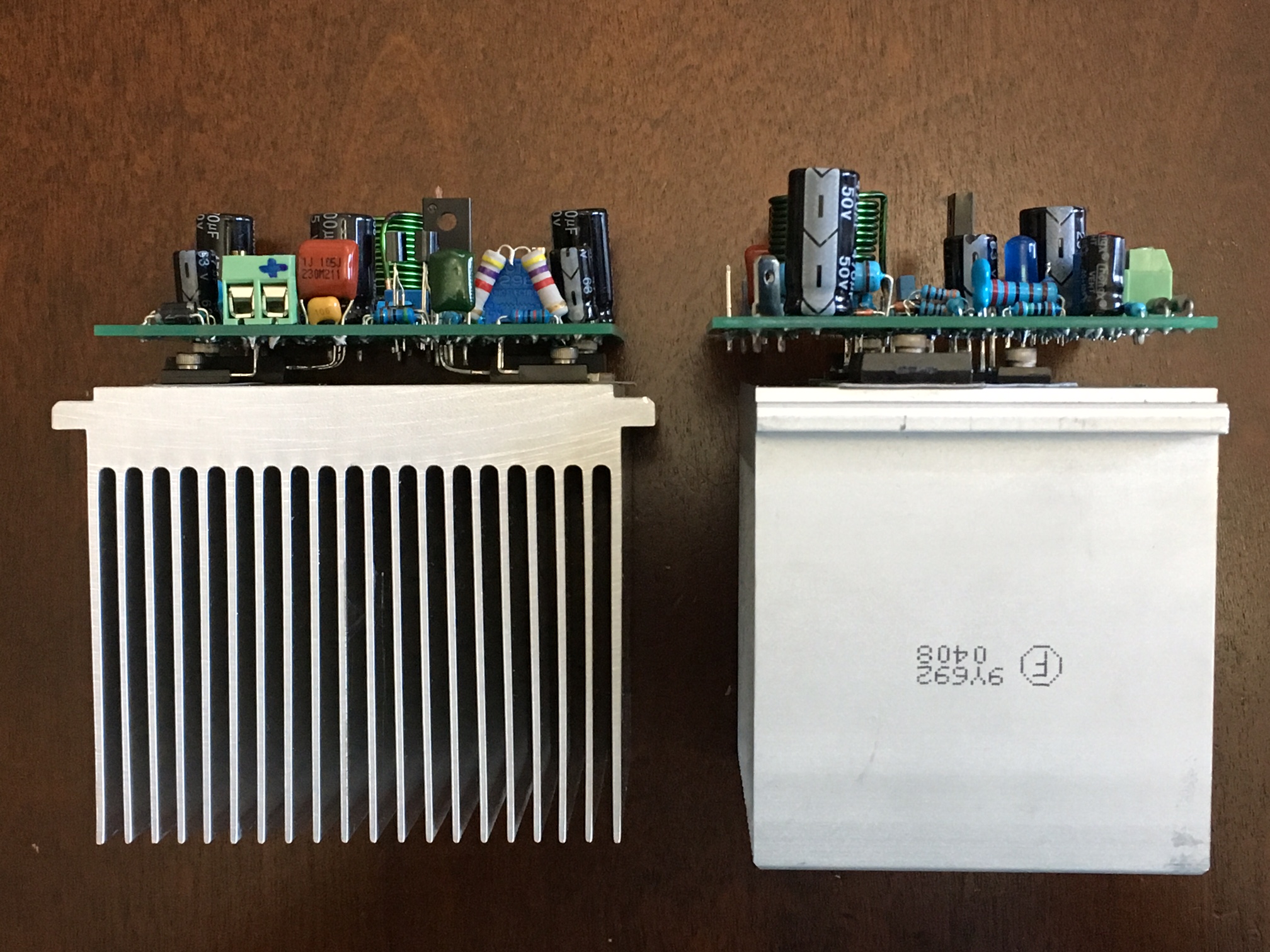

Sideview
This might be useful for those who are building this. Since the BD139 is mounted on heatsink, I left space between outputs and board for good cooling. Used a BD139 as a thickness gauge. The Allen head socket cap screws are held captive between PCB and output devices.

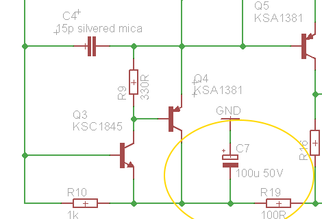

Hi guys
This discussion about the negative rail had me thinking, because I could have sworn that on my prototype I had a simple RC filter on the IP stage to improve the situation.
I looked back into my files for "CSH2" (my original codename for this project) and sure enough it is there... The boards I had manufactured a couple years ago were based off this schematic, and even though I've had to butcher these boards a little along the way to keep up with the changes, that RC filter on the -ve rail has been there the whole time!
So I'm not sure when that filter was dropped from the schematic and why (I can hardly keep track of this thread either!) but I'll do some listening tests over the next few days to find out whether it sounds better with or without - all this time I have been listening to it *with* that RC filter.

I'd tried this some years back and found, on balance, that it was better to have the VAS directly referenced to the negative rail when driving complementary outputs. In this situation, with the phase inverter referenced to the quasi npn, it follows that all three stages should all be equally referenced to the negative rail. If you have a decoupler between the inverter/quasi and the VAS the hum and noise would be delivered to the inverter from the VAS output. The amplified noise on the negative rail should NOT be decoupled from the output stage and the best way around this is to delete the decoupler.
OTOH, the positive rail is already decoupled by the bootstrap; and the input singleton transistor is referenced to the input base, which is decoupled to ground. The output node, at the emitter, should be very quiet because it's a nfb node and it's source is the speaker, which is probably the quietest node on the amp.

Hi X,
I take a liberty to explain what Hugh meant with regards to R10 🙂
R10 provides a bit of a local (nested) feedback from the VAS buffer to the mail feedbzck junction point.
Unsolder and lift one side of it and have a listen with no R10 in place.
Then solder it back and have a listen again.
Do you notice some difference? What option is better (with no R10 or with R10 in place)?
Valery

X,
Valery nailed it. Raise on end of R10 and the amp will be operating entirely in global feedback, with minimal THD. Connect up R10 and the global feedback will be reduced to 68/1.8 = 37.8 = 31.54dB. This obviously increased the THD, BUT, it does change the profile of the THD, increasing the H2-H5, and there is another effect you might find that most people would not notice at all.
BTW, to be fair, 'intuitive' logic is as often incorrect, so it's very careful to be absolutely sure of this. I explain the words nicely; the concept might not be so wonderful! A lot of dubious concepts are beautifully described with 'perceived' logic.......
