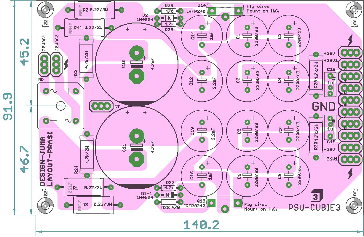

Hi All
Having built the amps I need to start work on the power supply. Has someone designed a single sided etchable PCB that I could build?
I have 8x 6800uf caps that can be used with a leg pitch of 10mm
Many thanks
Richard

try the Apex thread. Mr. Mile has many psu's, even regulated ones using 2SA/2SC TO-264 transistors. http://www.diyaudio.com/forums/solid-state/173462-studio-reference-amplifier-5.html#post2314736Hi All

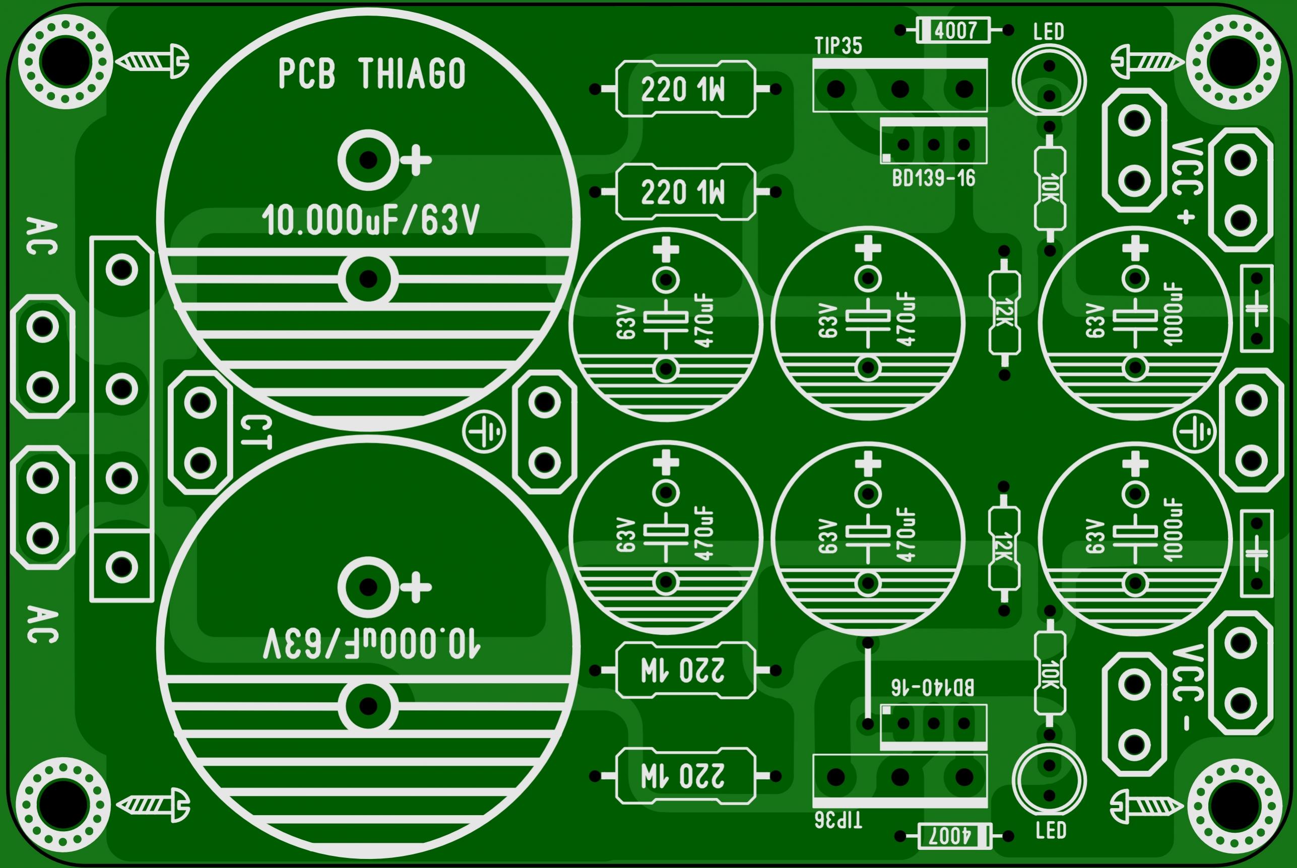

Easy to P2P a PSU. Or try this
http://www.diyaudio.com/forums/solid-state/297921-jumas-easy-peasy-capacitance-multiplier.html
Multiplier Capacitance
Multiplier capacity based on Elliott's article.
Maybe it was useful here?
Thiago
Thiago
if you tell me the dia of caps, i could make a simple bulk cap psu for you. like x said psu are simple to make even p-2-p. also let me know the kind of rectifier you have.Hi All

To, Tripmaster, there also a juma CM using mosfet, that i made for Cubie3. attached
The ESP sch shows the second stage 470uF connected to the common zero volts point between the regulators.Multiplier capacity based on Elliott's article.
Thiago
It is better to take the interference that comes through these capacitors to the zero volts line BEFORE connecting to the "clean" zero volts line.

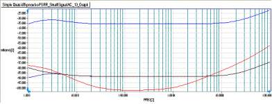

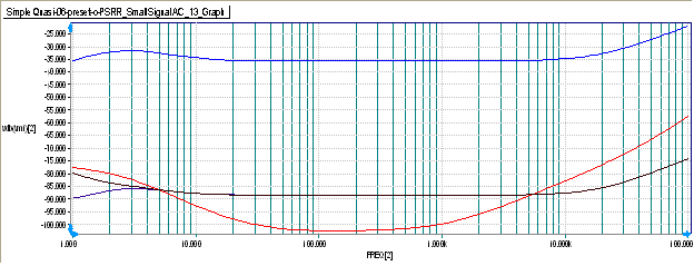

The Simple Quasi benefits with a cap multiplier on it's negative rail between the VAS and the output stage. You need only a single small signal transistor , resistor and capacitor.The PSRR on the positive rail is very good as it is. The PSRR on the negative rail on the stock circuit is relatively much poorer. With a cap multiplier it improves very significantly. Not quite sure how audible this might be. I have not built the circuit yet though I have all the parts.
On the graph, the top blue curve is the original negative rail PSRR. The next black curve is the PSRR on the negative rail with a cap multiplier and the red curve below that is the positive rail PSRR of the original circuit.
