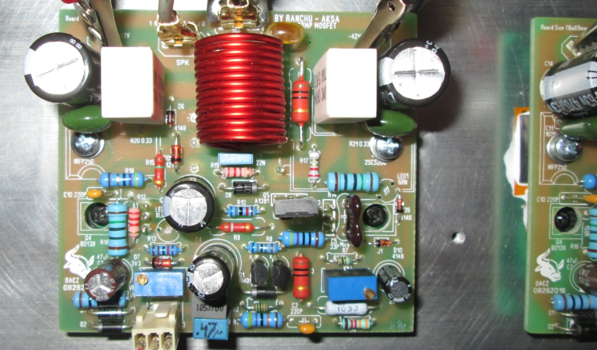

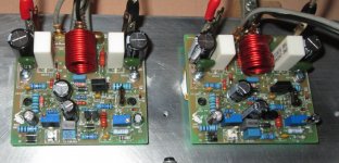

I have finally completed assembly of a pair of DACZ layout boards. These were made from the files in post 1354 and turned out very nice from board manufacturer FirstPCB. Thank you to AKSA, Ranchu32 and many others for this design and the sharing of your expertise. Thank you to DACZ for a nice, compact layout and the files to have them manufactured.
These boards were built mostly to the schematic posted by DACZ, with a few substitutions. Q1 is KSA992 with the C and B leads switched. Output transistors are IRFP240 and NJW3281G. Resistors are mostly what I had on-hand and some are larger size than needed. Diodes were used rather than the LED options. The power supply for testing is +- 35V, regulated with LM338 ICs.
The amps sound really good. I know this design has a small amount of even order distortion but I really can't tell, it sounds clear to me. When the music is paused, it is dead silent, even with no enclosure and a gaggle of wires. I'm enjoying these very much.

Very nice work, DT73, and a lovely pcb layout from DACZ.
What do you think of the sound quality? Is it warm, and easy to listen?

These amps sound great. Imaging is excellent, good bass and pleasantly dynamic for a relatively low power amp. I'm impressed with the low noise level and think I had a preconceived thought that it would not be this clean.
I'm still undecided on the final usage of these amps. It will either be a small stereo integrated amp in a vertical enclosure, like a small computer tower, or "active" type single amps with power supply installed inside speaker enclosures.
