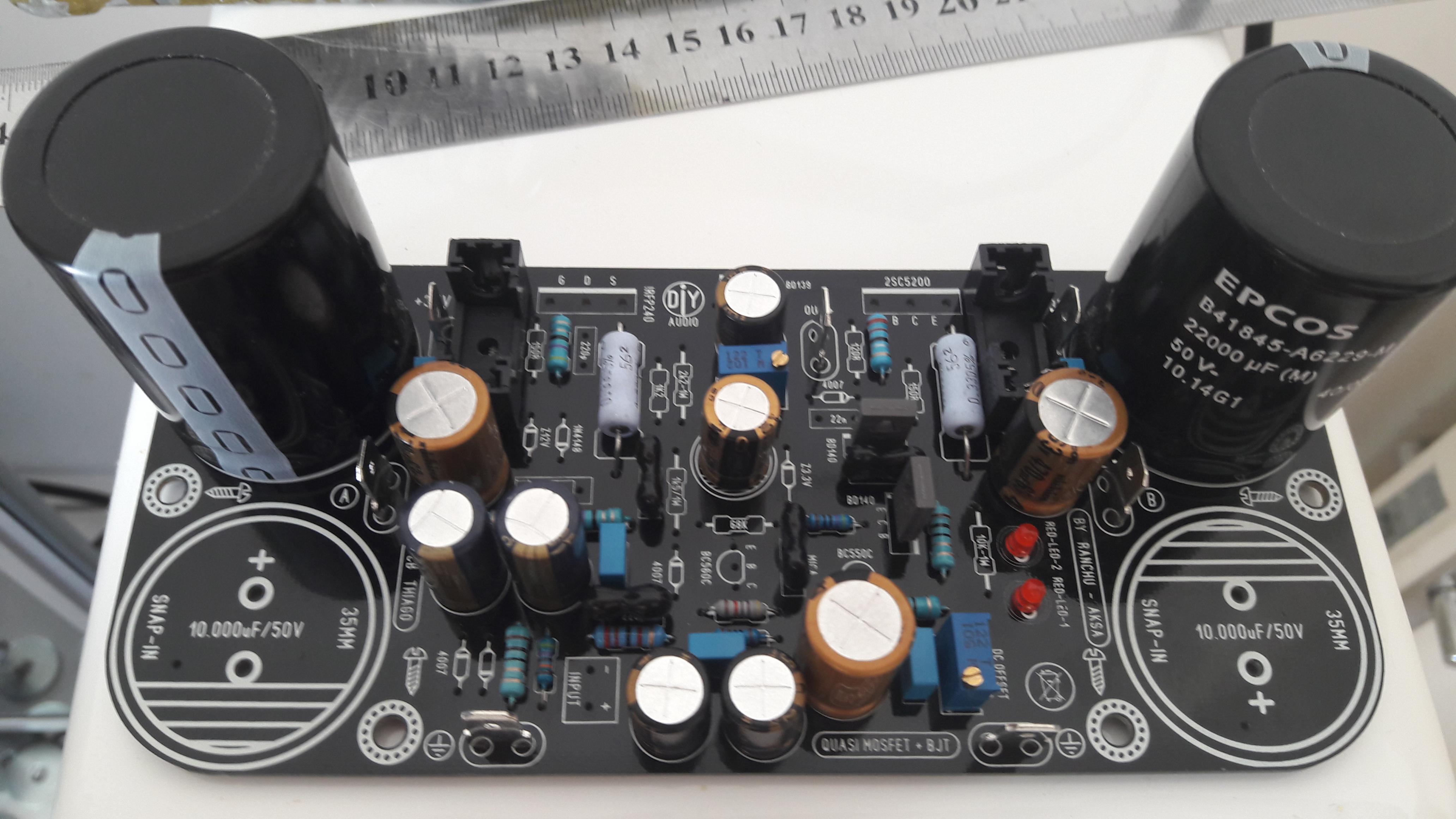

It's in work, not functionally working yet. But I have high hopes that Thiamongi's build will have better luck than me.
Is Thiago in progress?
Yes, his progress photo from earlier post:
Nice looking amp

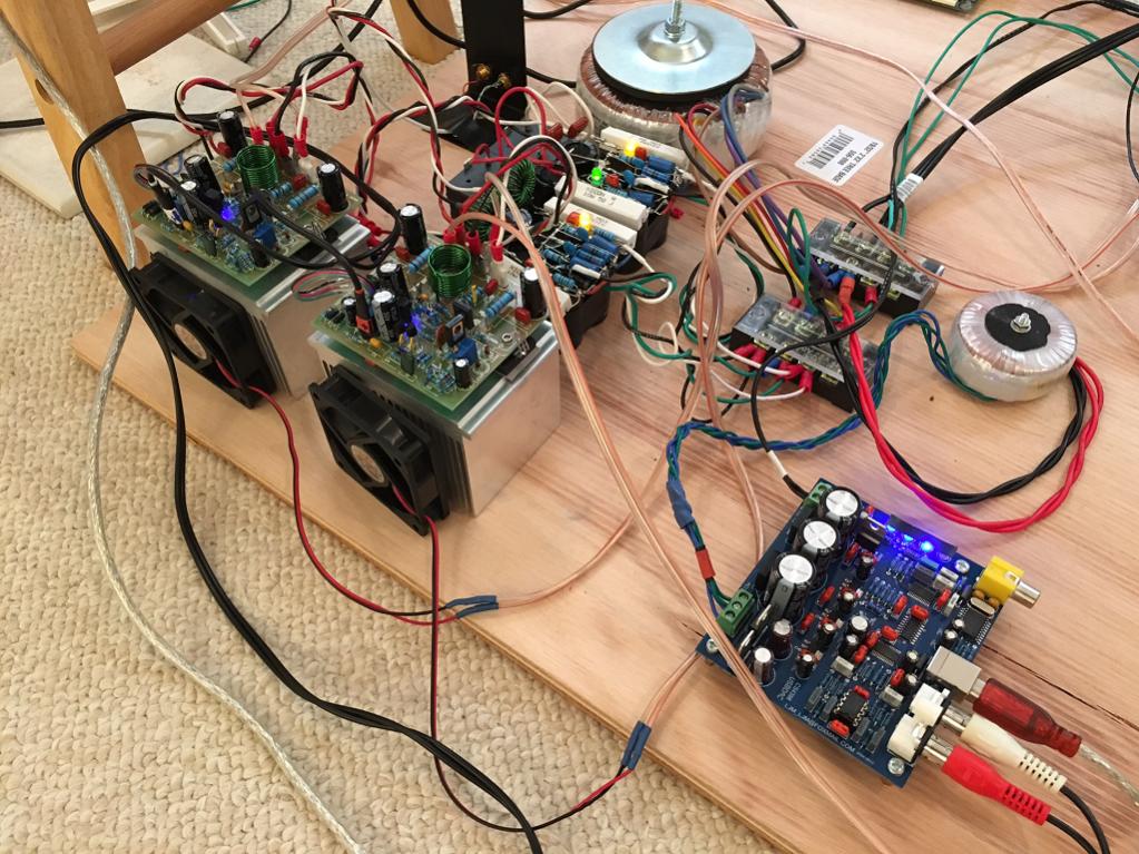

In Stereo, Finally

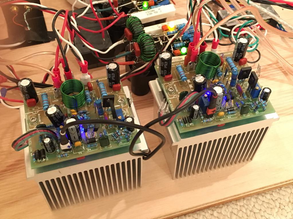

I now have managed to fix both channels. Both use 2N5401/2N5501 and MJE350. DC offset is stable within 10mV over hours of playing music. Sounds very nice - a nice sweet glass-like mids presentation with very substantial deep bass. Highs are very clear and non fatiguing, easy to listen to for extended periods.
I am running 100mA bias current and dual CRCLC PSU's with 250VA 25AC toroidal transformer for 35v rails.
Currently listening with my transient perfect ScanSpeak 10F/8424 and RS225-8 FAST two-ways. Very nice sound - surprisingly good clear bass.
Setup with power supplies visible:

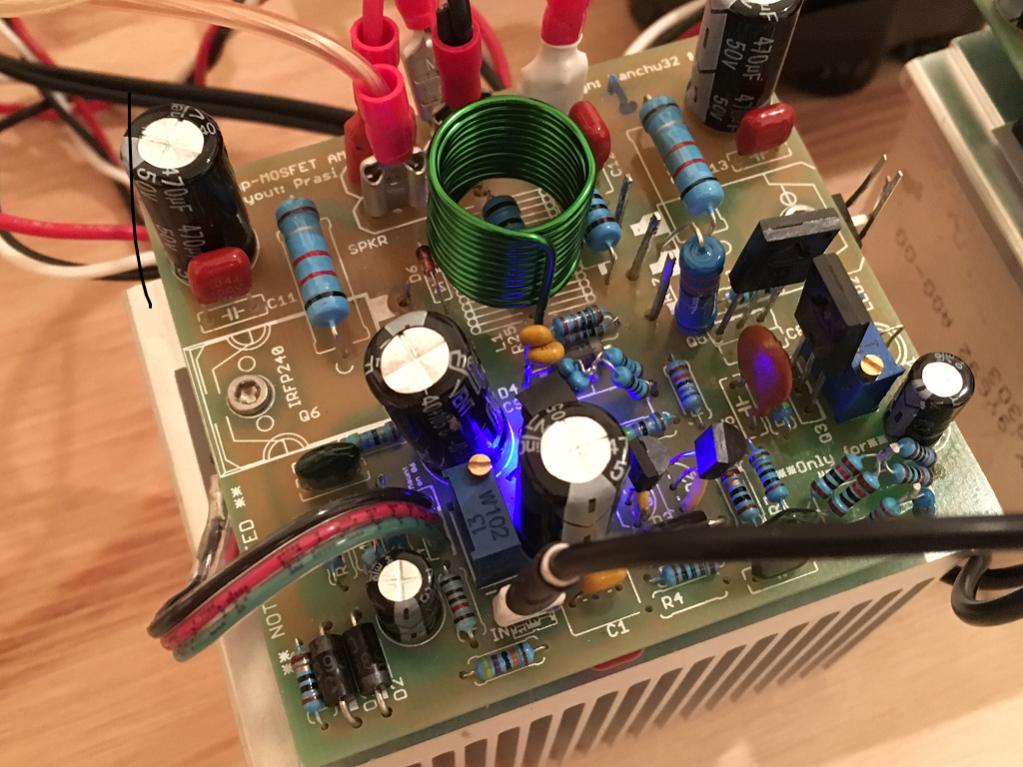

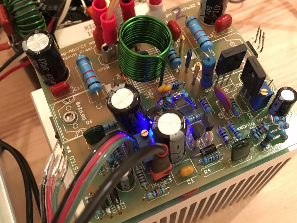

Closeup of Unit 1 (left channel):
Closeup of Unit 2 (right channel):
This is the speaker being used:

Very nice pcbs on the component side. Maybe since you have debugged the tracks and clean the grunge, maybe you should lacquer them to protect them from the summer moisture!
