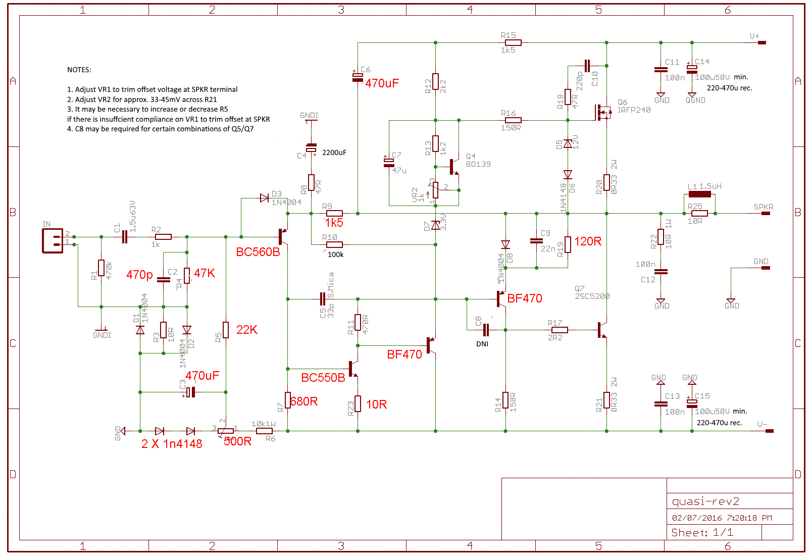

Yeah, please do. After all these changes and retries, I'm kind of lostPost your circuit as built😉
which one is final, working version.

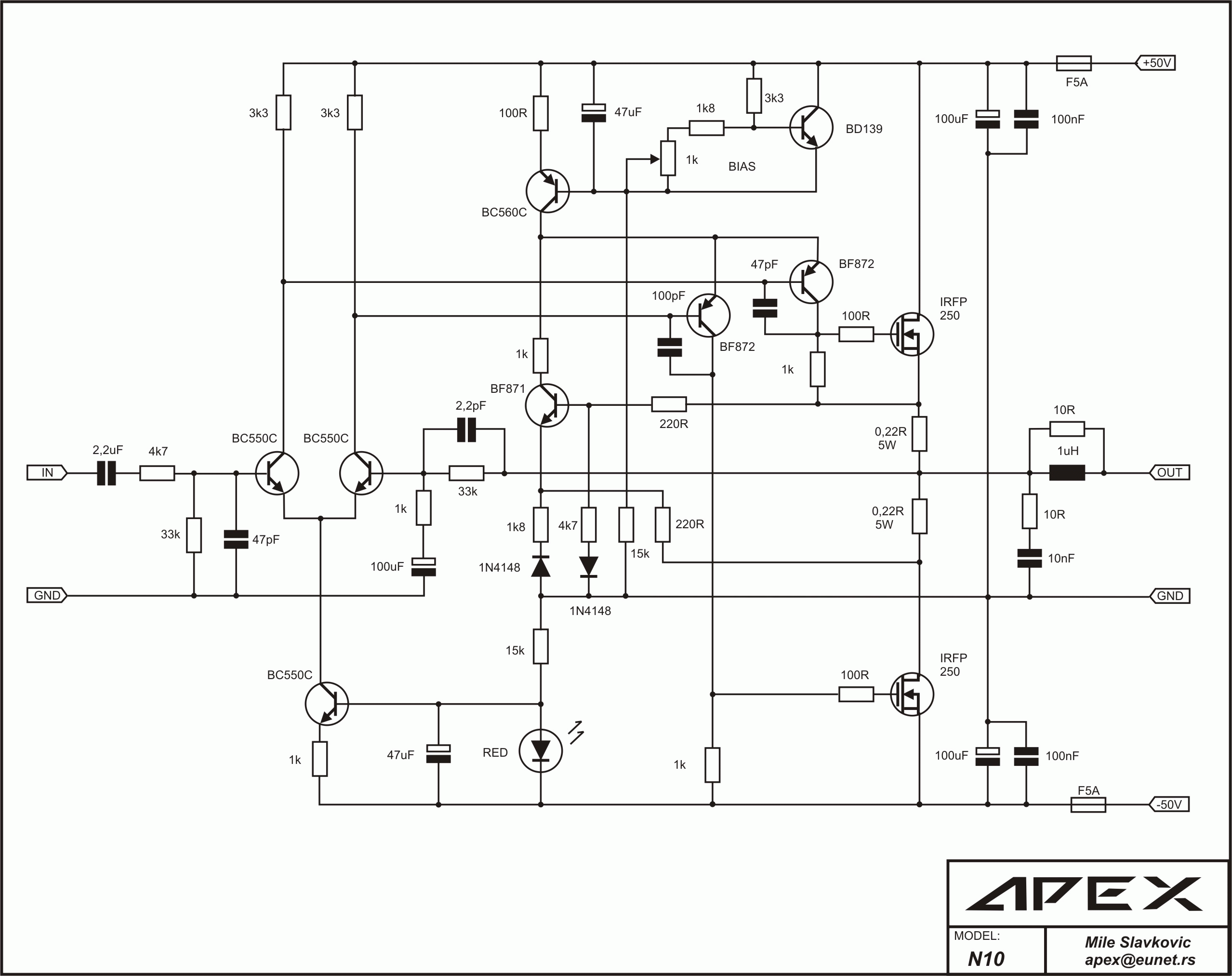

Hi Terry,
I quite like Mile's simple quasi but very conventional. He has a great ability to distill the best ideas of electronics into the simple, low count part schematics. Very clever guy. But the one I mean is N10, which I have attached. It is not conventional, and uses a concept I first saw on a Siemens design in the 70s. The question is: how does it sound compared to Ranchu's design, which we now know is quite a fantastic performer.
Have you built this one, XRK and Terry?
Hugh
Hugh

Hi Hugh,
This is the first I've seen of the N10. If Prasi or someone will do a layout for it, it is only a day away from singing. I have all the parts. I assume the BD139 needs to go on the main heatsink,
Blessings, Terry

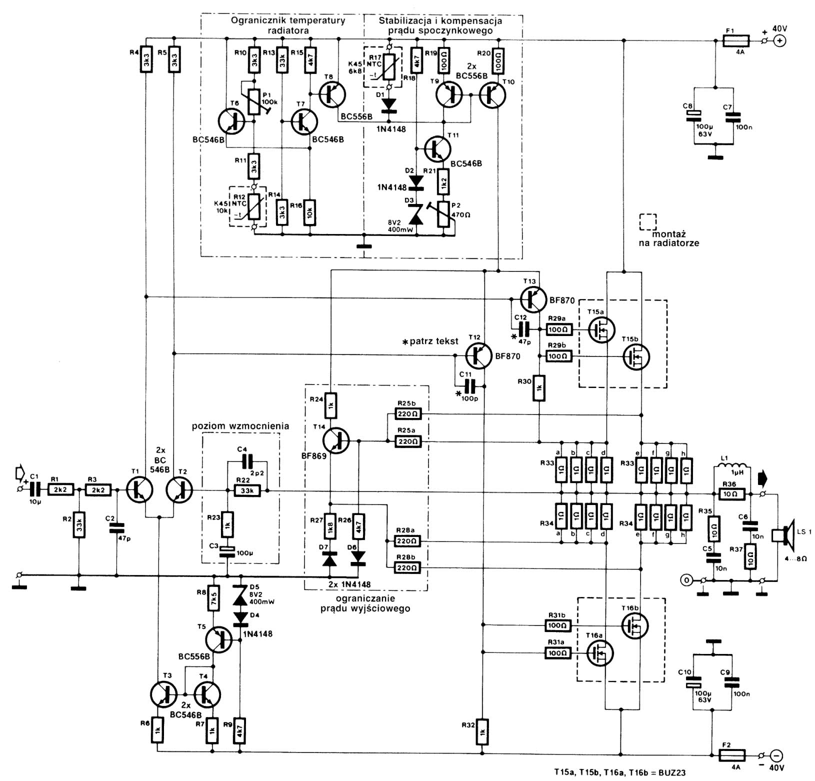

Hi Guillermo,
That is the Siemens topology but the symbols look very like Elektor. A beautiful schematic, thank you for showing it to us!
This circuit has very large loop gain difference between the pos half cycle and the neg half cycle. This gives high levels of H2 and sounds very warm. High THD however.
This early quasis used many pairs of early nmos; in those times because good pmos devices were not available. When complements were available they disappeared in the following THD Wars.
Thanks Terry, I am interested in your thoughts and if you could compare these very different quasis I would be most grateful.

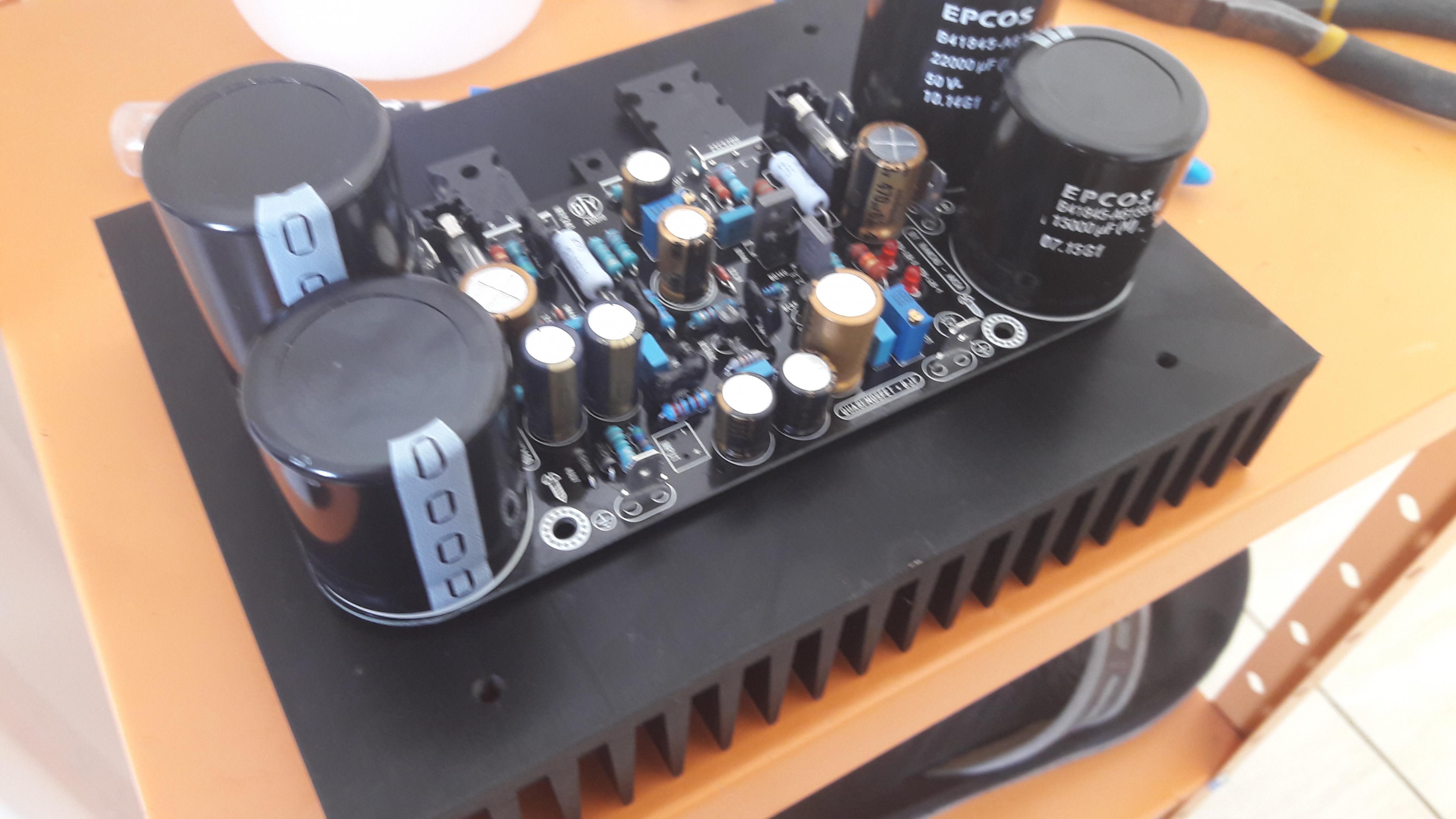

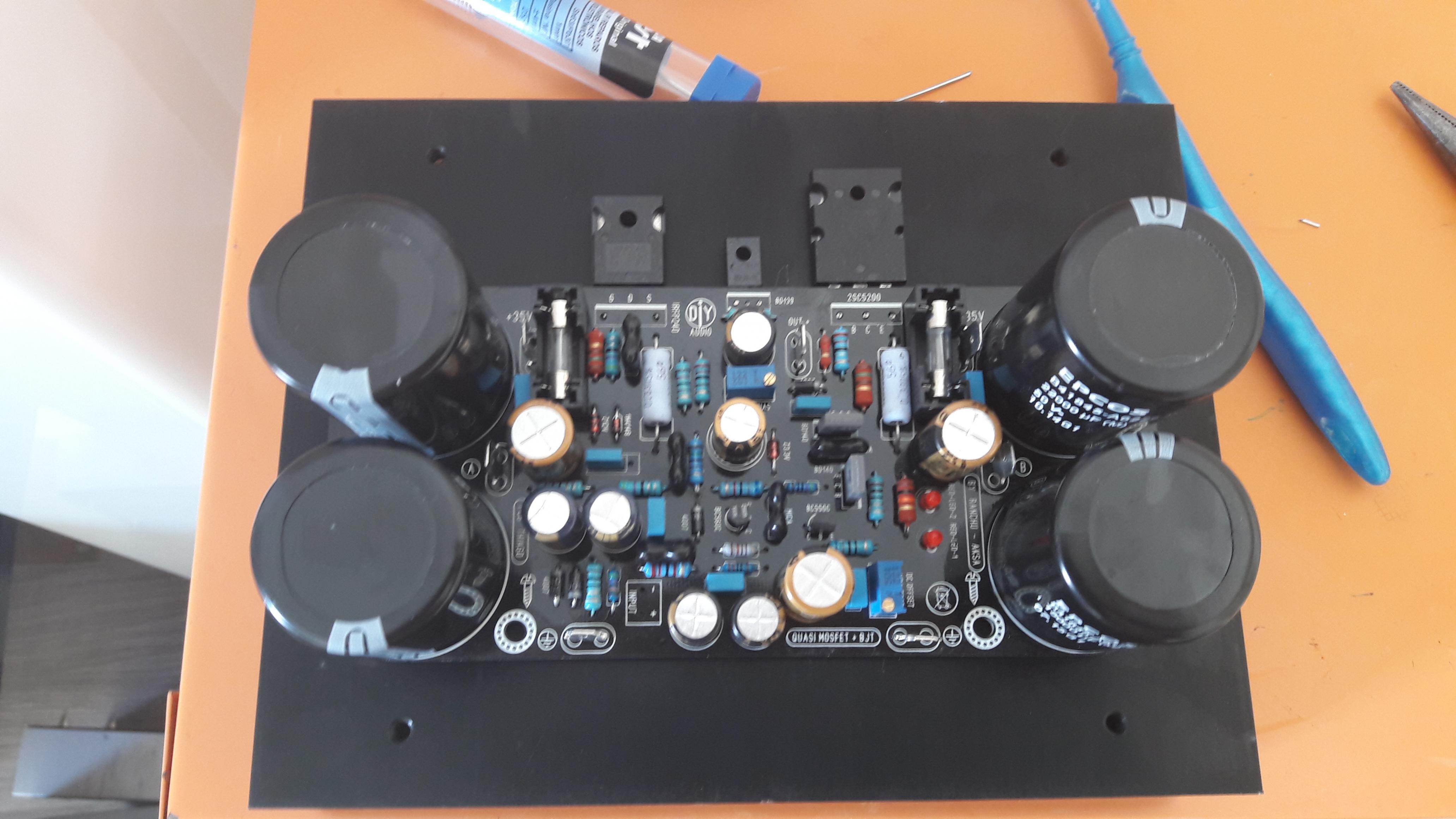

Hi Thiago,
Congratulations!
You might like to remove R4, 47k from input base to ground. It is not needed because the base is set by by R5, which you have set 22k. This will make the amp quite difficult to drive and not much bass; I'd suggest 33k, if you have the energy after getting it going on!! I believe the trimmer will bring back the offset no problem.
How is the sound?
Hugh
Congratulations!
How is the sound?
Hugh
