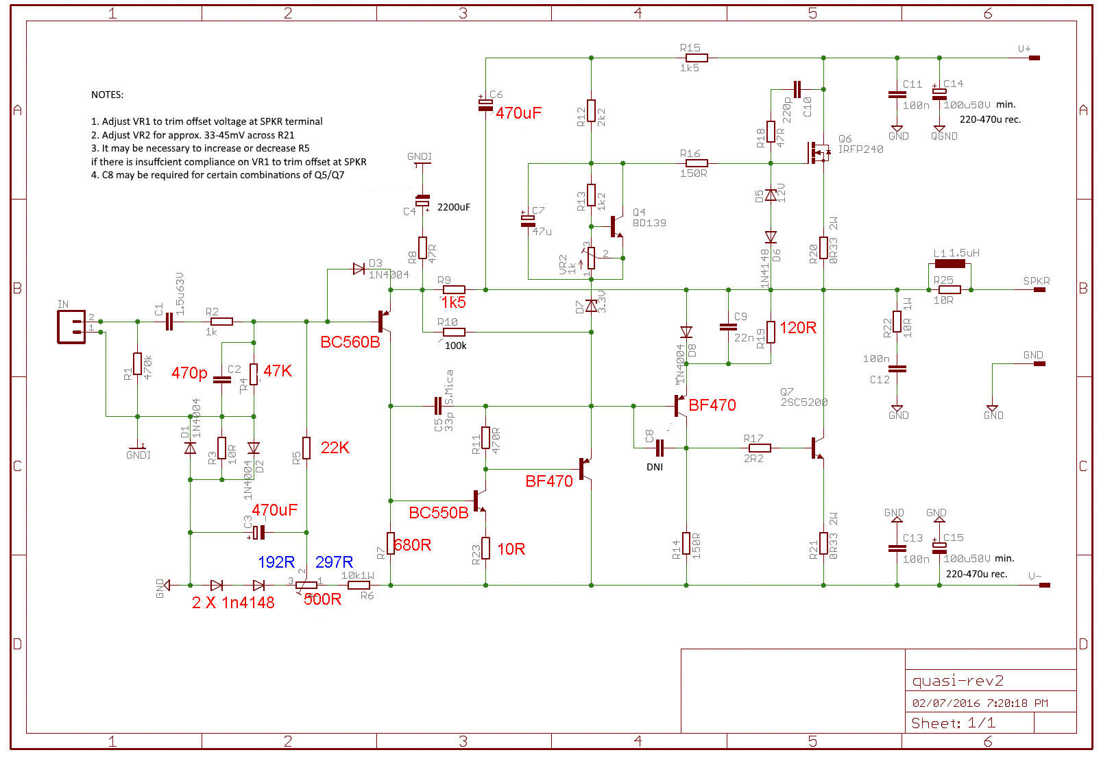

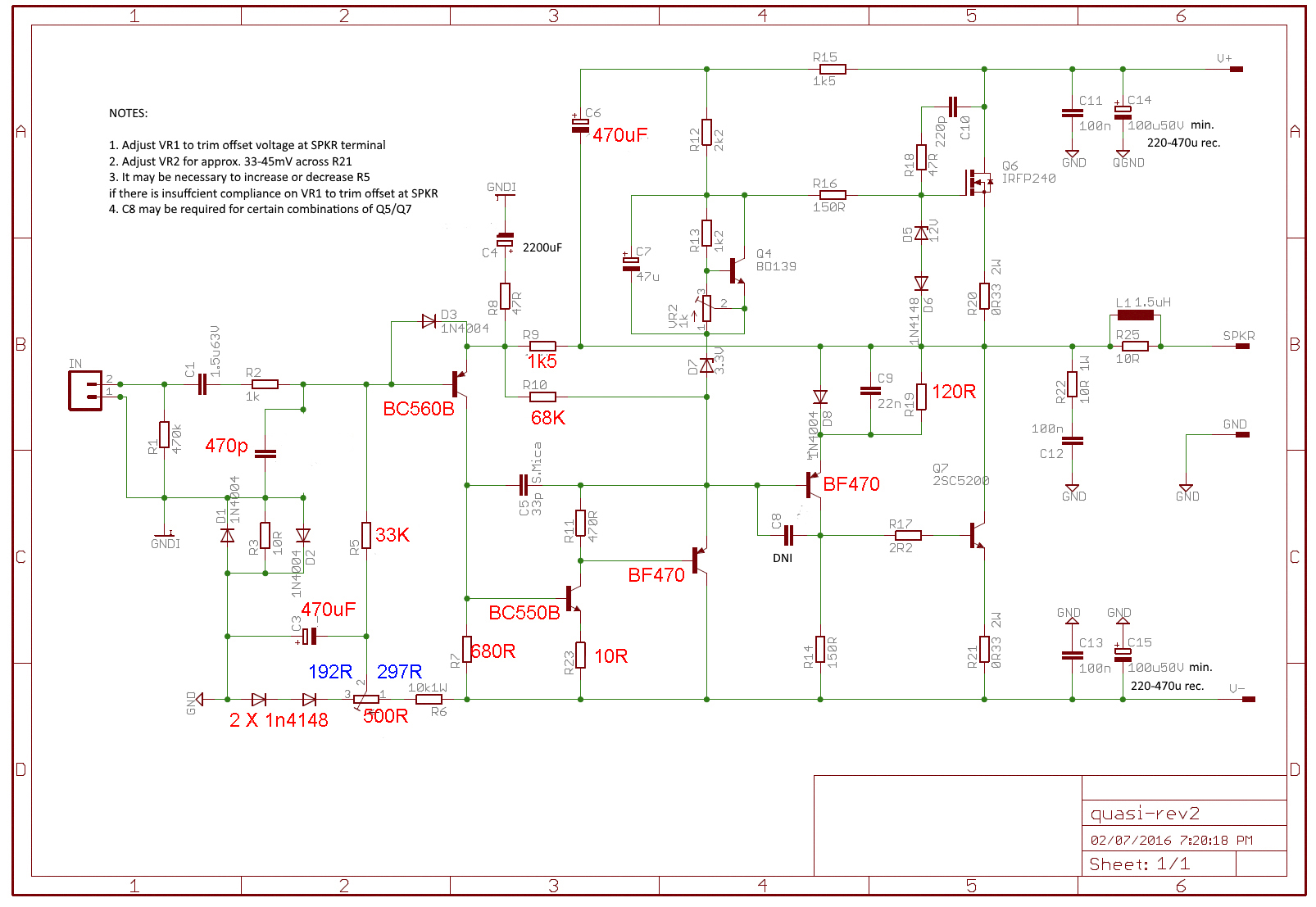

I see that you guys have changed the trimmer to 500R. Can one or both of you measure you trimmer and let us know where it is set? I'm curious how close to center you are.
Thanks, Terry

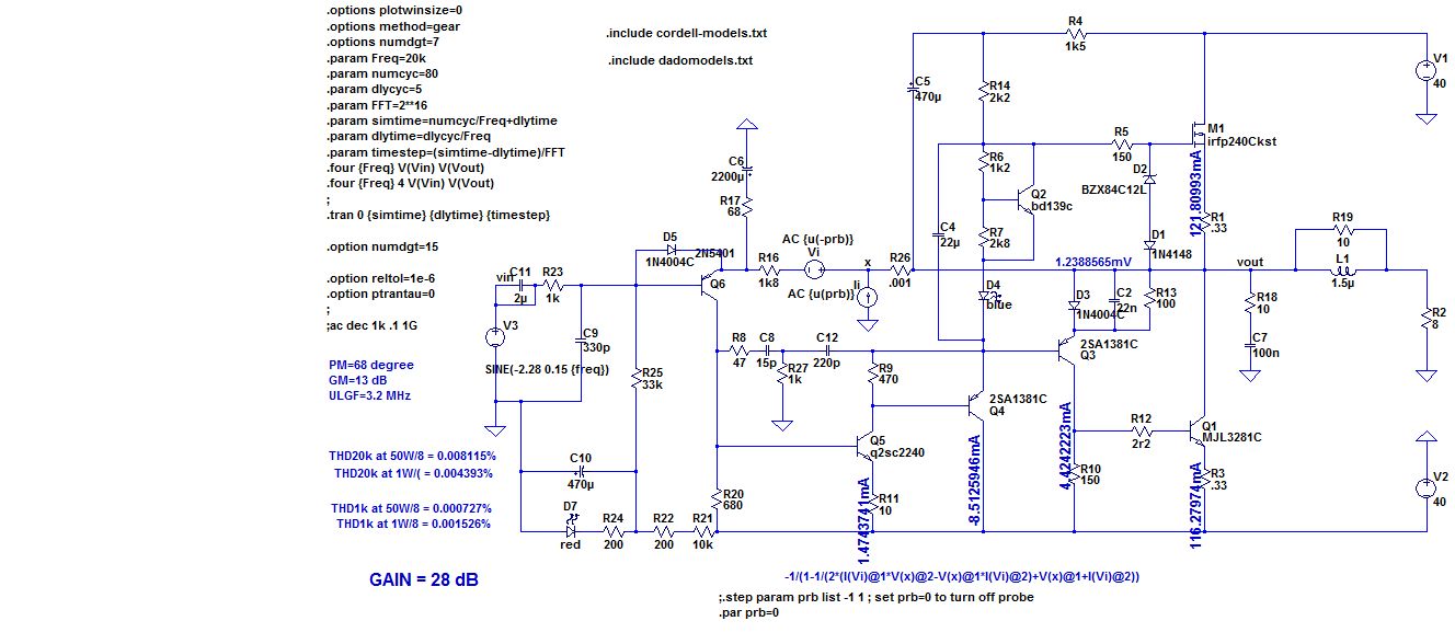

I am right at the edge of the 500R pot right now: 7ohms on one and 13ohms on the other. Certainly something external could still be done to center the DC offset on the trimpot more. But as it is, there is plenty of room to adjust as it is pretty sensitive to small adjustments.
Hi Thiagomogi,
Is that schematic your asbuilt? It is a little different than what Hugh is specifying. Is your layout set up for the BC550 transistors or did you have to twist wires? Looks like you kept R4 at 47k.

Reasons (refer to Thiago's schem #1005 above).
I moved to 1k8 (R9) so that I could increase the shunt resistor from 47R (R8) to 68R, taking the pressure on a very large shunt cap. With 68R 470uF is very good bass; you don't need a larger C4 2,200uF. I increased the current from 0.7mA to mA through Q1 with decrease from 1k (R7) to 680R collector load because the noise and gainwidth is superior for the 5401 at 1mA, and certainly this put pressure on the input impedance.
Let me figure the offset voltages, so it's clear where these values come from.
Assume the output sits at 0mV.
All the current for Q1 can only come from the output node (R9 and R10), and it's determined by R9 since 1k5 is far less than 68k. There is a difference of 2.2% but it can be ignored here.
So, 1mA comes through 1k8, and this drops 1.8 volts - giving us -1.8V wrt ground. Remember, this is negative voltage because it LOWER potential than the ground.
Now, the base of 2N5401 (Q1) lies 0.65V below the voltage at the emitter; if we figure out the base voltage is is now -2.45V wrt ground.
The base current must be calculated for Q1 now because it must come from R5 (33K) since all DC currents elsewhere are blocked by caps. Note also that R4 is DELETED, because it is were there it would be supplying base current from a 0V potential which would interfere with our bias voltage.
We assume Q1 has a beta of 100. This is an estimate but it's close. If collector is passing 1mA, then the base will need 1/100 mA to turn it on to this point, and since it passes through R5 33k, the voltage dropped across this bias resistor is 1/100 x 33 = 0.33V. Add this NEGATIVE voltage (it has to be across R5 33k and if the base is at -2.45V it must be lower) we have -2.45V + (-0.33V) = -2.78V.
So, we need -2.78V, plus or minus a few mV, to bias the output of the amp at 0mV.
Let's examine the diode/LED string which supports this bias voltage, D1/D2 and trimmer.

OK, I'm back at the cafetaria - to continue......
We need -2.78V at the bottom of the 33k bias resistor.
If we replace the two 4148s with a SINGLE green LED, then we have the anode of the LED at ground and the cathode at -1.95V.
The 500R trimmer comes next then the 10k supply resistor which sets the LED and trimmer current. If we have a -35V supply, then the current will be (35 - 1.95)/(10 +0.5) = 3.2mA.
With this current can calculate the trimmer range.
3.2mA across 500R is 1.6V; we start with -1.95V so we can adjust the down to -3.55V. We need a voltage of -2.78V so this should be fine and around the mid-point of the range.

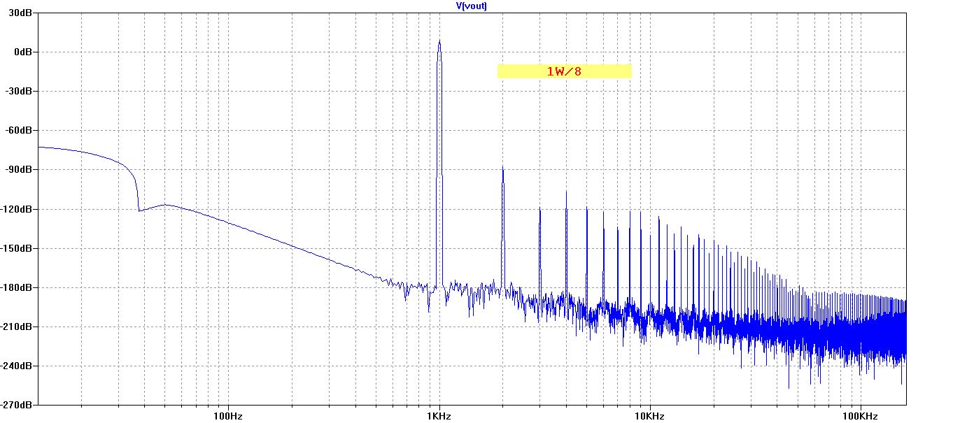

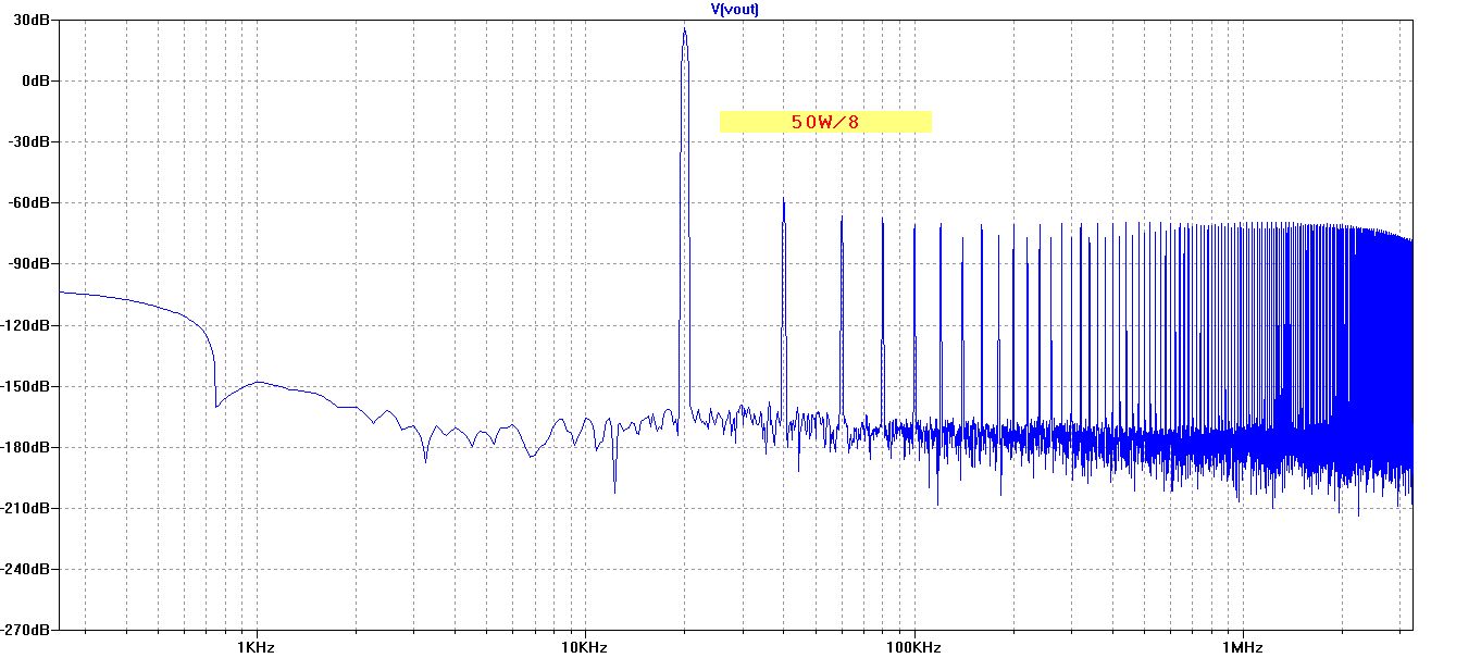

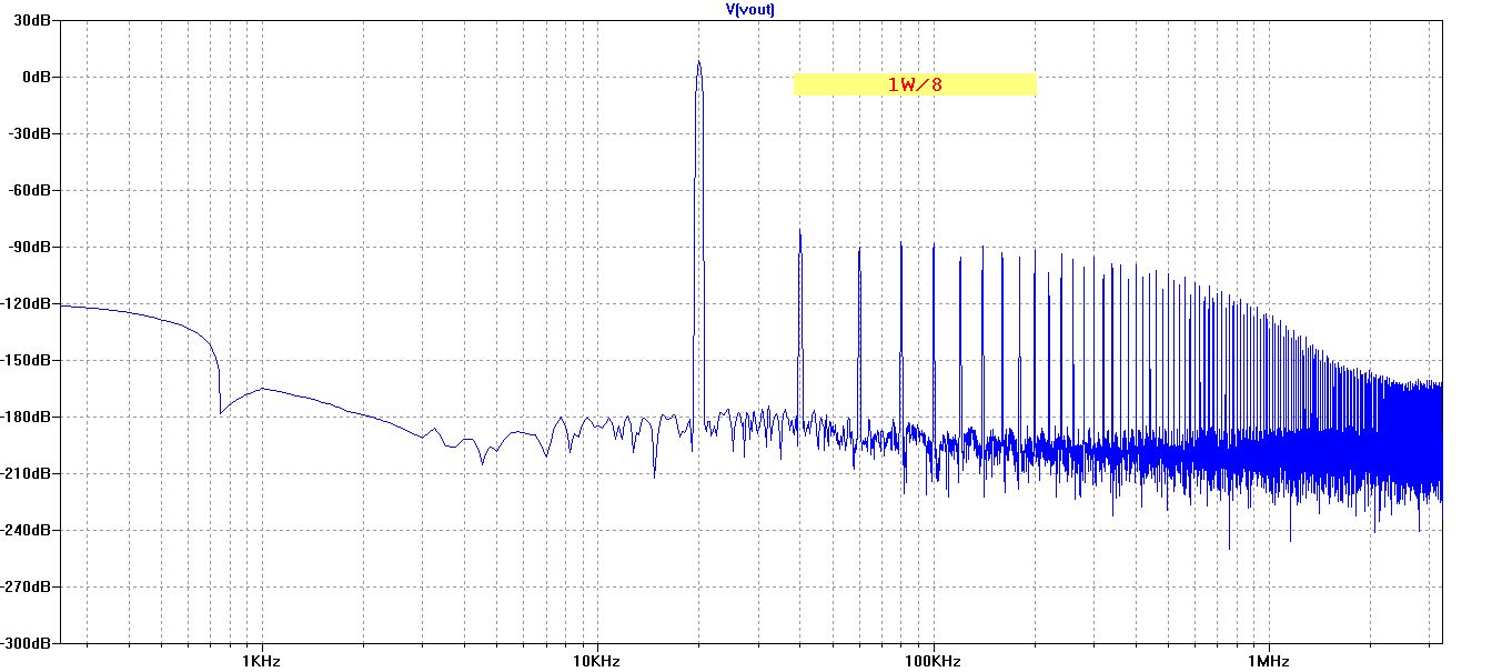

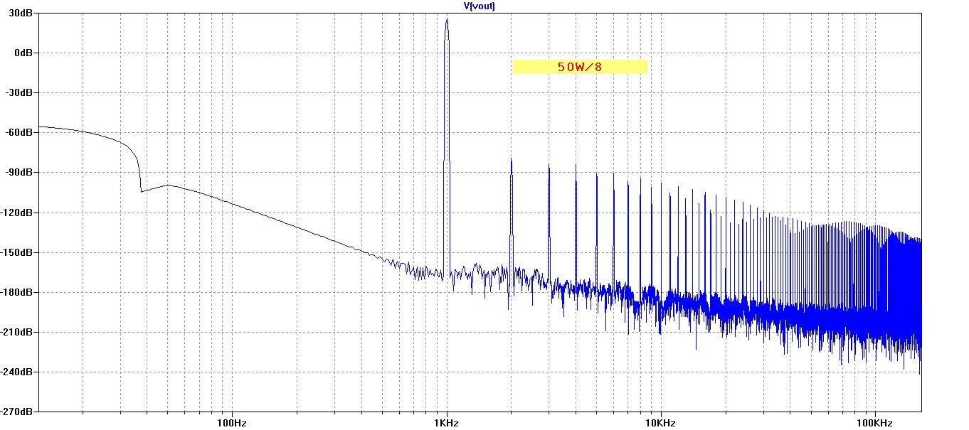

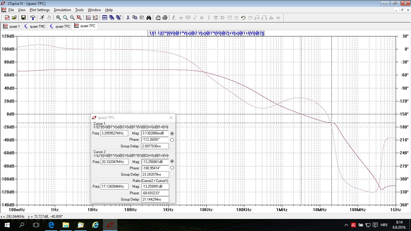

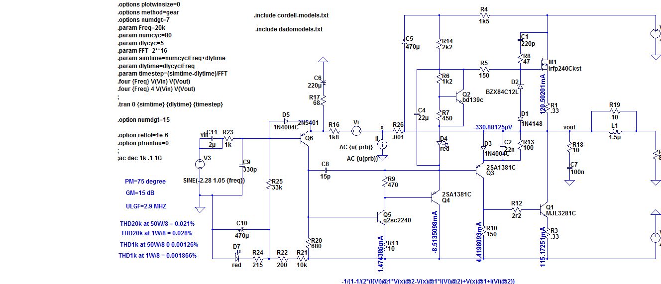

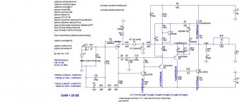

Here is my two cents. I was intrigued with this concept of combination MOSFET - BJT OPS.
I simulated quasi with lower cap 15pF(I think it's should be stable even with thi value) and than tried the same amp with TPC.
THD at 20 kHz dropped significantly but not as much as I expected(looking the Loop Gain plot). The reason for that, in my opinion, is two week drive of the output transistor(more visible at higher frequencies when output transistor came to play).
Additional local NFB around VAS, in my opinion does not do any good to the sound, and I removed it. All plots are for TPC version.
Damir
