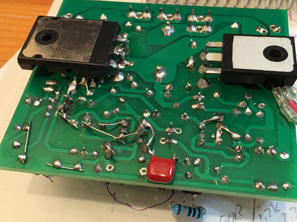

The board had major foil liftoff/breakage issues. I used Ronson lighter fluid and a toothbrush to clean all the flux gunk up. It evaporates without residue and once clean, I could see the damaged pads much more clearly. I went in and used a magnifier and continuity tester to check each pad and trace. There were nearly a dozen broken pads that separated from the board and sometimes the trace it was connected to. No wonder replacing parts won't fix it. I replaced each broken pad with a jumper to the next nearest point. I am able to get 0mV DC offset adjustment now. Once warmed up it is pretty stable.
Here is all the rework required to get this board back to playing music:
So the amp works fine with 2N5501 and 2N5401 and MJE350's. I wonder if the change to the new input transistors allows the DC offset to cross zero volts now as Aksa had suggested that it would. I am running 100mA quiescent current. These transistors are way more readily available and less expensive. You have to cross the pins 2 & 3 on the 2N5501 and 2N5401 though to use on this board.
So unit 1 is now working again, but I had subsequently fried unit 2 and will have to go through a similar process to fix. Another night though. I will stop while I am ahead.
