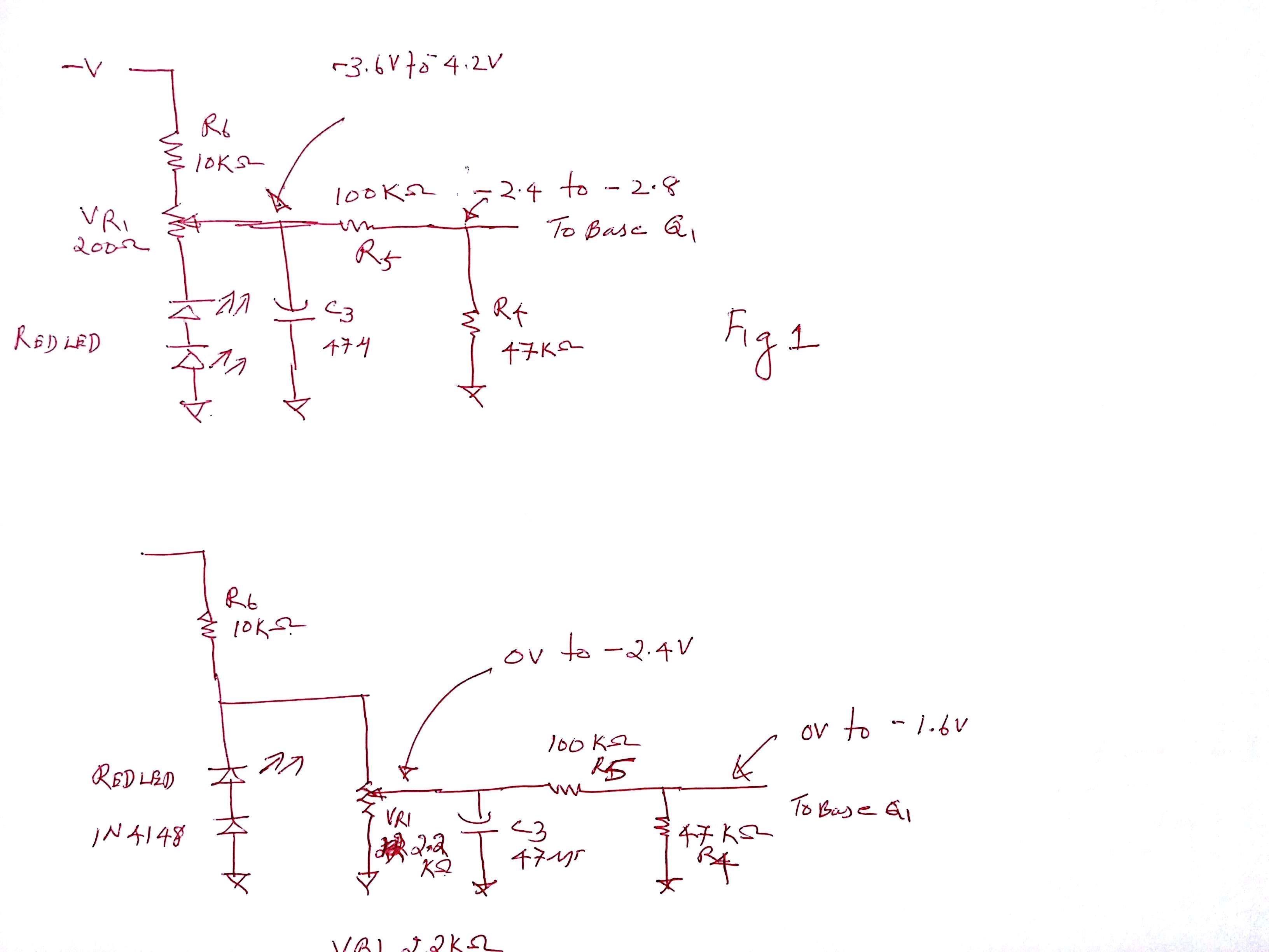

I used a combination of whatever I had on hand: 1N4007, FR104, FR107, in these positions and I don't think it matters much. It's the LED positions and teh zener that affect the offset more.
Sorry but something still isn't clear.I used a combination of whatever I had on hand: 1N4007, FR104, FR107, in these positions and I don't think it matters much. It's the LED positions and teh zener that affect the offset more.
We have two working prototypes,me &Terry,both works fine using two red led as offset voltage source.
It isn't clear, up to now,why another can't work in the same way😕
My red LEDs were the culprit I think. They had 3.5v drop over two and that was way too much. R4 absolutely did not work for me. Offset would not even move one bit with it in place. I am not sure why it works on yours. We will see what others who have same board say when they build. BanglaH have Eric F and Meanman same board.
To fix the dead amp, I want to go through and replace every BJT except the 5200. However, I'm all out of 2SC1845's and KSA1831s. Can I switch to MJE350's instead of KSA1381's and use twisted leg 2N5401's instead of KSA992, and 2N5551 instead of 2SC1845's?
Offset adjust part have design problem. to get offset near to zero, the base voltage of Q1 will be between -0.55 V to -0.65V.As per the existing design it will between-2.4 to -2.8. you cannot get zero bias. Another issue is VR1 is connected in series with led, Any change in -ve supply voltage will change offset, may be small because R6 is much higher than VR1.But sue it will change.
By very little modification you can get stable 0V offset.
Sorry , Connect two red LED instead of one LED and a diode to get 0 t0 -1.2 V at base of Q1. calculation mistake.Then Voltage across VR1 is -3.6V and Q1 base voltage can vary between 0 to -1.2 V
