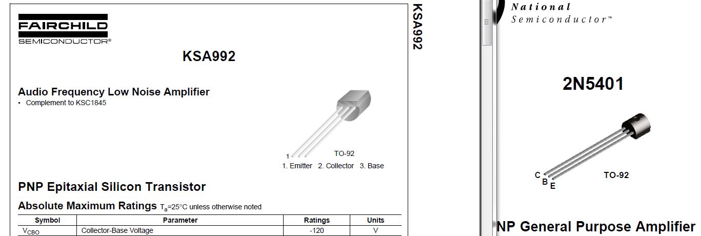

Beware that the 2n5401 and KSA992 To92 transistors have different pinouts - see attachment.
If you have a ksa992 for Q1, I'd leave it there.
Paul Bysouth

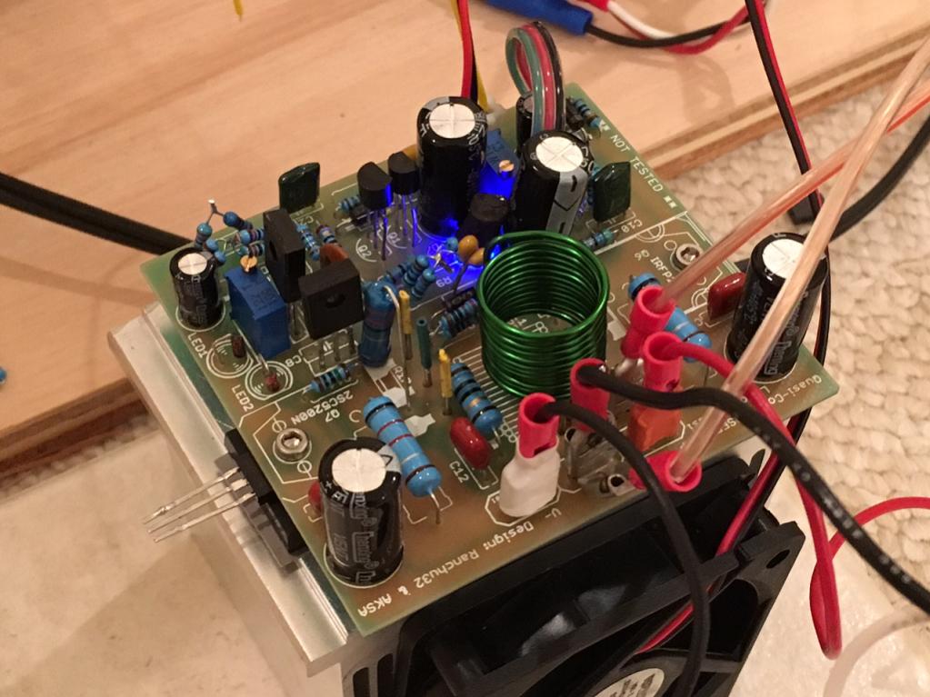

Well, I spent nearly two hours trying to fix the amp that I fried and also implementing upgrades with no success. It still pegs the current on the 10R safety resistor at 17v or 1.7amps when turned on. I even replaced the IRFP240 and same result. I guess I have to go in and replace all transistors one by one or could it be something like a burned out pot or blown diode etc.? What a waste of time that was. Basically put it aside to get the frustration down.
I then went on to my other channel which was never tested with a good audio source and just went ahead and replaced the R9 and R7 with 1k. I had to make a 1w 1k resistor by series-parallel qnty 4 x 1k 0.25w resistors. I installed two 1n4148's in place of the red LED's. Put black shrink tubing over the obnoxious blue LED. Plugged it in and fired here up. Bias was stable and adjusted to 22mV across 0.22R for 100mA quiescent current. Now the money shot: is the DC offset good? Drum roll.... well yes, almost. I can now get -23mV DC offset. It responds to the offset pot but that is just the limit. I am running 500R pot, so what can I do to get it to 0mV? Can I change the 33k R5 to another value? Or add a resistor in parallel to the pot to get the value lower? Would switching to 2n5401 help to fix the DC offset issue even further?
I am listening to music now. Sounds great! The bass is very nice. The over all sound is very pleasing, sweet and delicate. I can do an A/B test with the JK VSSA on the left speaker and the quasi on the right.
It's holding it's own.
563002d1470217886-very-simple-quasi-complimentary-mosfet-amplifier-quasi-dc-offset-mod-success.jpg
Hugh, thanks for all your help in getting this to work! Could not have done it without you. :cheers:
Do you have any suggestions on how to go about fixing my fried amp? I think you said check Vbe of each BJT and it needs to be 0.55v to 0.65v?
Edit: Q3 and Q5 are running relatively cool now - not hot at all. So the changes seems to have helped in this respect too. No heatsink needed.
