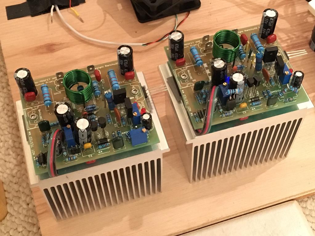

Very simple quasi complimentary MOSFET amplifier

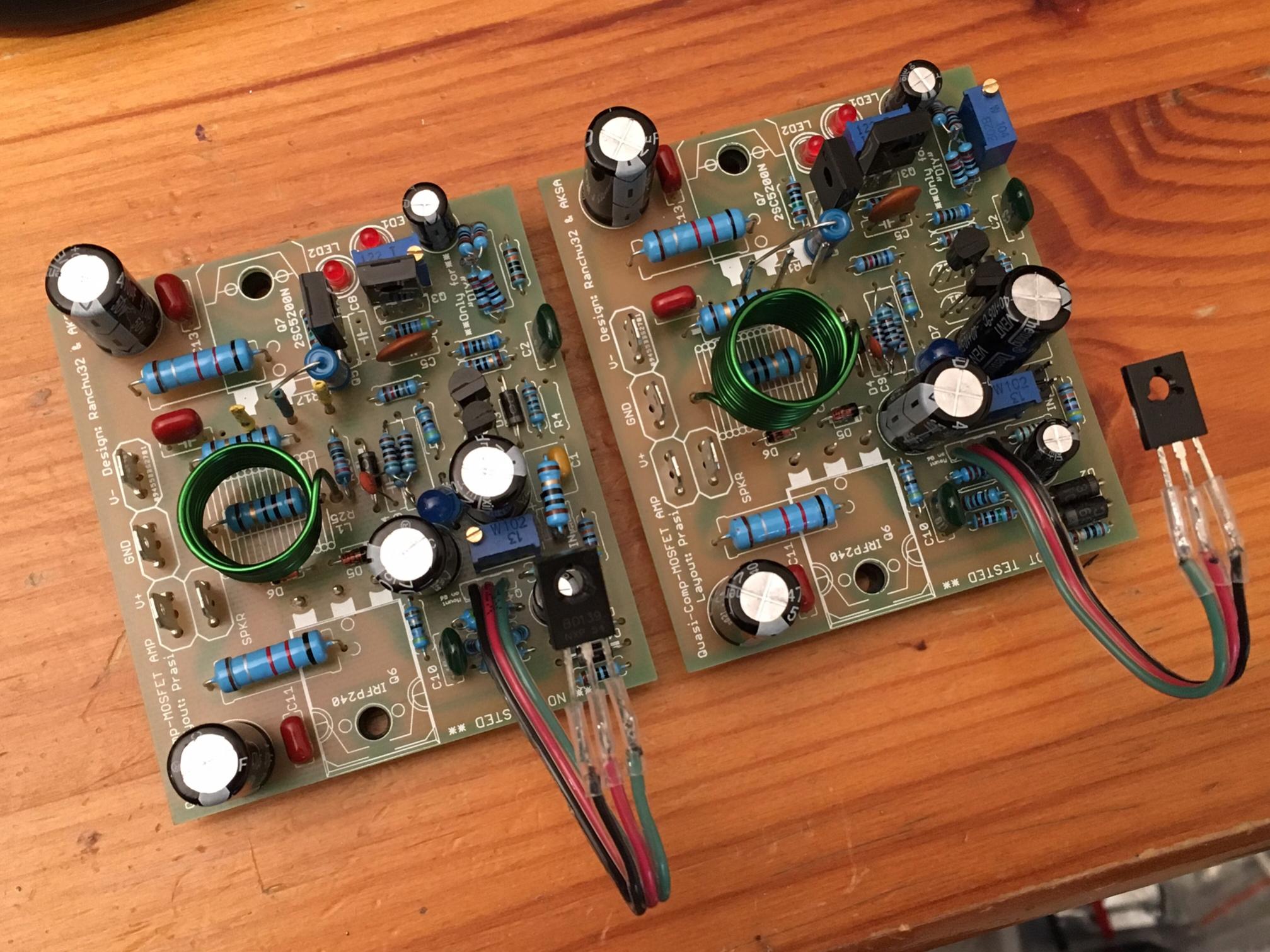

Also a difference in wiring
I double checked the BD139. It is correctly wired on both boards as you can see and the difference in wiring color between two boards is what caused the confusion but I was not concentrating on making color of 3 wires consistent between amps but just the orientation is correct. I know having that flipped the bias won't adjust and the amp probably pegs one rail.
Here is

yes cross posted (should have been like whatsapp, which shows if someone is typing), any progress on your amp?
I had been running on 2 or 3 hrs sleep so thought maybe clearer thinking would result from a good break. Anyhow came back with fresh eyes and spent last hour retouching and reflowing all solder joints with my iron and using magnifier goggles to carefully examine all joints and pad for lifted traces/bridges etc. All looks good so far. About to go in and try to re-measure all voltages requested by Aksa, this time with a reasonable bias current of 80mA and using the 33k (32k actual value) at R5. Will report back soon with voltages.
I am listening to my FH9 as I work on these repairs, and it sure sounds good and fired up perfectly the first time. This amp, on the other hand, is a bit of high maintenance lady. 🙂
