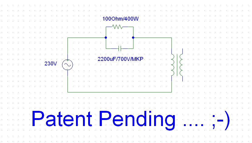

For moderate powers I would personally suggest:
1x 2200uF/700V MKP (For energy electronics) and 100Ohms/400W in parallel (to the cap), mounted on a sufficient heatsink ... 🙄

I expected, that this question would come ... 😀😀😀😀
I mean the most "simple" circuit possible: A single coupling capacitor, snubbered by a resistor (To dampen resonance).

Jon, from your comments and diagram it appears you don't understand how a DC blocker works in the supply to the transformer.
Your diagram will only work for small currents.
It has no bypass facility for transient currents during switch on or similar.
bypass facilities for a non polar MKP (foil) capacitor?
By this rated voltage? Why? And which parts you mean?

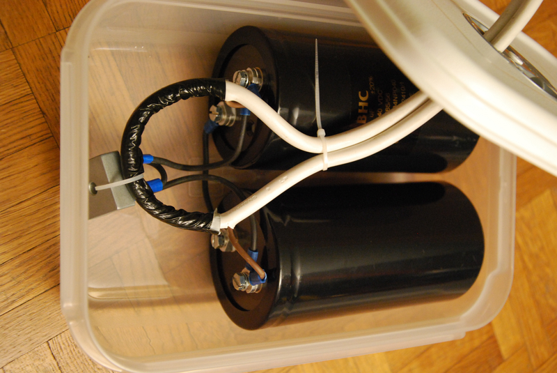

Hi all
I just built a DC blocker and as I am a (dangerous) noob when it comes to electronic I figured I'd better have the experts look it up before I power it up and burn the whole house 😀
It is a simple pair of capacitors (+ terminals connected together) paralleled with a bridge rectifier (+/- terminals connected together).
It is the same circuit as the one presented by Rod Elliott in the conclusion fo his "Mains DC and Transformers" article
I am using BHC 100,000uF 40V capacitors, and a KBPC5010 bridge (50A)
(yes I got a little bit overboard...).
Are those values correct? Any ill effect when combining these values I would have overlooked?
I plan to use this with a powerful amplifier (MC2 MC1250).
Attached is a photo of the circuit in a temporary box (but as things are going it might well be there for a long time...).
Obviously it is hard to see much with this photo, but everything is correctly connected, following Rod Elliot's circuit.
What do you guys think? :bomb:

pos, seems fine, component-wise. Not easy for me to double check your wiring by the pic, but you say it's correctly connected.
But if it were in my house I would want to have it in a grounded metal box, in case something gets hot -- or worse -- i.e. the same precautions as with anything plugged in to an electrical outlet.
common, this is a box meant for microwave cooking, it should take the heat 😀
Thank you for your answer, I will try to find a metal box of appropriate size (damn me, why did I choose those big capacitors...). What component could get hot?
I will at least try the circuit in this box, as soon as my amp starts to hum again (it is desperately quiet since I build the circuit, go figure...)
SOP (standard operating procedure) for when **** happens not due to your mistake. Pretty much any component, connector, solder joint, etc. on its way out can get hot due to internal resistance...
Have you checked the range of VDC while it's been in-circuit (by hooking DMM across it)? I found in our house it's typically +20 to +30mV, but goes regularly to +70mV (and when our printer comes on it goes crazy +2V, -0.6V...)
