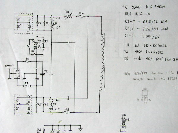

As supplement to post #80 the DC filter from Mark Levinson's ML-23 (No 23, ML23).

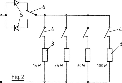

because the non symetrical nature of the mains waveform changes from second to second. You can hear the transformer coming into a troubled state and going off again repeatedly, during the course of just a few minutes.
It depends very much on what other users are doing in loading the mains supply.
Switched resistors have no hope of matching the dozens/hundreds of other users loads on the constantly varying mains supply.

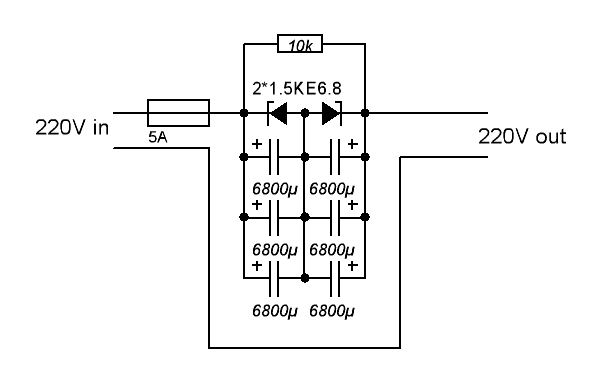

One more circuit of EMC filter with input DC COMPENSATION.
Very interesting - this kind of dc compensation I have never seen before. After redraw for better understanding this DC filter network seems to be designed for most reliable operation in order to the electrolytic caps.
Do you find this topology in a commercial audio component or is this your own idea ?
The DC compensation is flawed !
There is no bypass around the capacitor if there is a fault current.
The capacitor will end up taking the full fault voltage (since the fault current cannot flow unimpeded) and blow up !
Far simpler to follow the ESP circuit which is based on the various (correct) posts on this Forum.

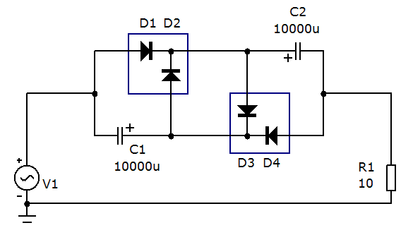

All DC filter schemas that I have seen there you will find here in the attached files.
Вот вариант фильтра DC, где можно поставить диодные сборки с общим катодом, которых валом на каждом рынке.
Two diodes with common cathode in one case (for example, case TO-220), which you could buy anywhere.

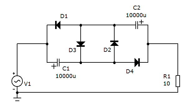

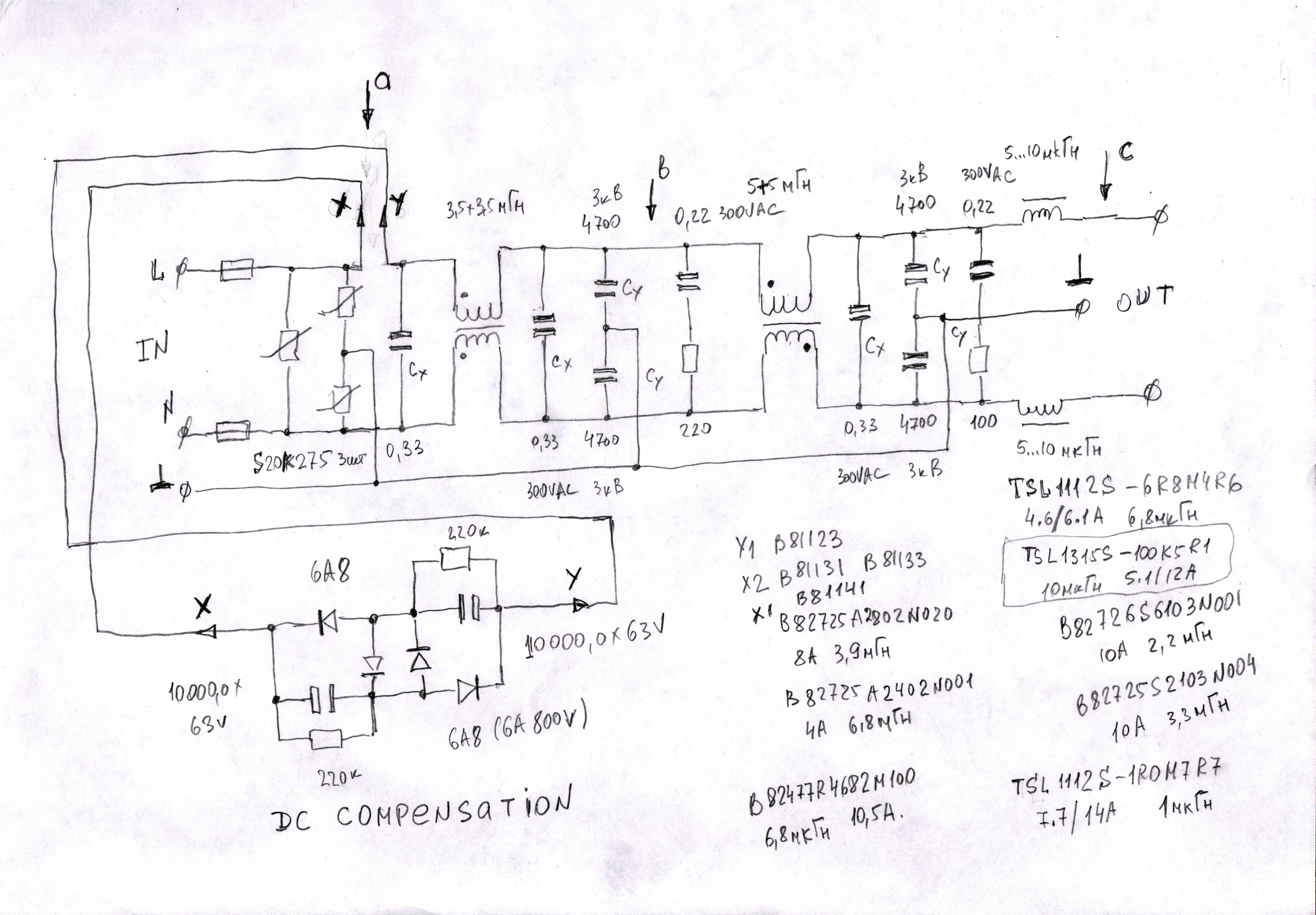

D1 and D4 (first image post #93) must be reversed, also C1 and C2 (go to the PDF by post #96).
This is corrected circuit of DC compensated.
All diodes are 6A8 (not LL4148) !
All resistors are 1 Watt.
how the formula for the calculation to get the resistor value "22R"
tiefbassuebetr
There are two base different circuts of DC compensation, see my posts #89 and #96.
Circuit from post #89 has two pairs of diodes with common anode.
Circuit from post #96 has two pairs of diodes with common cathode VD1, VD2 and VD3, VD4, but without resistors R1 and R4 .
And more, there are two modifications of base circuits where two resisrors 22 Ohm added.
