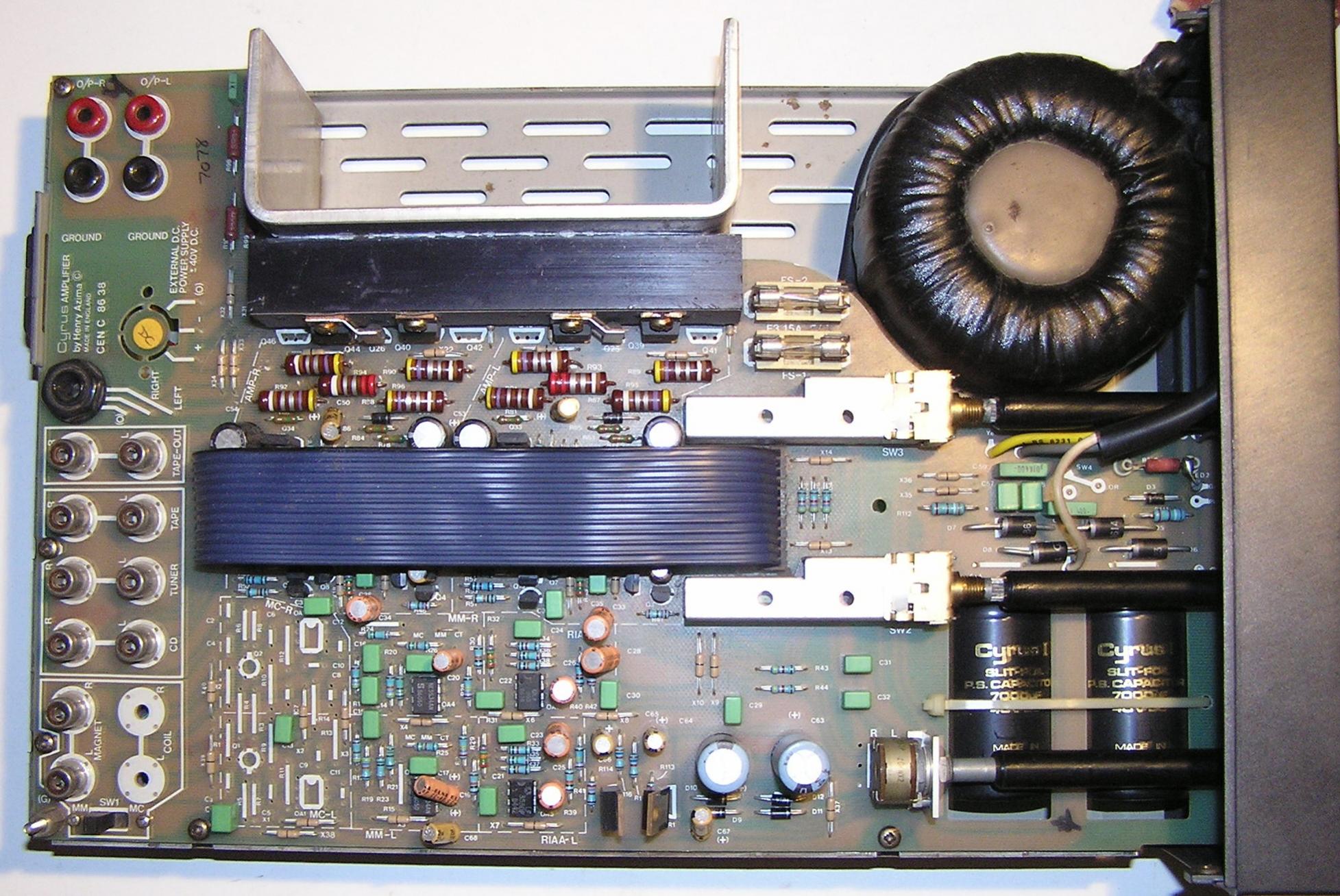

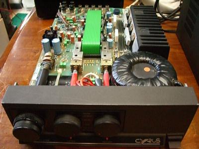

Hallo Bob,
today I get a "Cyrus II" from Mission for checking. After opening I found a burnt/destroyed resistor and a capacitor, which must be exploded. I replace this components for the third time (and much more bigger versions than the original purchases). But I think, in one or two years the same work is necessary again.
This devices are also arranged between the safety ground from the line cord and the main circuit ground, but not shunted by an diode network (bridge arrangement - as you it call) like Bryston. But this could be the right solution also in case of the Cyrus II.
Nevertheless - for me it would be interesting to know, from where comes such large voltage/current transients between these two ground potentials?
Perhaps it must have to do with temporarily, very rare and very short but very large different earth potentials between Broadband-Cable connection for radio and TV and that one from mains voltage connection.
is CyrusII double insulated or does it have a protective earth wire connected to chassis?
The versions for the German marked have a protective earth wire connected to chassis (also by Cyrus ONE/I/1. But I don't know exactly, what about the other countries. In German the mains voltage connector haven't a polarity, i. e. I can pull out the wall connector, turn around and plug in in this second polarity (please note: only by the wall connection, but not by the amplifier main connections). In your country this isn't possible.
For this reason you will not find the RC network at the PCB from attachement (british version - I think), not even the PCB hole therefore.
By German versions this network is to find in line of the PCB GND wire from the electrolytic crosspoint (right of the screw, that is close by the volume control potentiometer). One end is solder to this mentioned PCB wire (electrical GND) and the other is connected to the screw (chassis GND).

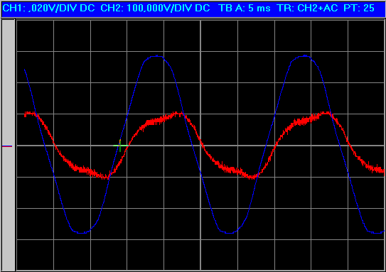

To Rainwulf:

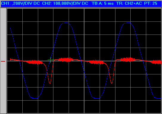

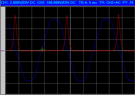

I did many tests some years ago concerning DC offset on mains line and buzzing toroids. Distorted waveforms can make a transformer produce some noise when they have strong high frequency components, but DC on mains line results in far more noise due to transformer saturation, which manifests itself as sharp high current peaks just before voltage crosses zero.
First image is current (red) and voltage (blue) in a 750VA toroid with the usual DC offset at my place, .2A/div and 100V/div. Little audible noise.
Second image is current and voltage when I turn on the 1500W heater in half power mode, 2A/div and 100V/div. Note the huge current peaks due to saturation. Big audible noise.
Third image is current and voltage when a simple DC filter is added (1000uF and 2 back to back diodes), .02A/div and 100V/div. Transformer becomes completely quiet, even with the heater in half power mode.

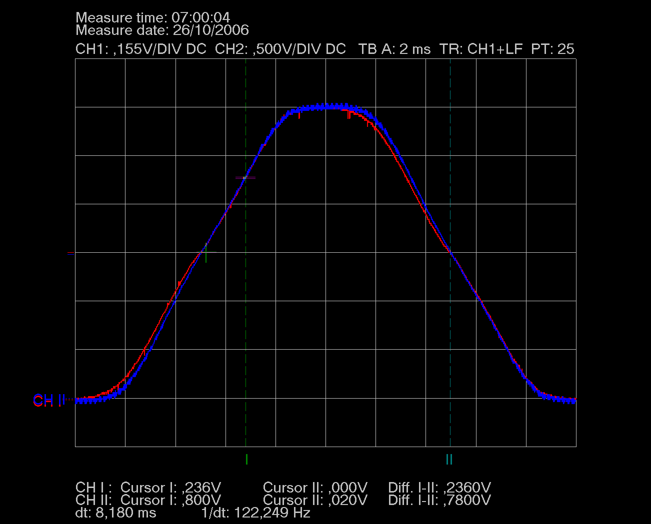

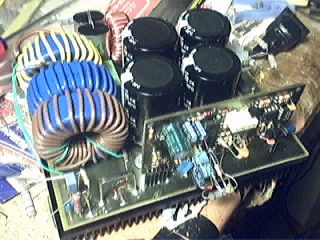

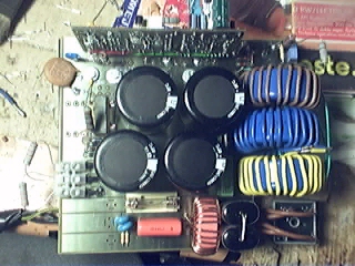

And these waveforms are from a 3KW active PFC prototype that I did a long time ago. They were obtained while simulating low line conditions, blue trace is input voltage at 50V/div, red trace is input current at approx. 10A/div (working at over 2KW).
Note how well the current waveform tracks the voltage waveform. The slight phase lead in current waveform is because several microfarads are required in parallel with the input to filter EMI properly.
