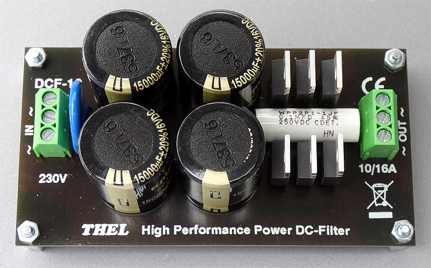

The trick is to look at the AC mains current waveform consumed by a toroidal transformer primary winding - if it is symmetric then there is no dc bias influencing the core - if it is not symmetric then there is some net dc current shifting the BH curve loci.I’m still waiting for someone to show what DC on a the mains looks like with a scope.
The voltage drop of the diodes isn't critical in order to audible dynamic loss.Dc blocking circuit (developed and implemented in the 60s) works very well and I have been using it for many years, since the 90s. When it comes to "dynamic reduction" i wolud say it depends on what you are looking at. It´s not that simple.
The buzzing sound from a transformer is reducing the s/n ratio quite dramatically and can be annoying. A DC blocker fix that!
If you think that the voltage drop of 1 volt out of 230volt will cause a dynamic reduction electrically i would say no. Unless you have a zero feedback design. Otherwise with a small amount of negative feedback the difference in power supply voltage is not affecting the music signal at all. IF your amplifier is that sensitive for power supply voltage, that a small supply voltage change is noticeable in sound reproduction, simply change amplifier!
But the effect by low voltage capacitors (6V, 10V, 16V or 25V) is really not to be neglected due to the absence of low ESR character.

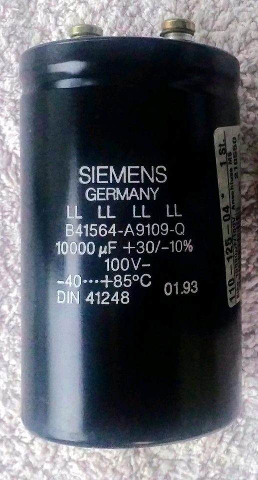

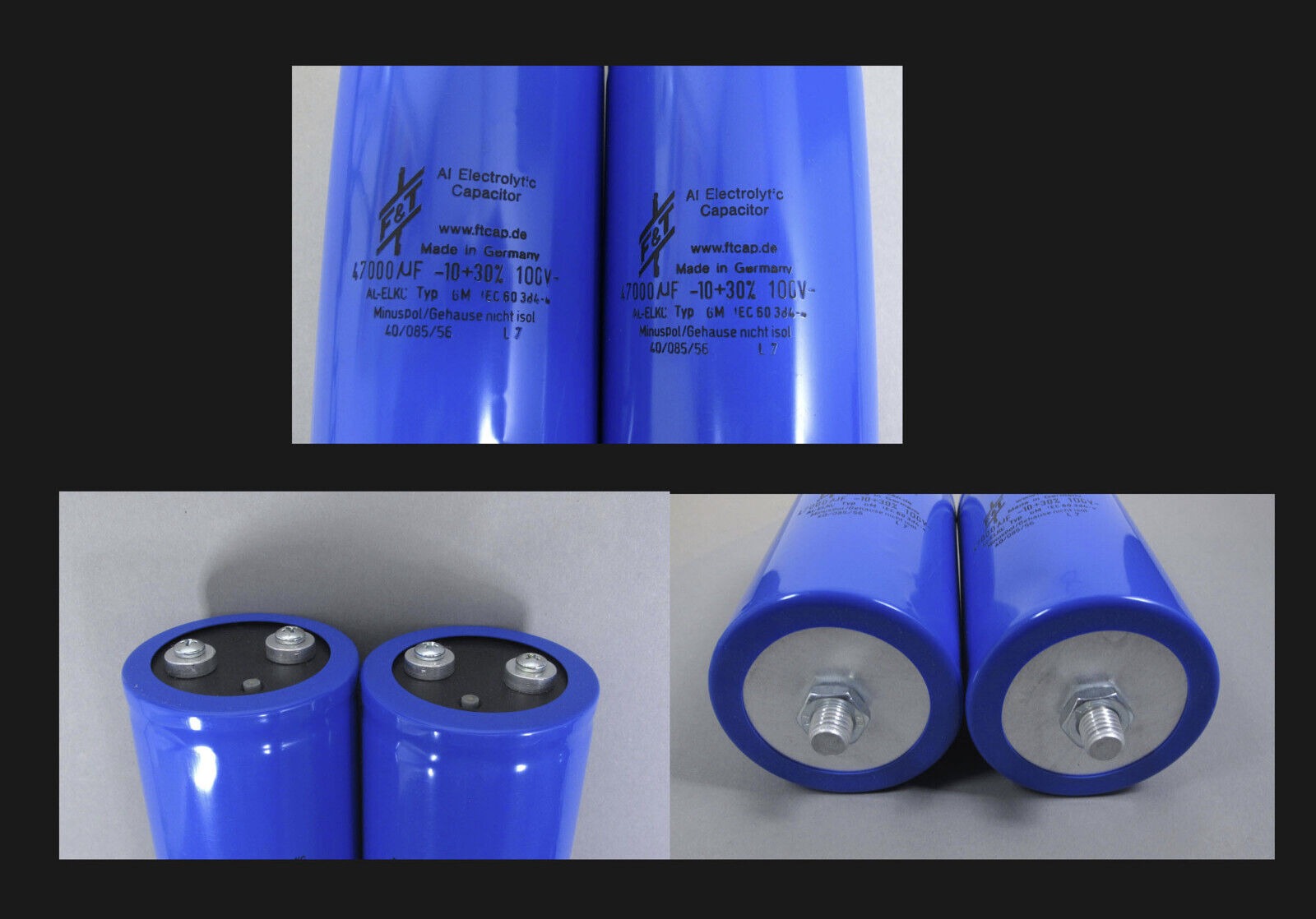

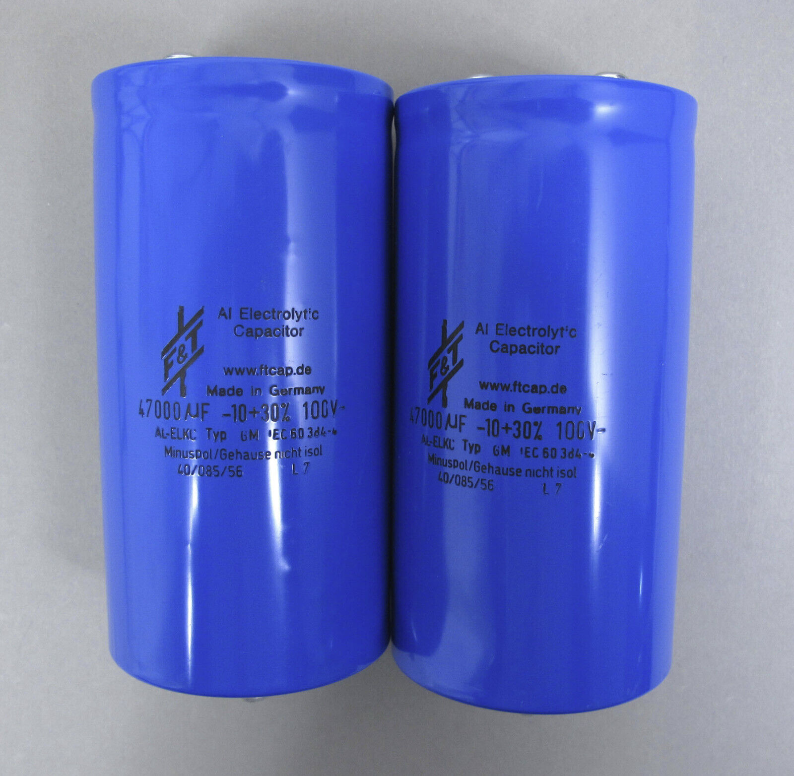

Most commercial available DC-Blocker as accessory unit do not pay attention to this important fact - go to image one of attachment. Image two and the unit (from post #270) underThanks!
The Bryston arrangement does not have this issue because the diodes never conduct under normal conditions.
In the Bryston implementation, the electrolytic capacitors should have very low ESR and be rated for high ripple current.
Moreover, that arrangement should probably not be used for amplifiers that do not incorporate a soft-start circuit.
Otherwise the capacitors will be subjected to harsh turn-on current transients.
Bob
https://www.diyaudio.com/community/...lter-for-toroidal-transformers.317094/page-14
looks slightly better, but still not sufficiently low ESR.
Consequence concerning sonic character of power amp is, that loss of dynamics must be accepted during listening tests (and of course the risk of destroyed components).
Therefore I am looking for a commercial available DC-Blocker with electrolytics from top class (go to image three, four and five from my attachment) - unfortunately no supplier I have found until this day - so it is necessary to realize a suited diy project for this.

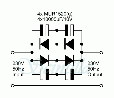

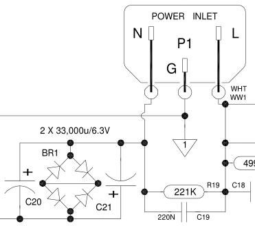

But here rises up the question, what are the pros and cons of each approach from circuit diagram of image six - go also to
https://scintilla-buizenversterkers.nl/scintilla-buizenversterkers/zelfbouw/zelfbouw sites/DC-Blocker.htm
and image seven (most used circuit topology - first time I have found in Bryston amp devices).
Maybe you have an idea.

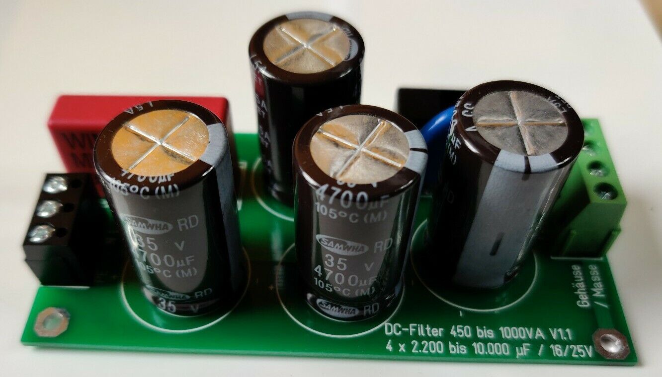

Good evening.
Yesterday I made these circuits for my power amp with 2 500VA Toroidal that would occasionally emit an audible hum up to three meters, even just after powering up.
Apparently this noise has been greatly reduced with the circuit I made using only two 47000uF capacitors I oridinate two more to be connected in parallel.
