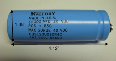

Mallory 12,000 uF 30V
These are the caps I used.
spec sheet says 0.018 ohm ESR and 8.4A max ripple current.
I use 3 sets of 2 series caps.
I realize I do not need so much voltage, but I get them new for $4 CAD each and I have lots of space so they are a nice solid package and the system is dead quiet and sounds great. 🙂
