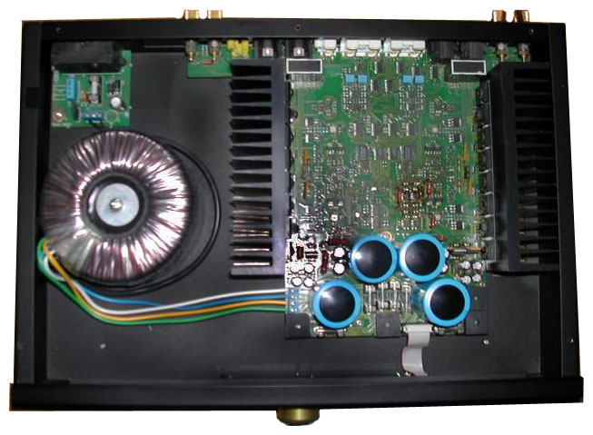

in the attached images you will find the components of Anders Thule's DC filter solution (in the AC mains line) from the first circuit by post #1 (pdf attachment). In the IA150B image the mains AC input board is licated behind the toroidal transformer
The second capacitor isn't in use in most cases (C48 in the first picture) and the voltage of the other (used) cap at this place is only 6,3 volts.
By Thule amps there are many other shortcommings in case of the realibility, but until this day I haven't observe an exploded or defectice capacitor at this place. For me this is really amazing - but nevertheless I want this not to justify.

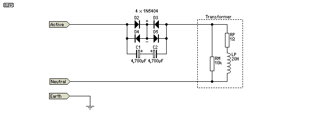

Rod Elliot's DC blocker is NOT "a dangerous circuit by nature." The caps aren't really doing much in normal operation (except during switch on inrush). The ESP article explains this...
Mains DC and Transformers
My experience is the opposite of yours and is what lead me to assemble my own DC blocker: As I turned up the bias, my ~250VA transformer got louder in general. And with the cover off, it made more noises...
AFAIU the circuit, I can not agree with you on the above statement.
The capacitors are actually doing the whole job, specially under no load or light loads until the event in which the current value through them raises enough so that the diodes will take over, preventing capacitors from overloading.
My experience is in accordance with the concept below, extracted from the ESP article. If you draw current from the traffo secondary, will cause core saturation to lower, hence mechanical hum should lower as well.
As I understand, if your toroid/s increase growl along with current then a DC blocker might not be a solution to your problem.
I might be wrong so I gladly accept feedback.
.....Most of the time, the DC offset is transient - it appears for a short while, then goes away again. When it is there, toroidal transformers may complain loudly, by making growling or buzzing noises. It is important to understand just how this happens, and what can be done about it if it causes problems.....
.... With larger transformers (500VA and above), the DC resistance is usually so low that even a very small offset will cause mechanical noise due to saturation.....
.....From the DC perspective, the most critical region is at no-load. The saturation effects are greatly reduced when we are drawing significant current, so we will hopefully be able to simplify the circuit......

Yes, the diodes are the protectors for the electrolytics against voltages above 700mV.

The impedance of these 6 caps in series parallel is predicted to be
Xc=1 / {2PiFC} = 1/{2*3.14*50*0.018} = 0.18ohms for a 50Hz supply.
The peak voltage across the diodes must not exceed ~400mVpk for each diode not to pass and for the DC blocker to remain effective.
The maximum peak current across the capacitors will therefore be ~0.8Vpk/0.18ohms ~ 4.5Apk
That is the peak voltage of the primary current pulses that must not be exceeded for the DC blocker to work.
For the Canadian mains frequency the allowable peak current is 6/5ths of that figure, i.e. 5.4Apk for 60Hz.

BTW, I use 3m3F 16Vdc polarised caps. 10 in series parallel works effectively for my 50Hz 240Vac supply.
I suspect that both 6Vdc and 10Vdc would be equally effective. But the diodes must protect the caps even during a fault condition through the blocker. I have used 1n5404, but not tested it for fault current.
The Bryston 4BSST uses two 33,000uF, 6.3V polarized capacitors connected in parallel in opposing directions across the blocking diodes. They use a high-current bridge rectifier to implement the blocking diodes.
Most of the time the capacitors will be conducting high-current spikes of relatively low duty cycle, as is normal for rectifier circuits, as opposed to sinusoidal current.
Inrush current at turn-on may be stressful to these circuits, so it might be a good idea to employ a soft-start circuit.
