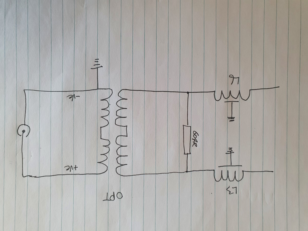

Have reflowed all the DC blocking caps along with all the inductor connections and nothing has changed. Measured the 1kHz going into the OPT's, as opposed to originally measuring at their output and nothing has changed, so the transformers seem to both be 1:1, which is good.
Measured at the DC blocking caps and the left channel measures about 4.5Vp-p and the right channel 4.0Vp-p so very similar there...the problem is definitely in between the DC Blocking caps on the main board and the OPT's on the filter board...just have to find it.

Got it!
Was an error of hindsight. Checked and rechecked everything on the filter board, was starting to pull my hair out, then I remembered Marcels advice about grounding the OPT secondaries...did that...volume problem is gone. Still a fair bit of noise in the left channel but tomorrow I will see if I can trim that out with the trimpot.

Strange that you only had a factor of two difference between left and right then. Anyway, great that you have solved it!

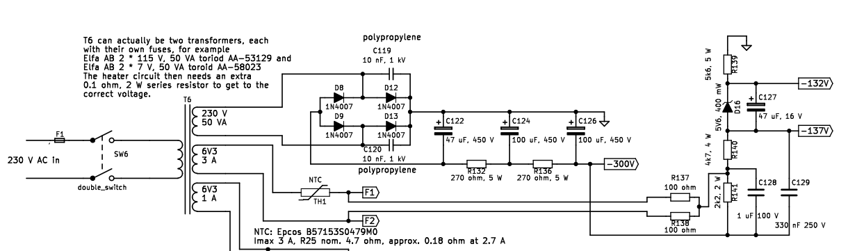

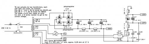

Marcel, i meant ; "are they connected to anything" ... not on the drawing but actual wires..
I found that if i forgot to make that connection , leaving them floating will induce hum...
Could this be the case here?
It's certainly possible, but it doesn't seem likely, as it is a connection made by soldering through-hole components on a PCB. When you forget to populate both of the two 100 ohm resistors, then the heaters will float.

Have found a few moments to look at the hum issue and it seems as though I can choose only one of two things:
(1) Loud 50Hz hum with equal output left and right channels
(2) No hum with one channel half the volume of the other
These two behaviours stem from where I choose to connect the OPT to ground on the filter board. If I use the middle of the secondary winding then it hums but both channels have the same output. If I connect from the -ve outputs of the secondary then no hum but channel imbalance.
