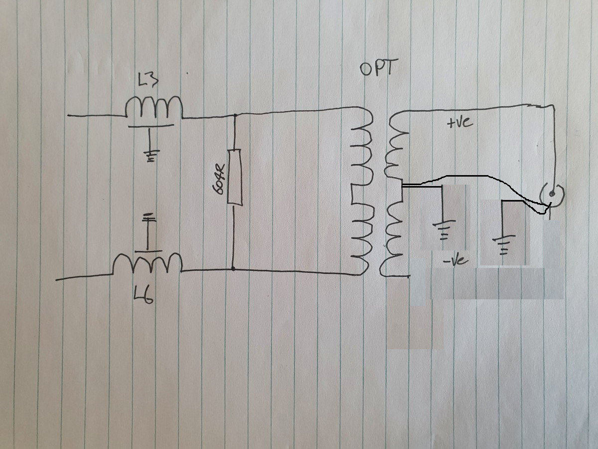

Have found a few moments to look at the hum issue and it seems as though I can choose only one of two things:
(1) Loud 50Hz hum with equal output left and right channels
(2) No hum with one channel half the volume of the other
These two behaviours stem from where I choose to connect the OPT to ground on the filter board. If I use the middle of the secondary winding then it hums but both channels have the same output. If I connect from the -ve outputs of the secondary then no hum but channel imbalance.
Dac and preamp are plugged into the same mains powerboard and the only other connection between the two are the RCA cables.
In the case where the centre tap is connected, is the negative side of the secondary winding open? Or is the negative side connected via the signal cable and the centre tap via the protective earth, so the bottom half of the transformer's secondary gets shorted? In either case the effects you observe don't make sense to me yet.
You get channel imbalance when you use the complete secondary windings rather than the upper halves. Does that mean there is something wrong with the bottom half of the secondary winding of one of the transformers?
No change in wiring from my previous handwritten drawing apart from the connection to ground moving from the -ve end of the secondary winding to the centre-tap for both channels.
I should closely check the wiring of the OPT's to make sure they both actually comply to the diagram with which they arrived. It may be that simple.

Ok. Have found some more time today to fault check my ValveDac. Left channel is obviously putting out less volume than the right.
Previously I had tested the OPT's for shorted windings, DCR, inductance and general function and they are both fine. No problem with the iron it seems.
One thing I did realise is that the old analogue oscilloscope may have developed a fault because it is giving me rubbish and varying readings so it is ditched for now. I do have quite a decent DMM which when used correlates to what I am hearing and measuring with the SPL Meter, which is that with a 1kHz sine playing the left channel outputs 162mVAC and the right 435mVac. The SPL meter is reading about 8dB difference at the mouth of the midrange horn between left and right channels. The measurement equipment seems to correlate so all good there.
Still using the DMM with the 1kHz sine playing through the speakers at the 600R resistors that terminate the reconstruction filters (so at the input to the OPT's) I am reading a little more than what comes out of each OPT so there is a small loss in each OPT that is to be expected. Still all good.
Move the DMM back to the DC Blocking caps while still playing the 1kHz sine through the speakers and for the right channel I measure 535mVAC (all good) but the left channel is over 12VAC...yes volts...between C31 and C32. Gave RV1 a spin for a while and the voltage did not change nor did it when tubes were swapped.
With the filter board disconnected there is about 15VAC across both C32/C31 and C54/C53, so by my thinking the problem is somewhere on the filter board between the pcb input and OPT input...all those inductors and caps in the left channel, but I cannot find the problem. It's driving me nuts especially with all the confusing readings the oscilloscope was giving before I set it aside.

If you switch the conections between the DAC and filter boards does the left channel become good and the right not? I know it's really basic but it would at least confirm the problem as being in just one half of the output filter PCB - if that's the case the end of your journey must be very close.

Here is a new one. The filter-to-dac cable can only be checked with power on because the relays short signal to ground unless the relay is opened by the dac logic. So, poking around on there with the power on and everything connected I am getting exactly the resistance readings that I should be i.e. nothing connects to ground that should not and nothing is different to testing the filter board when it is unplugged from the dac board.
What is different though, is that with nothing playing there is sub mVAC between DC Blocking Caps C31/C32 but put on the 1kHz sines and we have more than 12vAC...with music it jumps around a lot but the Fluke 287 still shows values measured in multiple vAC rather than mVac like the other channel (that works properly).
nautibuoy, it is not simple to just swap channels, but I think I should give it a go.

The filter termination resistance is indeed about 300 ohm now, which more or less halves the output signal level and can cause some abberations in the frequency response, particularly in the ultrasonic region. It can't explain the issue you have, though.
I think I will remove that resistor. Have been aiming for 600r filter load to get the output I think I need...which is pretty close to what it is now, but not quite.
Made up a cable to swap channels on the filter pcb. The ValveDac LHS now drives the RHS filter, and so on. Also removed R1 on my previous sketch so should be getting roughly double the output voltage previously.
Results:
(1) low output has shifted from left speaker to right speaker and high output from right to left
(2) High output is 0.94Vac...was previously about half that...so this is correct
(3) Low output is still 0.16V...has not doubled and is exactly the same as before other than now being on the opposite speaker.
(4) Still have more than 12Vac between the DC Blocking Caps C32/C31
Am thinking now that the issue is on the dac pcb.
