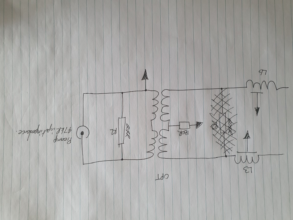

Yes, that sounds logical. Could you measure the AC levels with respect to ground while playing 1 kHz, 0 dBFS on both sides of C31, both sides of C32, and both sides of each of the DC blocking capacitors of the channel that works properly? Maybe we can narrow it down to either C31's side or C32's side then.
See the attached diagram for how things are currently wired.
I overlooked it at first, but the common-mode termination is missing. Could you add 150 ohm to ground from the centre tap of the primary winding of the transformer on both channels?
Have just re-connected the 180R common-mode termination resistors (and removed the adapter cable to swap filter channels). Did have them originally but removed them for some reason that I cannot remember...I think it was to do with hum. Anyway, they are back and there is no hum and the channels are behaving more logically this morning:
LHS: 0.4350Vac output with 0dBFS 1kHz sine playing through the speakers
8.82Vac across DC Blocking Caps with sine playing
RHS: 0.9200Vac output
1.127Vac across DC Blocking Caps with sine playing
Just for absolute clarity attached is the updated circuit diagram.

So your meter suppresses the DC component while measuring AC voltages, which makes interpreting the levels a lot easier than if it didn't.
C32 itself works fine, as it has the same AC voltage to ground on both sides, like a DC blocking cap should. The same holds for the other DC blocking capacitors.
For some reason, C32 doesn't see any load.
Could you measure the AC signal level at all accessible points from the output side of C32 to the filter board to see if and where the signal disappears? I mean follow the line from C32 to the filter board and if needed via the inductors to the transformer to see if the AC voltage to ground is around 8 V everywhere or drops to a much smaller value somewhere.

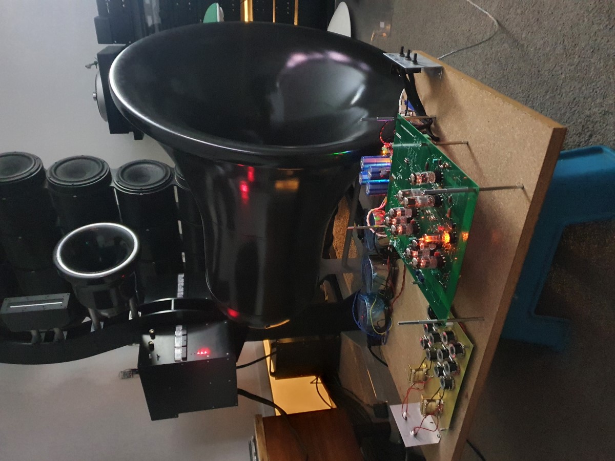

The weirdest thing just happened...the low and high output have switched sides. I had everything apart checking continuity in the cable (and various other things) and perhaps I put the cable in this time reverse to how it has gone in previous times, which because of the connectors I am using would switch the problem just as has happened now (from C32 to C53) if there was a dodgy connection in there somehow. It will even tell me which wire is causing the issue, which I obviously need to know because the cable checks out when not connected to anything.
Seriously hopeful right now...
Eureka!
Marcel, I apologise for making this build seem so difficult.
It seems all of my problems along the way were to do with connectors: first the J4 Hirose connector with the FPGA; now with a simple Molex connector between the dac and filter pcbs. The 9 pin connector on one end of the cable has a malformed hole that allows the snap in pin to rotate whenever it wants and thus lose contact. Test the cable on the bench and it is fine however you connect things, put one end on the filter board or the dac board and it tests fine but connect both ends of the cable and it loses contact because the tension of the wire causes that pin in the malformed hole to rotate. A drop of super glue has fixed things.
I usually avoid connectors at all costs prefering a hard solder joint but figured this may have been a tricky build and may have needed to plug things in and out a bit...little did I know they would be the cause of me plugging things in and out quite a bit...ha.
Many thanks to all those who have contributed to the bug finding and in particular to Marcel. Much appreciated.
