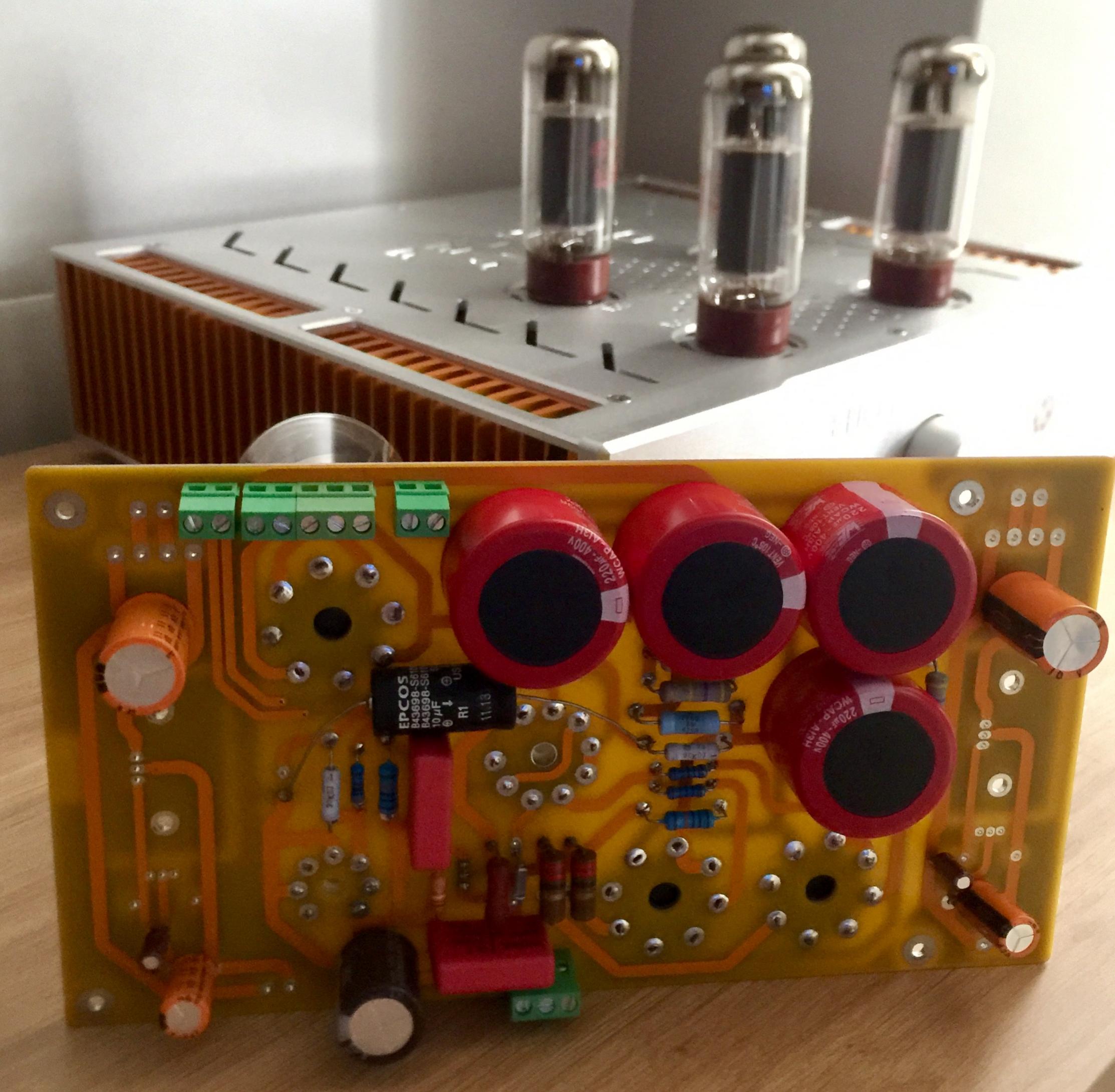

I’m a bit late due to so many other projects needed to clear out... Just got the tube voltage regulator up and running this morning. Output voltage is very stable at +300V. I need to do some modifications to get it right at -300V, should be easy.
The DAC board still misses a lot of small caps though. I’m still waiting for a suitable hardware solution for pcm-dsd conversion, don’t want to go through the HQPlayer path.

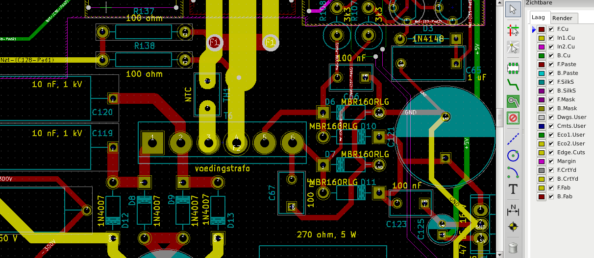

Because of a private question I got, I post a picture of connector T6, the one that's drawn as a transformer on the schematic. Pins 1 and 2 are for the 230 V AC that is used to generate the -300 V (not applicable when you have an alternative -300 V supply), pins 3 and 4 are for the 6.3 V for the heaters and pins 5 and 6 for the 6.3 V AC from which the 5 V is derived. The picture is for the raw DSD version, but it is very similar in the original valve DAC.

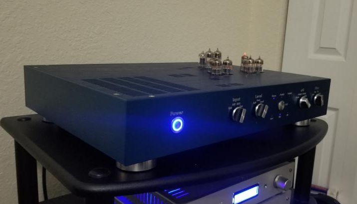

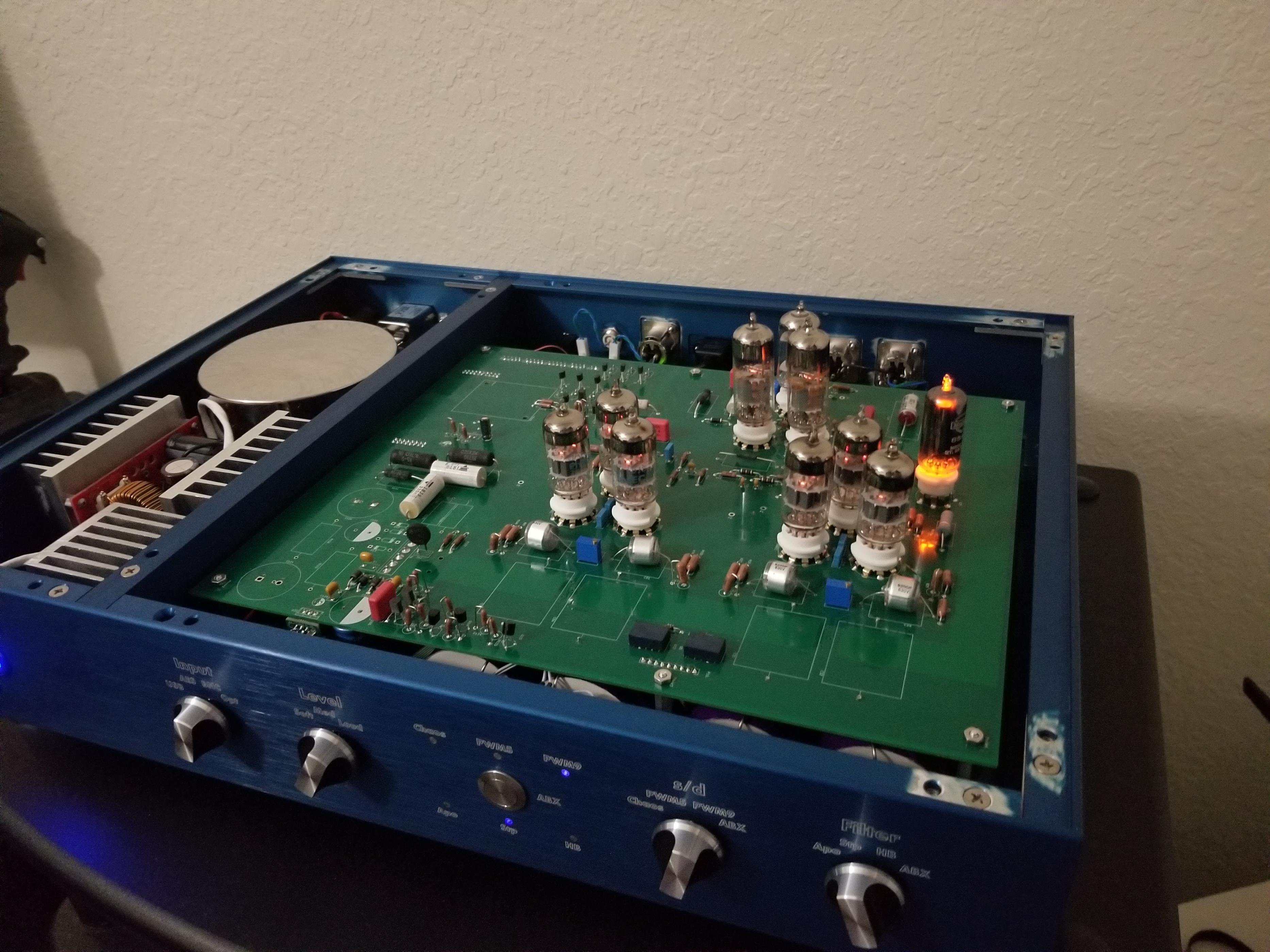

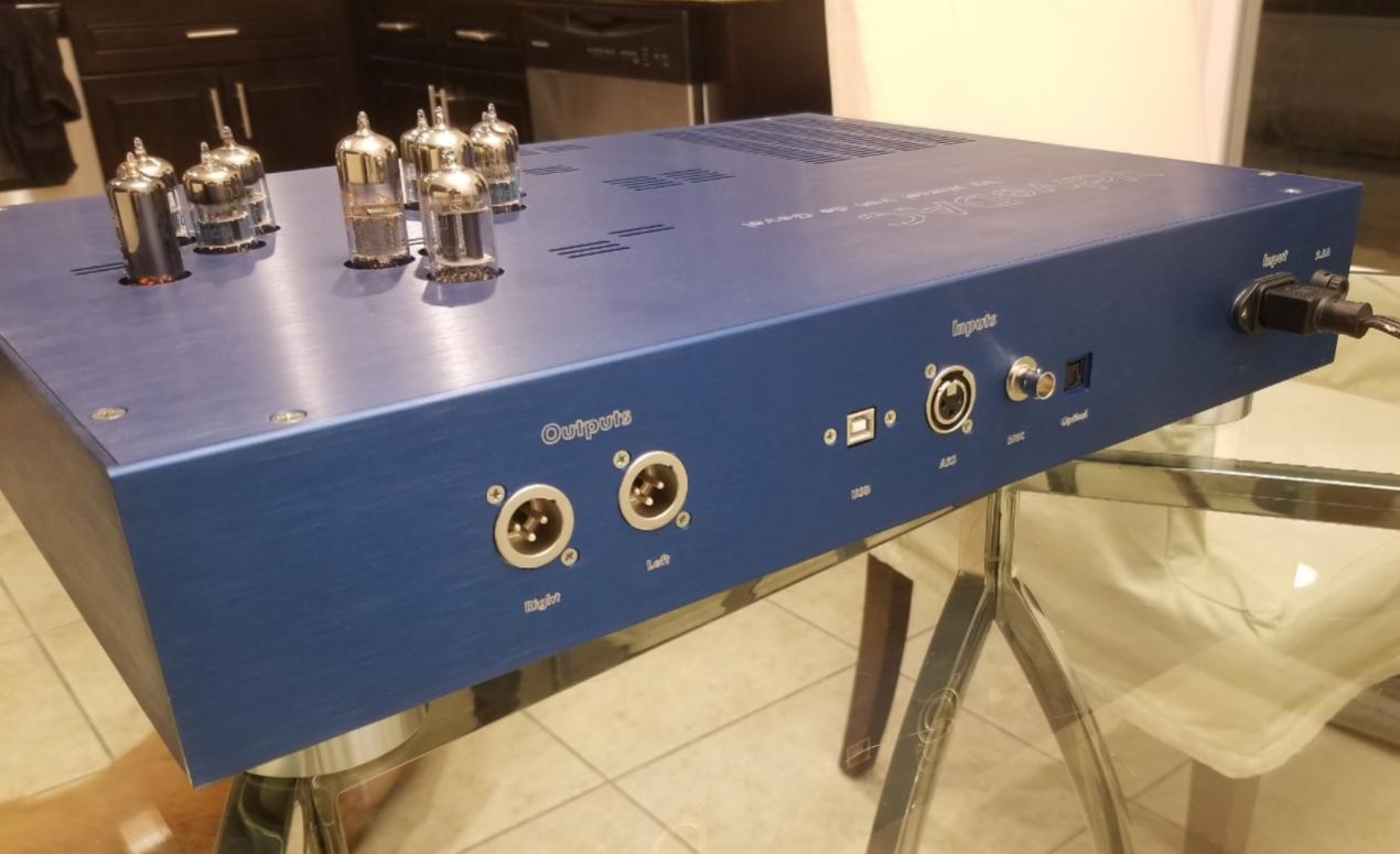

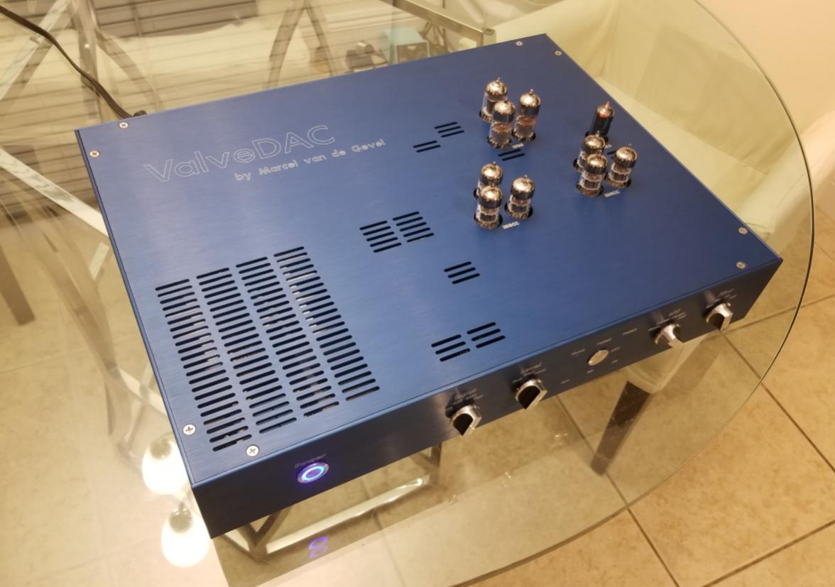

Finally got my case in and the bottom panel had an error lol. The shop is remaking it. I assembled the ValveDAC anyway but didn't zip tie wires or anything.
It sounds amazing, no pops at all. Only issue now is that my USB and Optical aren't working at all. USB card is detected in Windows, so I'm guessing I need to ground pin 3 and not rely on that mute function on the WaveIO. I have no idea why optical isn't producing sound. I'll evaluate later, just enjoying using it via BNC for now.
I'll take more pictures of it tomorrow. It's 2:30am here and I just finished getting it together, I'm fried.

I'm getting a decent amount of noise, and I noticed that my circuit ground has about 25-30mV DC in relation to the chassis. I have the ground connected to chassis through a ground isolator (House GND Kit). The DAC is connected to the ground isolator using that middle pad on the filter board connected to the ground plane.
What's even weirder, is when I bypass the isolator by touching a different chassis wire to the ground, there is a little tiny spark. What could be causing voltage to leak into ground?
Ignore my post about noise. The connection from the ground of the output board to the ground isolator thing wasn't good. Still don't know why there's a little bit of voltage, but it's fine regardless. I still need to debug the optical and USB, but for now I'm just enjoying it with BNC. Really wanting some nice tubes for it now...
