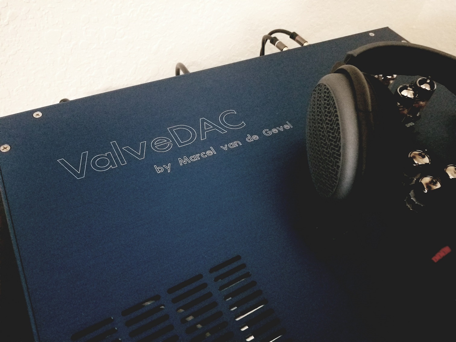

Brought my ValveDAC to a meet with tons of top tier gear, and it was one of the stars of the show. It paired beautifully with an Eddie Current Studio T and a few other amps. Had an A/B test setup comparing it to other DACs, such as the Dangerous Music Convert 2, and the common opinion was how natural the and presentation and decay of the ValveDAC sounded, without sacrificing technicalities. Couldn't be happier with it, other than wanting to put nice tubes in. Marcel, you impressed everyone at this meet, several even asked what it would cost for me to make them one lol
