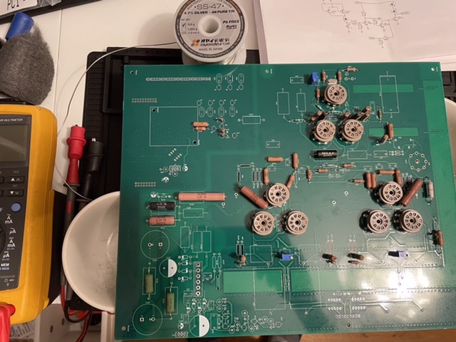

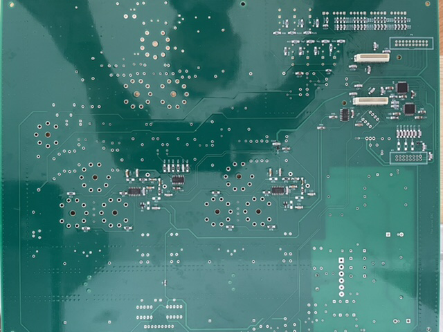

Tix88 boards arrived on Friday. Saturday evening was a good day to test the simple reflow station. Power is more than sufficient for this type of parts. Works like a charm. Like magic when all capacitors and resistors start floating and aligning themselves. So glad having this for soldering the FPGA connectors!
For those resistors directly on the clock and tube sections I used MELF and Susumu parts and went to hand soldering with traditional solder. With smd’s this size, no unsolvable problem, as long as you follow the tips on YouTube and use extra flux when needed... and have very thin tipped tweezers to handle the parts.
The FPGA module connectors and the two ICs in TQFP-48 packages are the things that are hard to solder with a soldering iron. Great that your reflow oven could do those!

Is not finished yet.... but Sunday evening was productive. With parts shortage you have to take what is available. Decided mostly for dale RN, where available 65 and E, a really tight fit! Where not available 60s and 55s D or C. Also managed to fit 1 AB for gridstoppers and avoided the string of 2 and 5 by using parts with higher rating and sufficient voltage drop capability, like mills MRA 12 with 9k1 instead of 5x1k82. Polishing all leads with fine grade steel wool not only removes some patina, makes them shiny as new and soldering very easy (highly recommended !) but also made the leads of the mills fit, tightly - but without forcing into the pad hole. Before it simply did not enter!
Mouser also delivered the LX75 as indicated in September. I have not yet checked if one can program this alone without computer guru knowledge.
Hope to make good progress next weekend solder the remaining parts and wind some coils. Will keep you posted.
