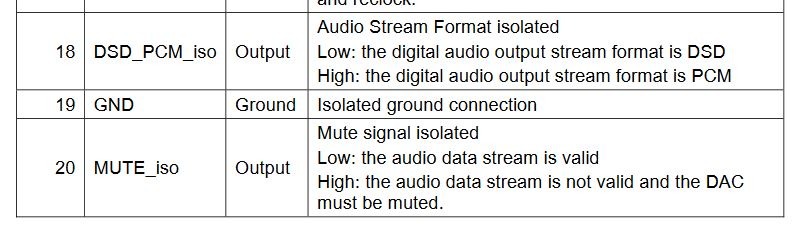

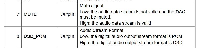

Ray, are both MUTE and DSD ON active low now? That is, does MUTE low mean the sound has to be muted and does DSD ON low mean the data are in DSD format? If so, for the raw DSD valve DAC, it should suffice to swap them. In Achim's case, one was active low and the other active high, which complicated things. Achim also used a JLSounds board, but apparently the polarity sometimes changes with the software version.
As the raw DSD valve DAC can only handle raw DSD, it treats its active-high DSD ON input as an active-low mute: when the data are not DSD, it can't process them properly and mutes its output. Similarly, an active-low DSD ON signal goes high whenever the data are not DSD, so you can connect it to the active-high MUTE input.

Anyway, for the former build I'll be using a JLSounds I2SoverUSB board (version 3) on the input but I've just had a surprise when I read the documentation - on the isolated side the Mute and DSD-On flags are both 'Lo', the reverse of those flags on the non-isolated header. As the Valve DAC requires those flags to be 'Hi' it looks like I'll have to build a small module with an invertor or, alternatively, an isolator for the 'Hi' flag outputs. I've also dropped JLSounds a mail to see if there's a firmware option too. Anyway, it's a bit of a nuisance especially as anything I have to build will likely need 3.3V power.
Lyuben has recommended just using an invertor and suggested a part number that will run on a 5V power supply so really a very simple solution. I think I will draw a simple PCB that will interface the JLSounds and Valve DAC headers and include the invertor so it should end up in a simple stack beneath the Valve DAC main board.
