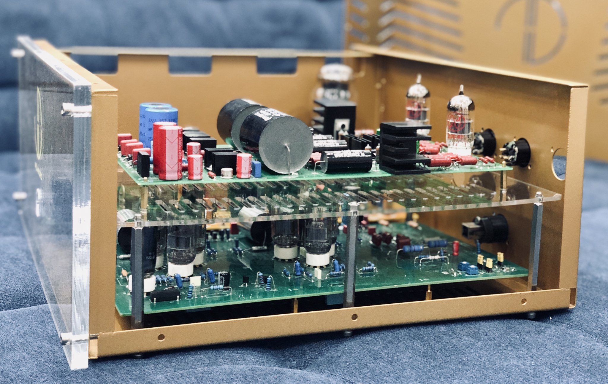

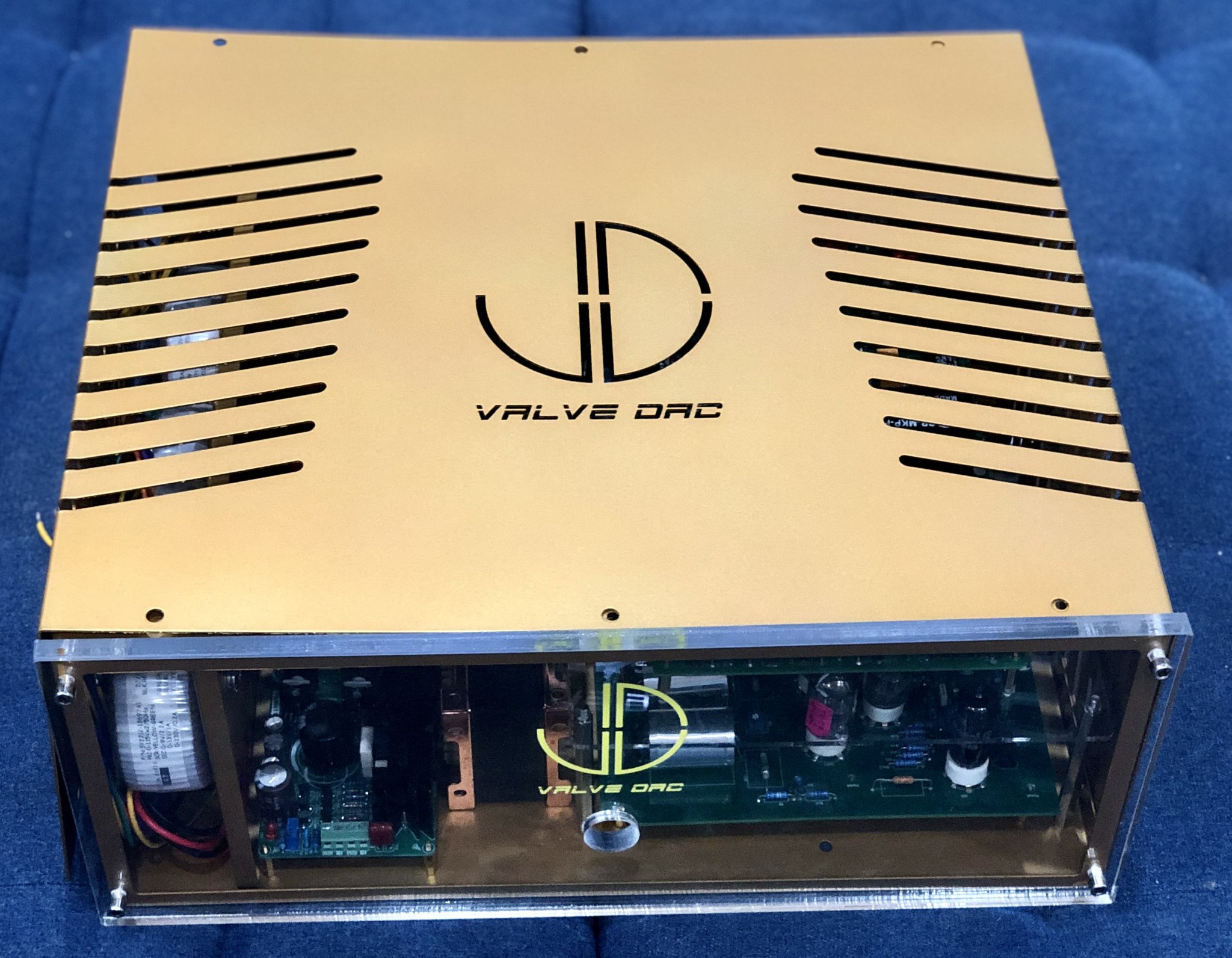

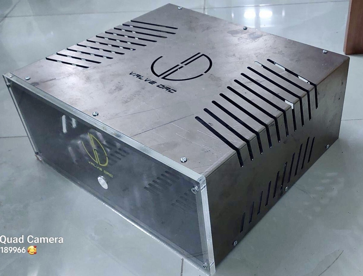

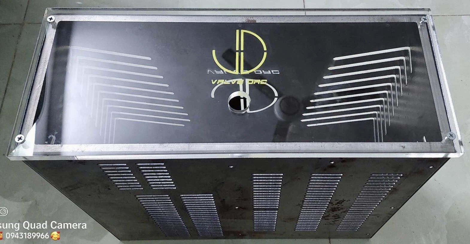

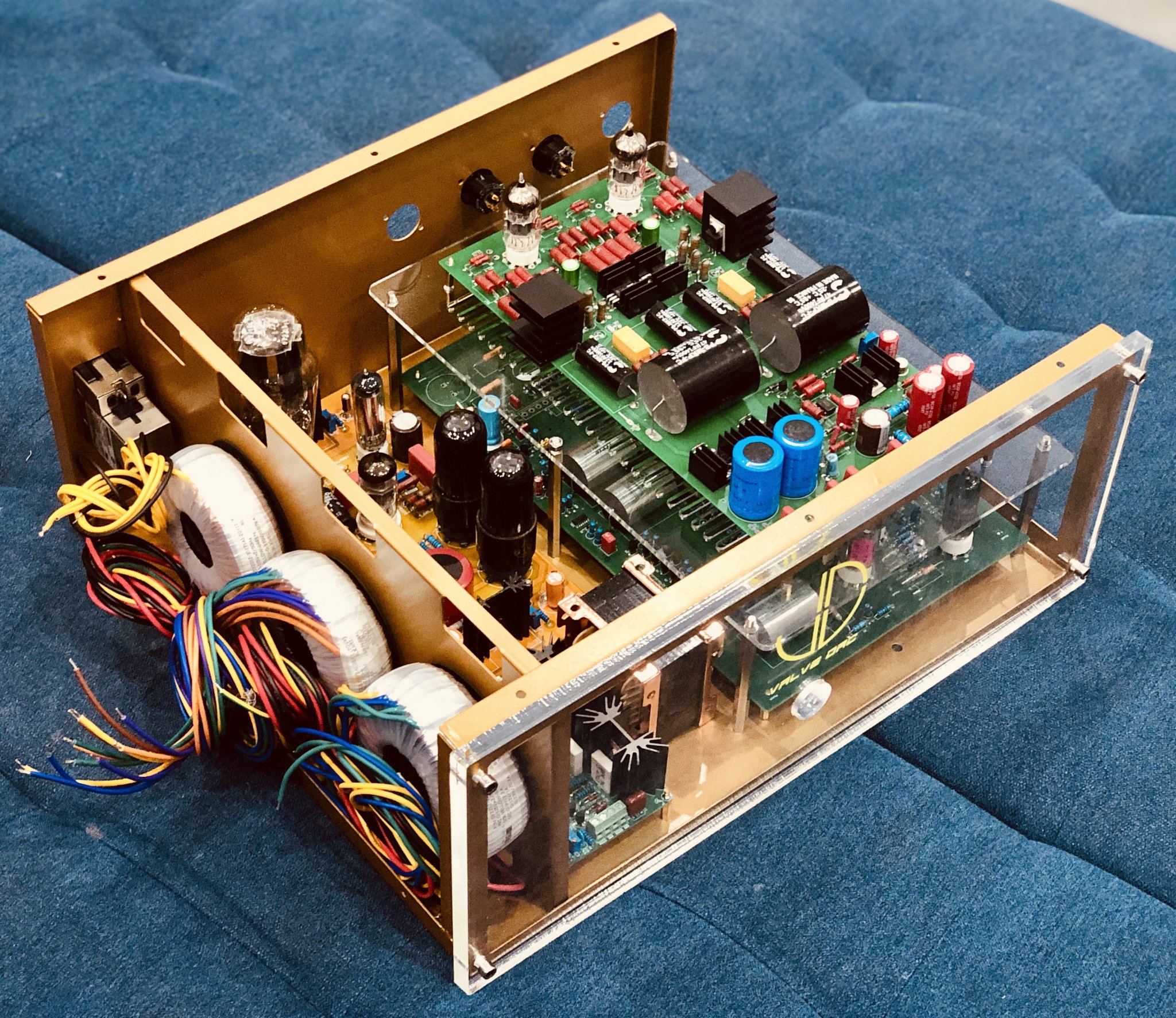

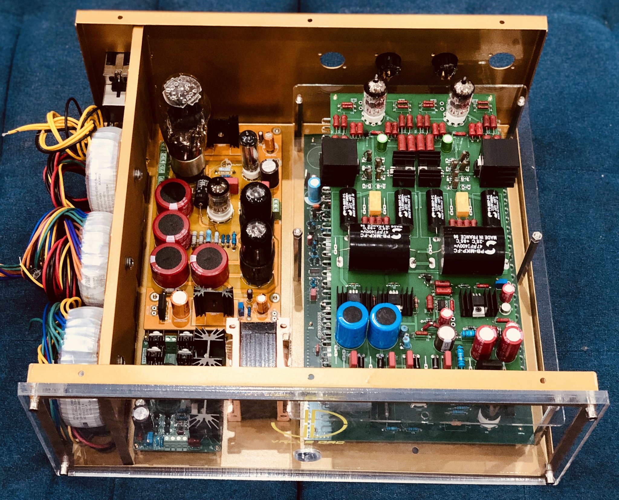

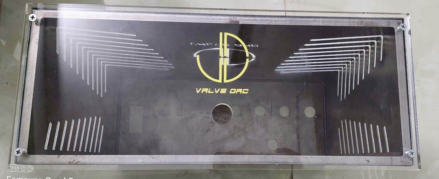

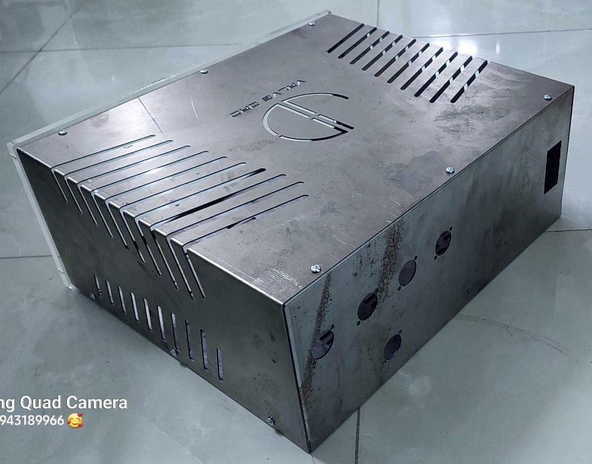

It has been a while since I received my raw DSD board and finally got some spare time in the last few weeks. Due to the high number of stuffs inside (tube voltage regulator, 5V psu, 3 transformers + 1 choke, DAC board with tube output board stacked above, Amanero/BBB), I had to design the chassis from scratch and got it done at my friend’s factory. Quite large one (430mm x 360mm x 170mm) with transparent acrylic front panel so that I could enjoy all the tubes inside. Still haven’t decided yet on the color though I’m leaning to gold.

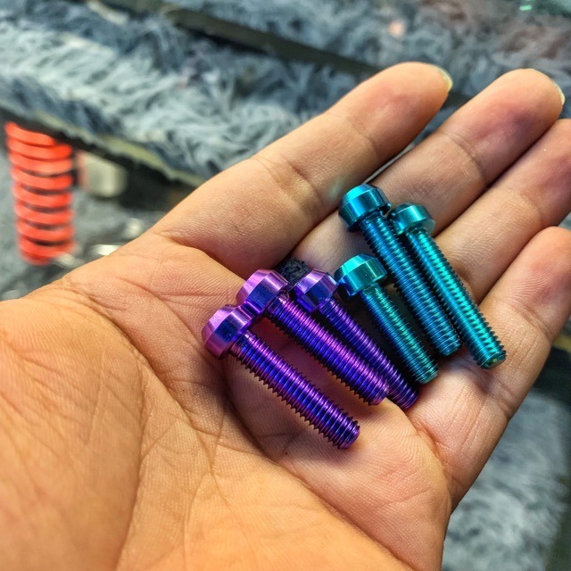

Very nice chassis. Are the screws temporary, they let it down a bit IMO. It would also look good if you illuminated the front panel, like this;

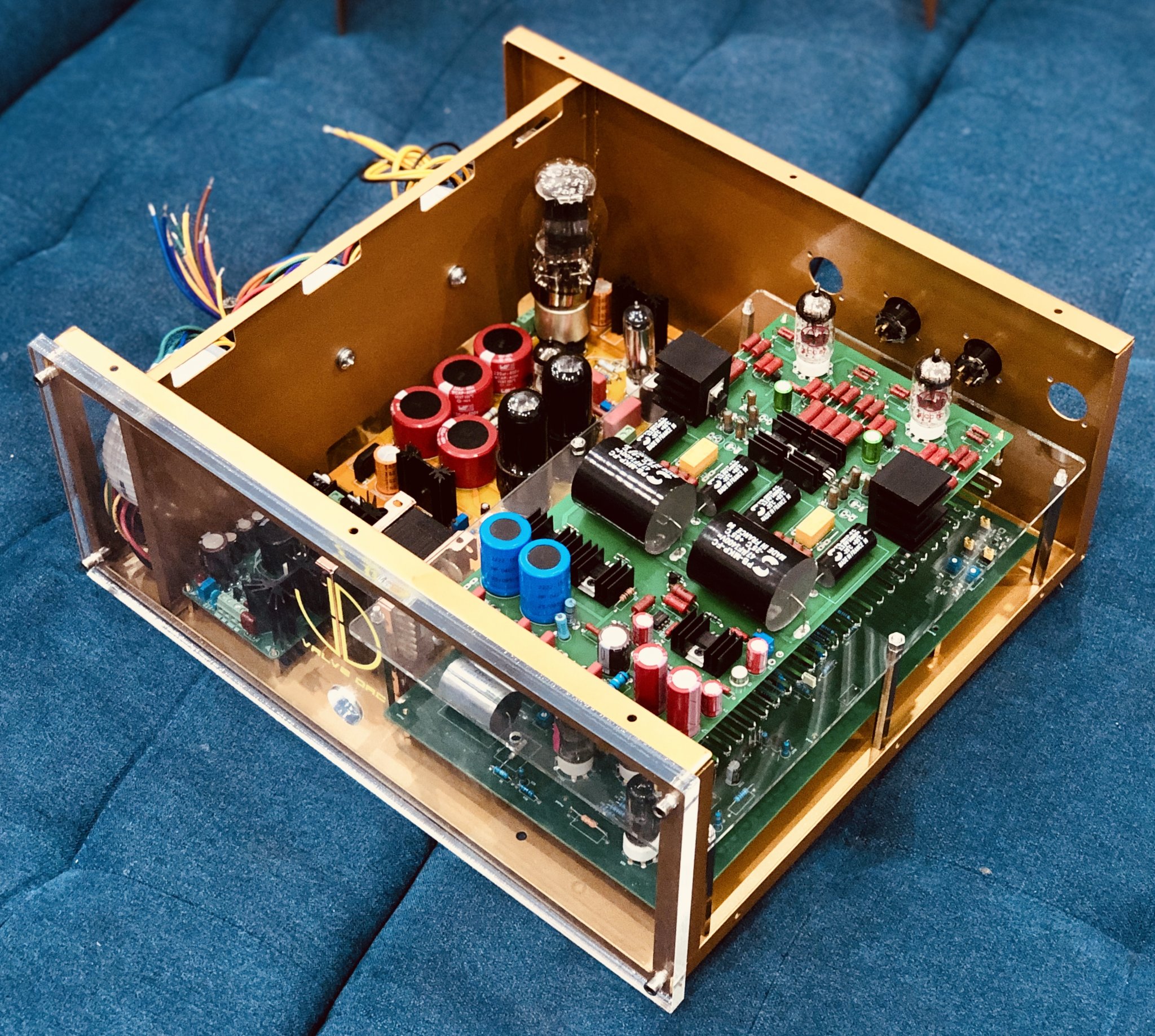

I got the chassis painted gold and quickly assembled the stuffs inside. Easily the largest and heaviest DAC I’ve ever built. The output stage is stacked above the ValveDAC board. The Sigma11 PSU is meant for the Amanero/BBB which I haven’t installed yet.

Beautiful build! What output stage is that?I got the chassis painted gold and quickly assembled the stuffs inside. Easily the largest and heaviest DAC I’ve ever built. The output stage is stacked above the ValveDAC board. The Sigma11 PSU is meant for the Amanero/BBB which I haven’t installed yet.

It’s a design by Andrea Ciufolli:Beautiful build! What output stage is that?
http://www.audiodesignguide.com/DAC_Output/index.html
