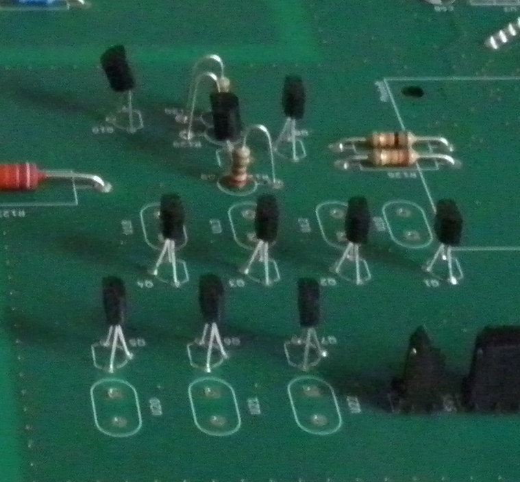

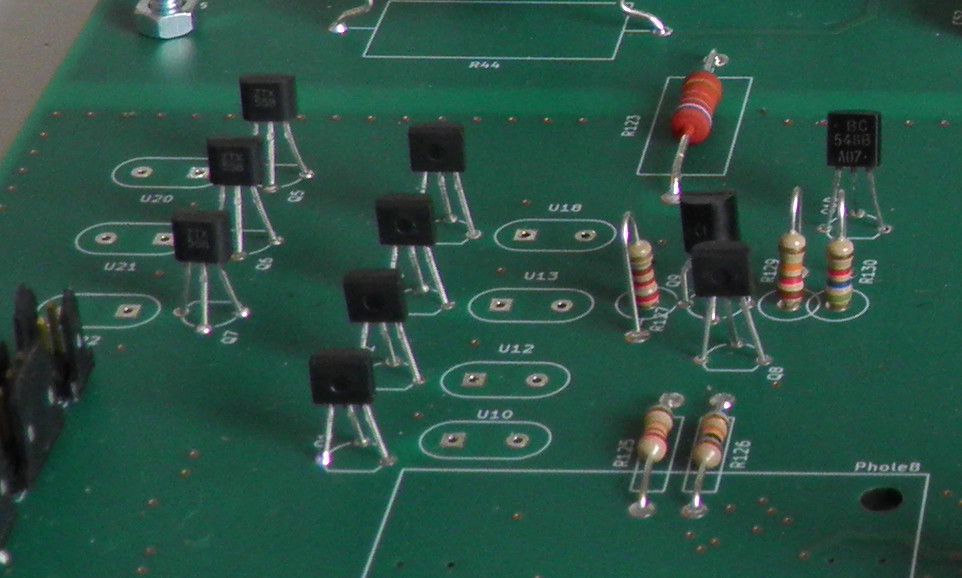

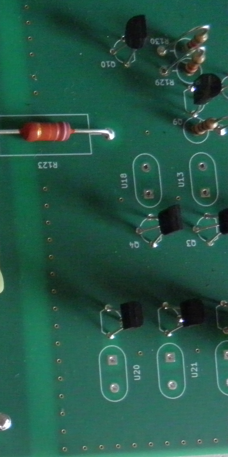

I just post a few photos because of a question I received via PM; as far as I know, you can't attach photos to PM.
