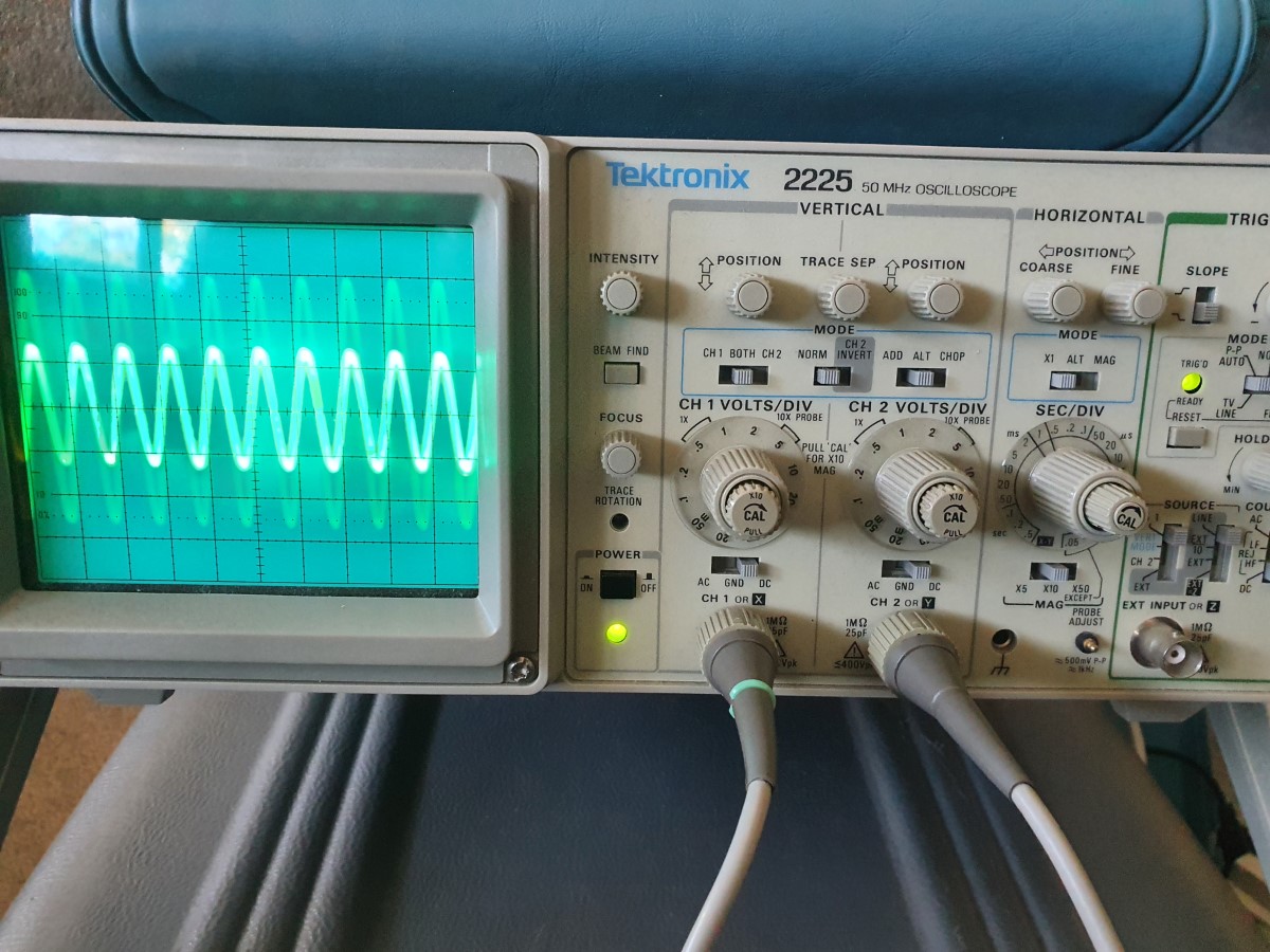

Could you measure what level you get when playing a 0 dBFS sine wave, with the negative output of the transformer connected to the ground of your scope and the positive side to the probe tip? It should be around 1 V RMS, so about 1.4 V peak.
Marcel, see the attached image. Left channel is reading about half of the right channel which is circa 2.8V peak to peak.
Initially this was reading 20mV P-P for left channel and about 40mV peak to peak for the right channel, but the filter pcb's I have here have a problem with the soldermask and are quite sketchy to solder to so after all this yanking about debugging the main pcb I decided I had a questionable joint or two so I hardwired the filter (soldered wire to the component pins/tabs). The pcb fabricator is aware and insists that the gerbers are at fault but I have not bothered following it up considering I am not using the Jensen transformer (using a Slagle OPT). Re-wiring got me my volume, as you can see in the image, but for some reason the left channel is about 3dB down from the right channel.
Am listening to Bruckners 8th right now with the preamp balance set all the way left to even the channel volumes.
Would a failed filter capacitor cause this Marcel? Given that C51 failed earlier perhaps there is one on the filter board that has also shorted. Not sure. Is also a lot more noise of the left channel than the right.

A shorted capacitor on one side of the left channel's filter could cause the reduced level, but the much higher noise would point at a short to ground before the DC blocking capacitors.

That is, a short in either C28 or C29 on the main PCB or some short in parallel with one of them would halve the left channel's signal and much increase its noise. Are the DC levels at the anodes of U1A, U1B, U28A and U28B all about the same (some -28 V)?
