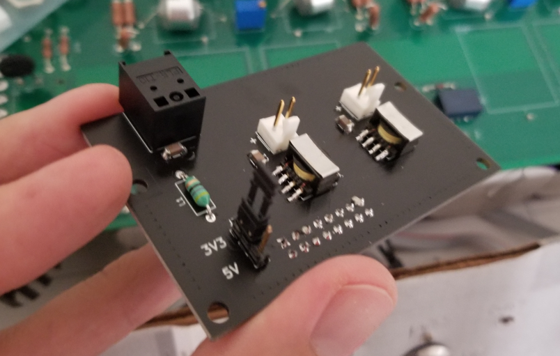

It can do 5v or 3.3v optical, then two general SPDIF inputs with isolation transformers. BNC/coax or AES is determined by the resistor on the VavlveDAC board, so the input board is agnostic. It doesn't use the RX1 set of inputs.
If you want one, I have 4 more. You can have it for free + shipping.
Sonny, can you please remind me what inputs you have on your input board?

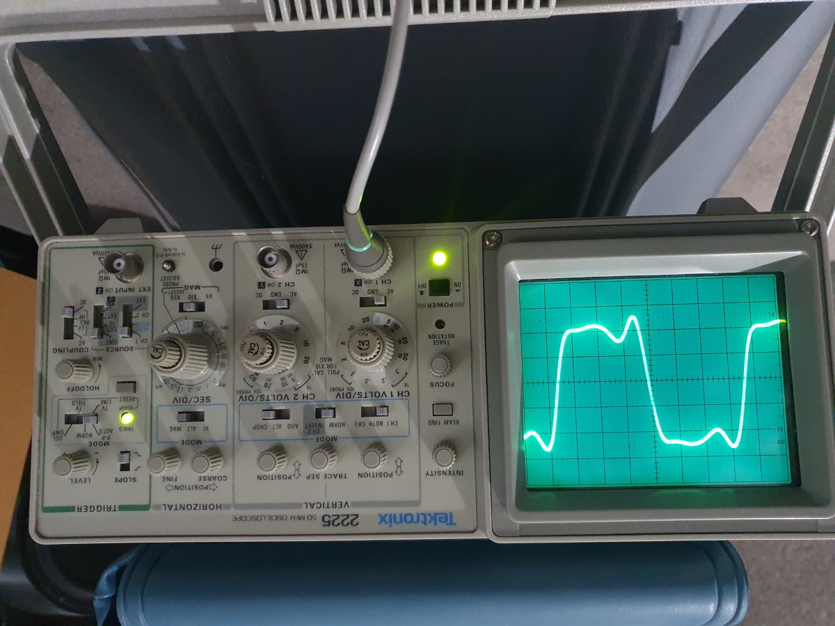

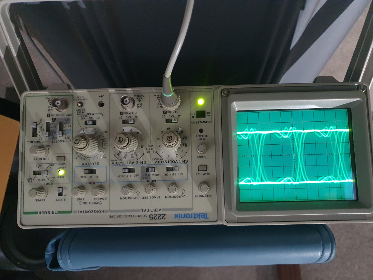

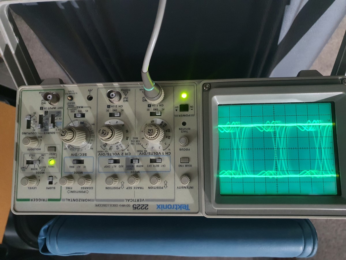

That means the sigma-delta is running in mode 0, its default mode that only produces silence.
Do you see 3.3 V across all sigma-delta mode switch contacts but one? Any illegal code (more or less than one line pulled to ground) coming out of the sigma-delta mode selection switch results in mode 0.
(I don't know by heart what other conditions lead to mode 0 and I can't look it up right now - to be continued.)
In the modes that can produce sound, the signal will look more irregular.
I just looked in my Verilog code and there are three ways to get the sigma-delta modulators into mode 0:
-Illegal code from the mode selection switch SW1
-Making sel4192 = 0 (P9 pin 1 low) and mutei2sin = 1 (P9 pin 3 high)
-Making sel4192 = 0 (P9 pin 1 low) and providing no bit clock at bcki2sin (P9 pin 9), or one with a much too low frequency (< 100 kHz)
So it can simply be in mode 0 because you selected the I2S input without providing an I2S signal, or muted the I2S input. Disconnecting P9 pin 1 should then change the mode and make the signal between R96 and ground more irregular.
Disconnected P9 entirely and I'm not sure if this is what you mean by irregular (see images - Chaos first, PWM4 and then PWM8). Looks like PWM8 is not quite right, assuming the others look suitably irregular. Will now measure the voltages in the various switch positions on SW1, then go look for some bits to make up a SPDIF input.

Assuming R64 has the correct value, the only reason I can think of why chaos and PWM4 work but PWM8 not is a lose contact somewhere in the path from SW1 contact 3 via R64 to J4 pin 62. Anyway, you will see that when you check whether there is 3.3 V across open SW1 contacts. If there is nothing else wrong, you should still get sound in the chaotic and PWM4 modes.
