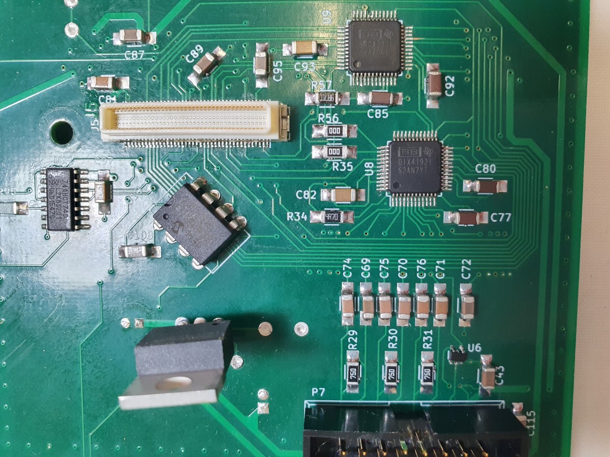

It sounds to me like you have at least three shorts to ground in the digital part, one on the src4392cclk line (supposed to be connected to J5.13 and U9.20), one on the srcdixrstn line (supposed to be connected to J5.19, U8 pin 24 and U9 pin 24) and one on src4392csn (J5.15 and U9 pin 19). Please don't power up the circuit with the FPGA module installed until those are solved, as shorting a digital output could blow up the FPGA's I/O cell.

If you can't find anything related to soldering that explains those shorts, do you also have shorts to ground on the unpopulated spare boards? Maybe something went wrong during processing due to the non-standard stack-up.
This occured to me over dinner last night. In the end I did not want to know for sure in case I lost sleep, but this morning refreshed I was unable to replicate the shorts on a bare board.
I don't know how I am going to find these shorts. All pin and pad contacts look clean under the magnifying glass. Perhaps I should start desoldering things until the shorts are revealed.
Desoldering SMD ICs is not easy unless you have a hot air station, although some forum members know tricks to do it without.
All nets that are shorted to ground are on the same side of U9, U9 pins 19, 20 and 24, while pin 18 is a ground pin. Does resoldering that side of U9 improve anything?
Had a 'moment' earlier when considering options for debugging these shorts. Would really hate to damage the pcb again in my haste and needed low-risk methods to not lose what I already have. At the time I was thinking that perhaps I buy some more bits and slowly build up the digital section on a new pcb to see where the problem occurs and then see if I can remedy the fully built up pcb. Then it occured to me that I already have a built up pcb...the one I ruined with the standoff/FPGA/impatience some time ago...so I went and checked and it seems like I have all the same shorts on that pcb as I have on this new one.
Don't know whether that is good or bad but it does mean that I have a dead board to practice on. It also means that either I have made the same mistake/s twice or that the pcb is dysfunctional (hopefully the former). Could it be as simple as incorrect orientation in the Ux sockets? This has been checked but perhaps I got it wrong both times..
Please see the attached image of the original (destroyed) pcb. The DIX on the new pcb is much better aligned than this one...
