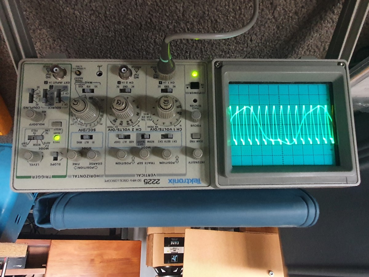

Are the CAL knobs in the correct position? If I remember well, you have to turn them all the way to the left until you feel that there is a switch switching, otherwise you get the right waveform, but at arbitrary scales.
There are also a couple of things in the circuit that could cause an oscillation at a too high frequency, but I have to start up a computer and serve a cat before I can get back to you about those.
What does the signal at R124 look like when you measure DC coupled with a 1:10 probe? How is the waveform positioned with respect to 0 V?
Does R124 make contact with J5 pin 47?

See attached waverform with 1:10 probe but AC coupled (could get no sweep when DC coupled - was not triggering). Looks like 4Vpp. Also looks more 'square'. Am not sure what is happening with the x1 probe showing circa 1Vpp and the x10 probe 4Vpp...is it simply resolution?
Not sure exactly what you mean "waveform positioned with respect to 0V, but I measured the same locations as the scope probes (between R124 and R52 and got 265Vdc.
R129 with 85A3 ignited is 3.328Vdc drop.
R125 makes contact with J5.47 pad, but the pin contact is sketchy. I'll reflow it now.

I was wondering why the clock signal was so small, it can't be due to the scope with a 50 MHz scope bandwidth. It's probably the big capacitive load from the 1:1 probe that caused it. The signal you get with a 1:10 probe looks fine. By the way, R52 is at -300 V rather than ground.
All in all, you have a good looking clock signal at R124 and the ignited85A2 signal (voltage across R129) is also fine. I'm curious to read what will happen when you have resoldered J5 pin 47.
