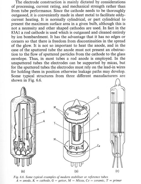

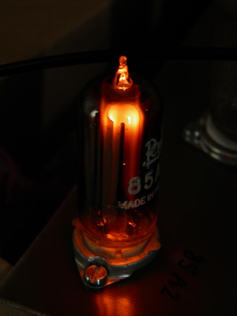

Normally you would see the cathode of the 85A2 light up, that is, the rod at the centre. With reversed polarity, the anode would light up, that is, the cylinder around the cathode. It may be difficult to see due to the molybdenum gettering, though.
For the record, I mixed up the anode and the cathode. The cylinder is the cathode and the rod is the anode, so it's the cylinder that normally lights up. Attached are a picture from G. F. Weston, Cold cathode glow discharge tubes and a home-made photo of a Pope 85A2 with relatively thin gettering.
