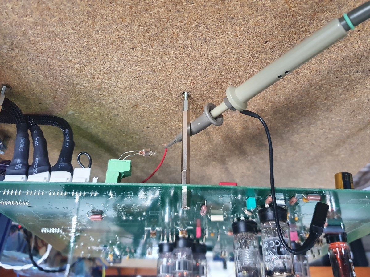

Indeed. Testing whether you see 3.3 V on all open switches and testing whether the 27 MHz clock ever reaches the FPGA module are two things you can try. Do you see a 27 MHz square wave between any terminal of R124 and ground?

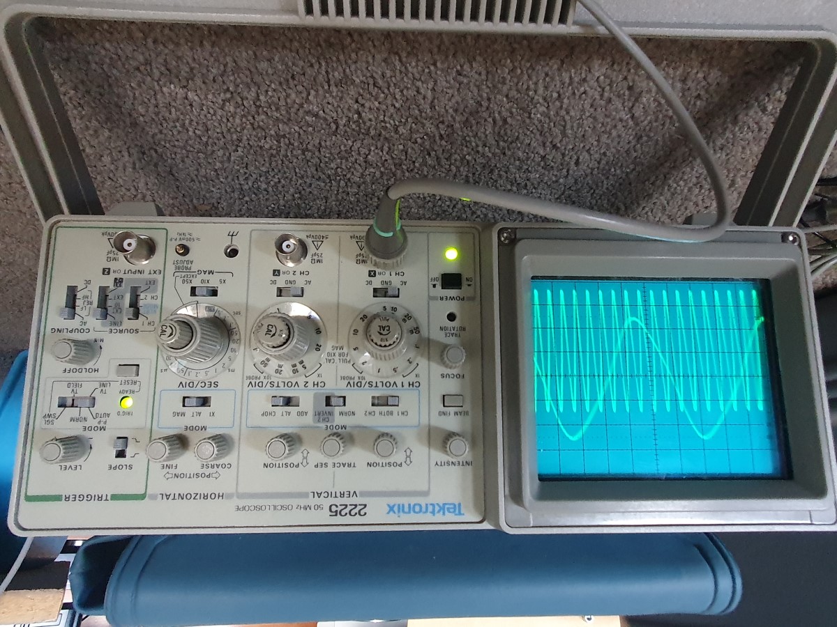

Will have to pull out the oscilloscope from storage to see if I am capable of measuring such a thing. Would like to give it a go. I have no electronics background so may not yield a suitable result.
With a scope bandwidth of 10 MHz or less, you will probably hardly see anything. With a 20 MHz scope, you will probably see something that looks more like a sine than like a square wave. With a bandwidth of 80 MHz or above, it will look more like a square wave than like a sine. Depending on the type of probe and how you connect the ground lead, you can then also get ringing at some very high frequency.
In any case, when you see a DC level that's neither very close to 3.3 V nor very close to zero with something wiggling at a 27 MHz rate, then you know it works.

Given my amateur status, I thought some context to my measurements should be included (see attached photos).

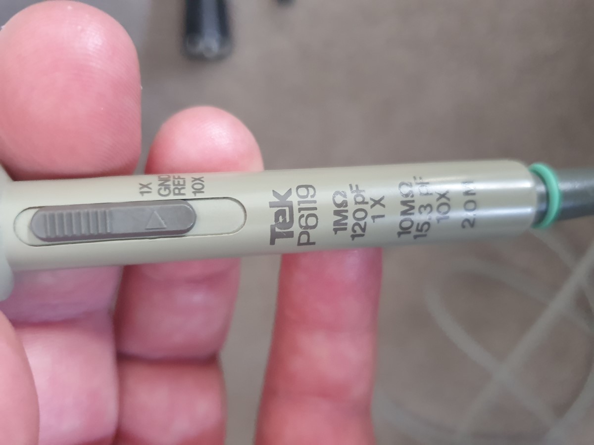

Scope is Tek 2225 50MHz. Using a P6119 probe at 1x set between the ground side of R52 and a wire solder to one end of R124. One of the images shows the traces at 0.2V/div and 0.05uS/div (magnified trace at 10x horizontal).
Look to me like the frequency is circa 36MHz and voltage is roughly 1Vpp. Note that I did this with a 10x probe (P6103) which resulted in the same frequency and Vpp.
Clock is definitely 27MHz...says so on the top of the case.
