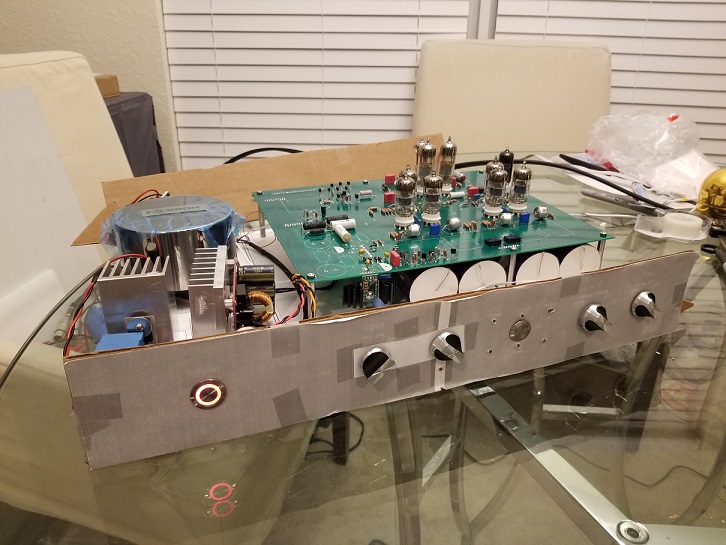

Used cardboard to mock up the case fit and hold things in place.
