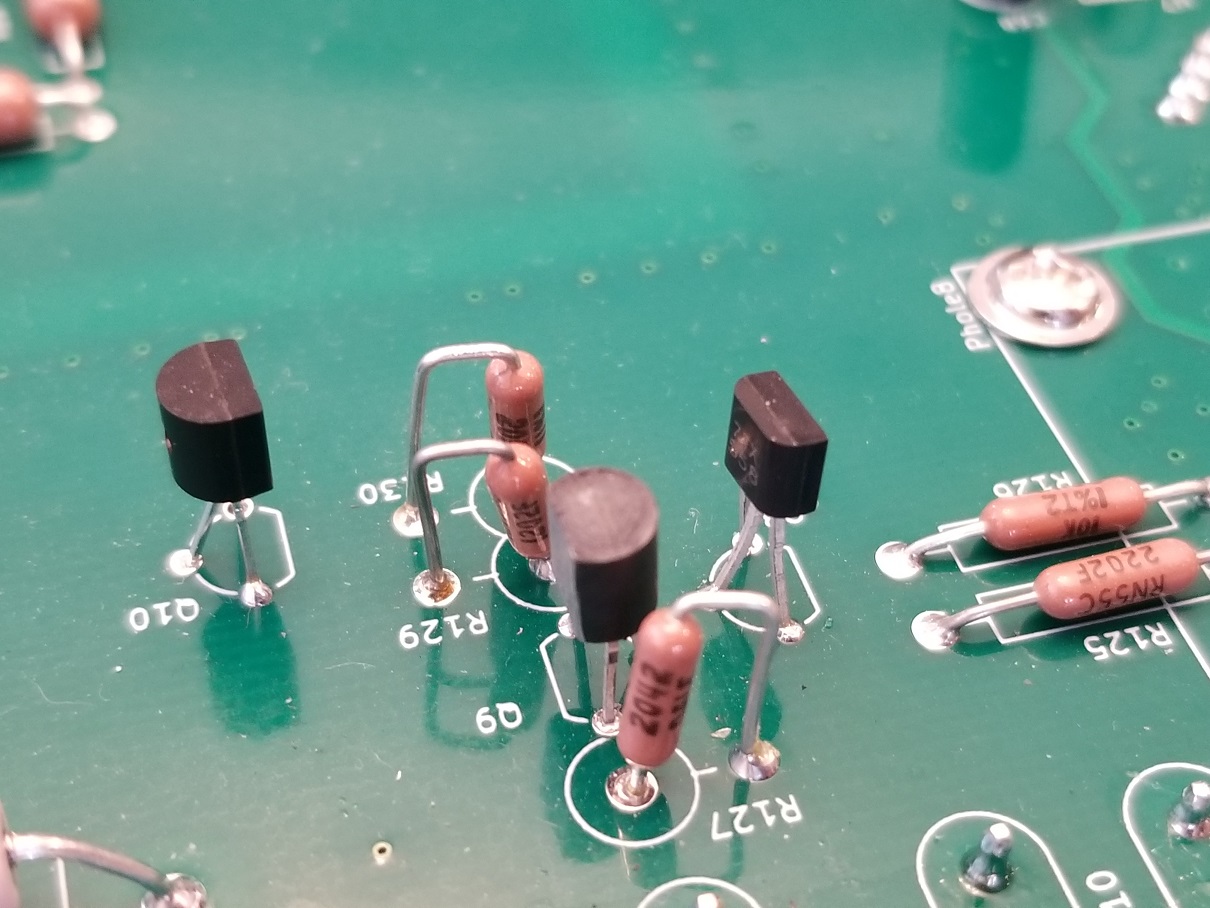

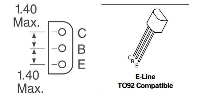

I'm wondering if my ZTX558 are backwards? The datasheet and an image on Digikey are conflicting.
I've attached an image showing the Digikey picture on the left, datasheet on the right. Mine are installed according to the data sheet, and I attached a picture of Q8.
Ok, the ZTX558 are installed correctly. I measured them with my DMM and confirmed which leg is collector and emitter (higher voltage reading on diode mode on emitter side?). Nothing looks out of place, and I double checked all my solder joints.
