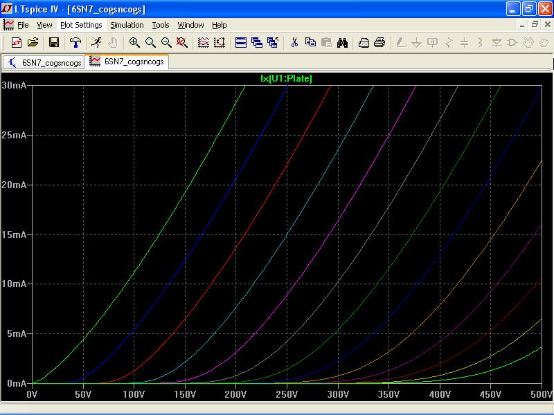

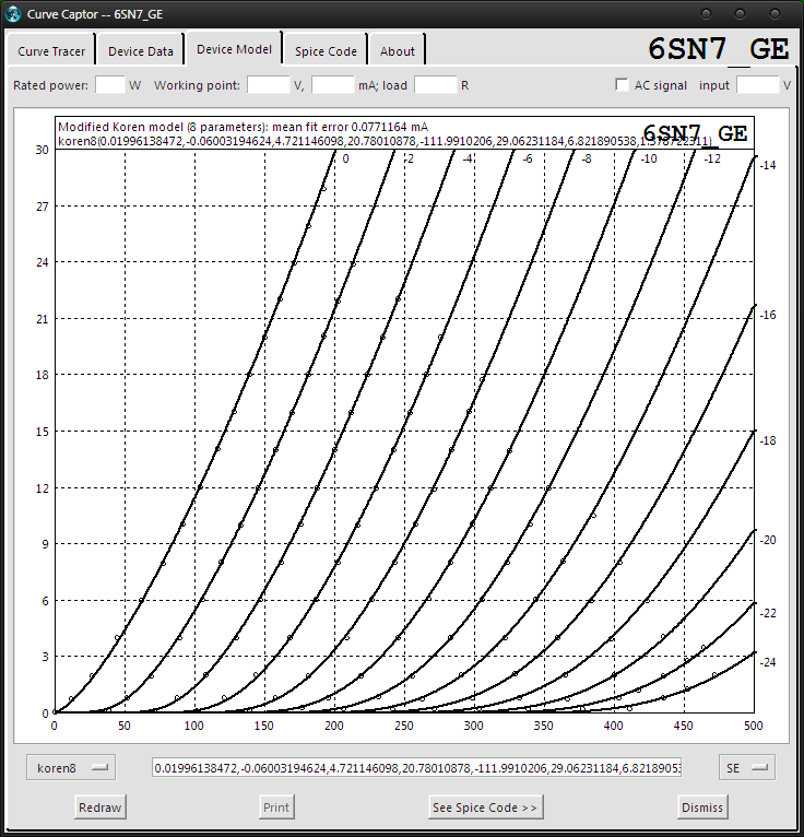

popilin, here's a 6SN7 model I made using Curve Captor:
Code:
* 6SN7_GE LTSpice model
* Modified Koren model (8 parameters): mean fit error 0.0771164mA
* Traced by Wayne Clay on 10/11/2013 using Curve Captor v0.9.1
* from General Elctric data sheet
.subckt 6SN7_GE P G K
Bp P K I=
+ (0.01996138472m)*uramp(V(P,K)*ln(1.0+(-0.06003194624)+exp((4.721146098)+
+ (4.721146098)*((20.78010878)+(-111.9910206m)*V(G,K))*V(G,K)/sqrt((29.06231184)**2+
+ (V(P,K)-(6.821890538))**2)))/(4.721146098))**(1.378722311)
Cgk G K 2.8p ; 0.2p added
Cpk P K 2.2p ; 0.5p added
Cgp G P 4.5p ; 0.5p added
Rpk P K 1G ; to avoid floating nodes
d3 G K dx1
.model dx1 d(is=1n rs=2k cjo=1pf N=1.5 tt=1n)
.ends

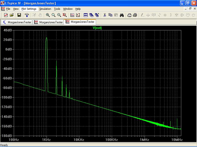

Hi cogsncogs
Good to see you around here !
Your model looks very very good, and yields about -50 dB 2nd with Morgan Jones circuit, very very close.
As usual, your models beat any other. 😉

Curve Captor is just another way to capture tube curves, latest version is here:
Curve Captor | Free Science & Engineering software downloads at SourceForge.net
I've not used it in the last few years.. (It is very good for tracing triodes and runs under tcl in windows or linux - last time I used it.) I will probably be using it again in the future.
More details here:http://www.diyaudio.com/forums/tube...be-modeling-software-beta-testers-wanted.html

You can trace directly from data sheet Plate Characteristics curves, Grid-Plate Transfer curves or enter data directly from csv, spreadsheet files etc.
Simulate load lines with calculated THD from 'captured' curves.
Model types:
Child-Langmuir law
Child-Langmuir law with contact potential
Rydel model 4 parameters
Rydel model 5 parameters
Koren model 4 parameters
Koren model 5 parameters
Modified Koren model 6 parameters
Modified Koren model 8 parameters
Outputs to: 3f4 Spice, PSpice, LTSpice and CircuitMaker.
I've ran Curve Captor on Windoze® XP, Vista and 7 without any problems. Be sure to install a Tcl package first. I recommend ActiveTcl. Install/unzip both on your system drive C:\

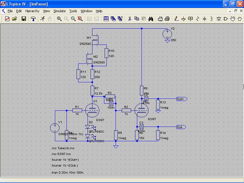

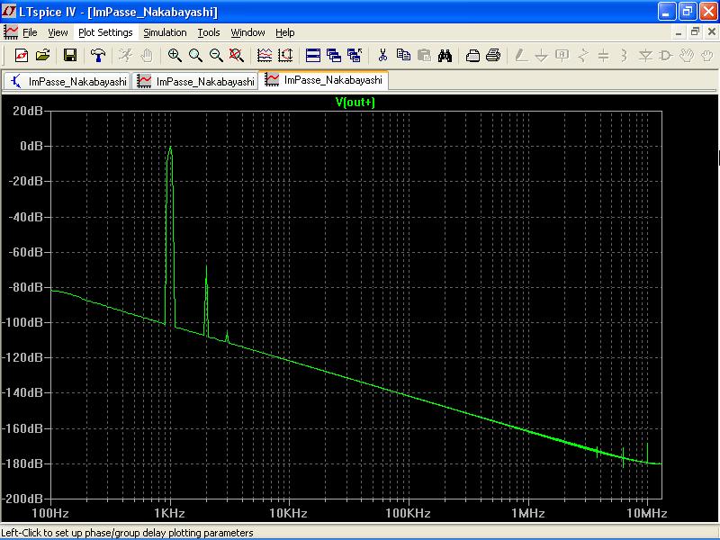

I don't find any difference with this FFT analysis -- the amplifier is basically SY's "Impasse" using the optimized Koren model, and the Ayumi model:
Does the Impasse use LEDs for biasing the bottom triode?
Never mind, found it - LEDs in the cathode.

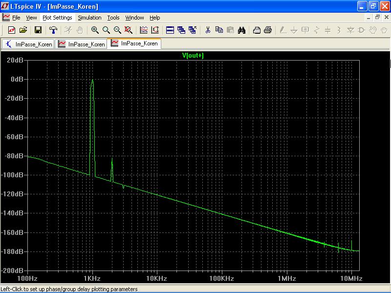

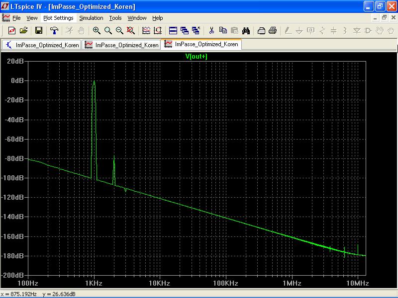

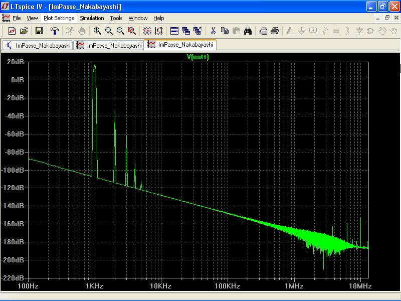

Here are the parameters from the optimized koren model -- of course there are a lot of moving parts so there are a lot of optimal solutions:
Params: MU=21.54 KP=133.1 KVB=350.9 EX=1.378 KG1=1445
I use graph-grabber for capturing data
You're kidding, right? 😀

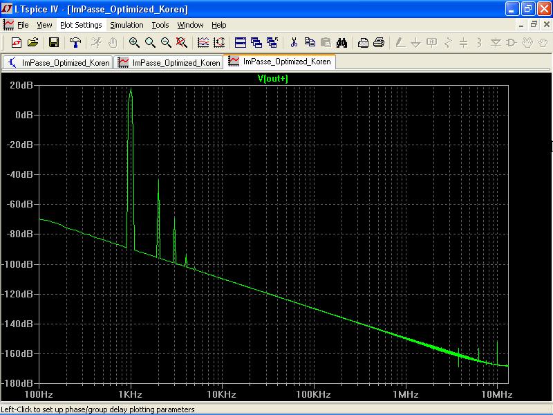

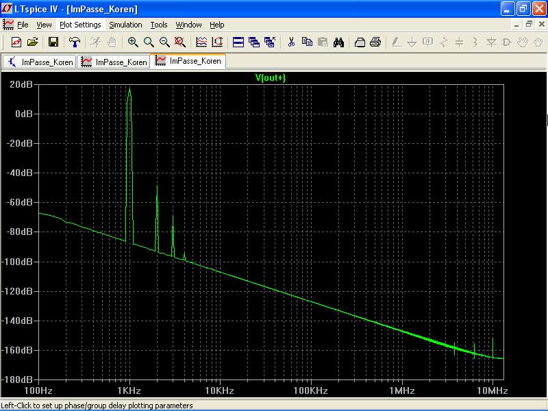

SY's ImPasse
6SN7 Koren model
2nd -65 dB THD 0.054%
6SN7 Optimized Koren model
2nd -60 dB THD 0.095%
6SN7 Ayumi Nakabayashi model
2nd -51 dB THD 0.26%
Again, with Norman Koren model, THD is close to 0.04% at 20Vp claimed by SY.
Here's what the Impasse looks like in reality:
Just look at the first stage, remove the depletion MOSFETs and assume an 8mA source @350V, and a resistive load of 1.5 meg
SY's ImPasse 2V RMS
6SN7 Koren model
2nd -82 dB THD 0.008%
2nd -77 dB THD 0.014%
2nd -68 dB THD 0.037%
Again, with Norman Koren model, THD is close to 0.01% claimed by SY.
