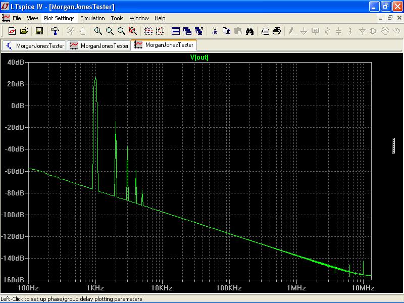

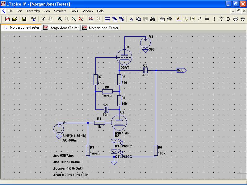

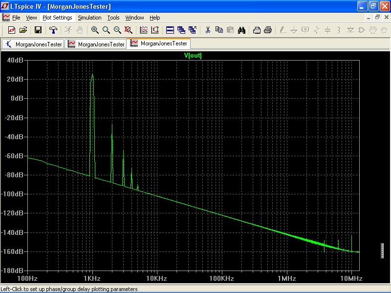

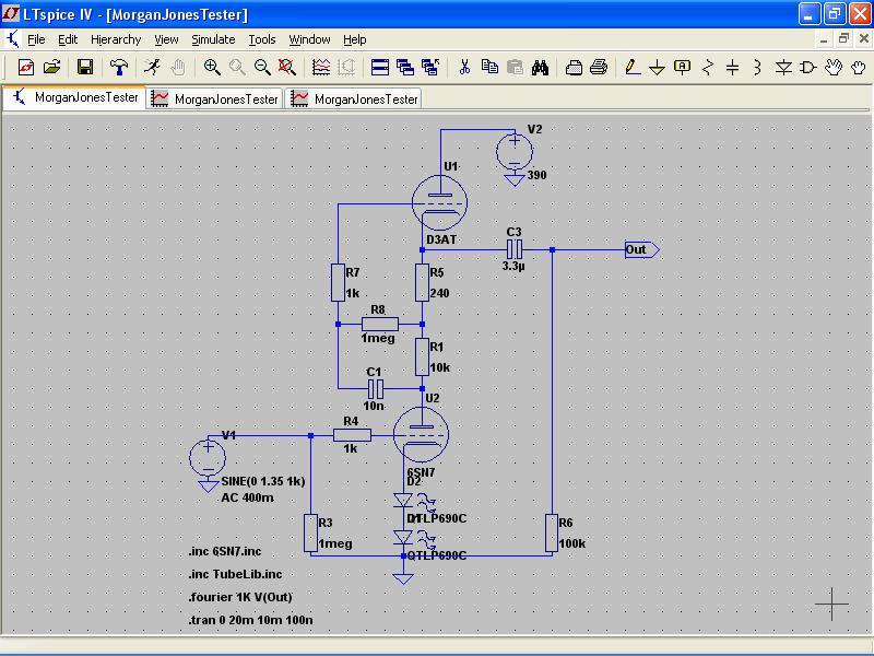

Ayumi Nakabayashi models are very accurate, I could check through the average plate characteristic curves, and average transfer caracteristics curves.
However, in simulations, distortion is 10 dB greater than with Norman Koren models.
To remove doubt, I simulated the circuit proposed by Morgan Jones, again with Norman Koren models the results are consistent (+ - 1 dB) while with Ayumi Nakabayashi models, distortion is always about 10 dB higher.
The million dollar question is: if the valves are defined by their curves, why with more precise curves less accurate results are obtained?

So 10dB more distortion vs. actual circuit measurements? Could you please post the schematics or links if possible?
Did you actually measure any of the tubes in the circuit you based the simulations on?
I typically measure at least 10dB more distortion in an actual circuit than in a simulation using the Koren models. (My latest phono stage design shows this clearly) Could it be that the Ayumi models are getting closer to the truth?
The tools I use to generate models are all based on the Koren equations. (paint_kip, paint_kit, and the uTracer alternate gui) Eventually I will learn the Ayumi method and see how that works.

I only have an old scope and a 555 based square wave generator, LTSpice is my only blind cane. 🙁
I compared the results from Morgan Jones Valve Amplifiers fourth edition, p.201, 202, and with Koren model 2nd is about -52 dB, close to experimental result, -51dB, for a 6SN7.
Same simulation with Nakabayashi model yields about -41 dB.
BTW, the D3A (triode connected) model is one of yours, and does work fine. 🙂
Does anyone have actual measurement data on the above circuit that we can use as a benchmark? Unfortunately, I don't have the D3A, otherwise, I would breadboard the circuit and test it.
Could it be that the Nakabayashi examples use multiple instances of ABM?
The Nakabayashi numbers do seem high for this circuit -51dB to -60dB would seem about right based on bench experience with a very similar circuit.
One trick is to set up the tubes with different models as a differential amplifiers and look at the output.
I don't think so, 2nd harmonics cancellation.
Edit: maybe, but you must analise 2nd harmonic cancellation, too much for me. 😀
Hi Popilin,
now I'm certainly not an expert, but I can't see in your sims the ubiquitous ".options plotwinsize=0" directive
I would suggest as well, to change to ".tran 0 100m 60m 1u" and run FFT using Hann windowing.
Maybe you can get better approximation to real life measurements this way..?
