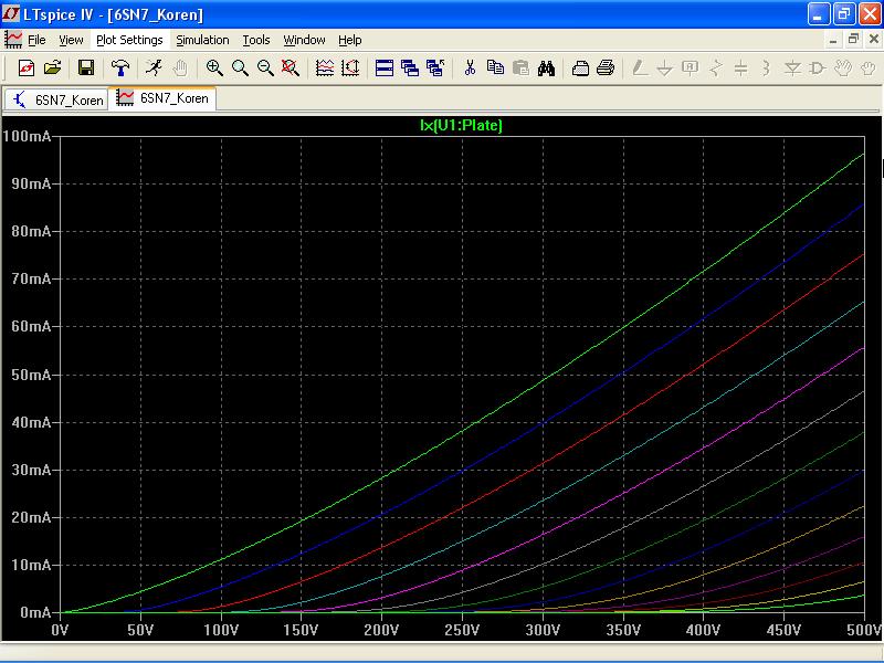

I compared the results from Morgan Jones Valve Amplifiers fourth edition, p.201, 202, and with Koren model 2nd is about -52 dB, close to experimental result, -51dB, for a 6SN7.
Same simulation with Nakabayashi model yields about -41 dB.

Eureka-The electron cloud
An increase in plate voltage correspond to an increase in plate current, following a 3/2 power law.
An increase in plate voltage make decrease the electron cloud (space charge), and the 3/2 power law tends to a straight line.
Ever I made this comment, and for some reason was not well received. 😀
Conclusion was that the electron cloud afects valve linearity.

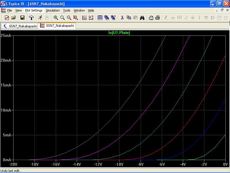

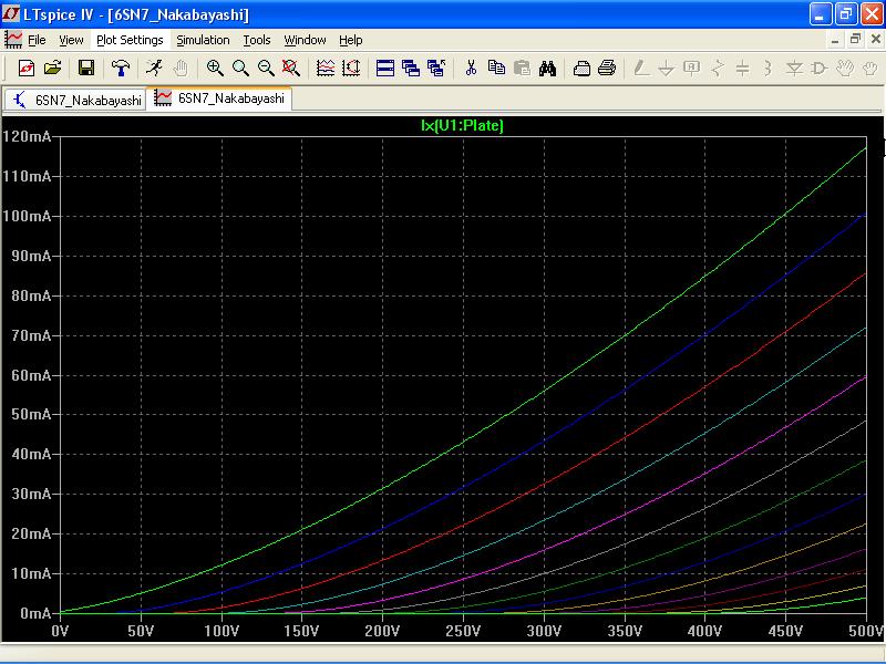

Comparing the curves of two models closely , Nakabayashi models has greater curvature in plate characteristics.
This is "as if" Nakabayashi models represent valves with higher electron cloud, from there the difference in linearity.

Puzzled still... Below is a comparison of the two models vs. the Sylvania datasheet, clearly, the Ayumi model matches up very well with the datasheet, but the Koren model nowhere close... So how can it work better in the mu-follower example? Unless it was based not on the datasheet but rather tweaked based on some actual tubes' traces?...

That's not the point, Nakabayashi models fit better than others, the issue is the curvature, look at curves posted by you, Nakabayashi curves have more curvature than the datasheet curves and more curvature than Koren models.
The difference is subtle, but enough to give more than 10 dB distortion.
Edit: Koren model curves don't look so bad as you posted...😀

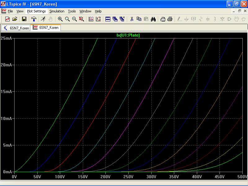

Making slight headway, the Koren model I used came from Intact Audio, that's why the curves were different from yours:

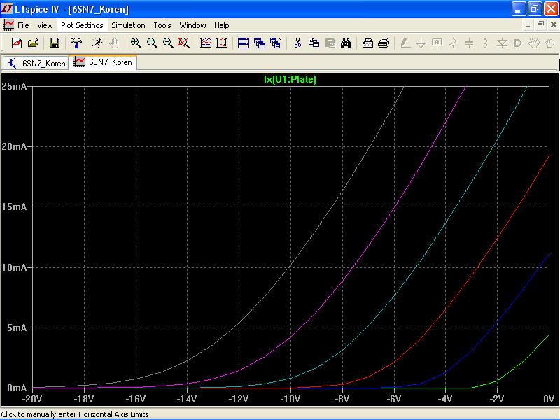

I don't have the answer for the discrepancy on THD yet, but to your point on the curvature of the curves - while the curvature of the Ip-Ep curves do have an effect on the linearity of the tube, it is not as important as the curvature of the Ip-Eg curves, or another way of saying it is the spacing between the grid curves on the Ip-Ep characteristic that makes the difference on linearity. Here again, the Ayumi's model does quite well as shown below:

I don't have the answer for the discrepancy on THD yet, but to your point on the curvature of the curves - while the curvature of the Ip-Ep curves do have an effect on the linearity of the tube, it is not as important as the curvature of the Ip-Eg curves, or another way of saying it is the spacing between the grid curves on the Ip-Ep characteristic that makes the difference on linearity. Here again, the Ayumi's model does quite well as shown below:Code:.SUBCKT 6SN7GTB A G K XV1 A G K TRIODENH +PARAMS: LIP= 1 LIF= 0.0037 RAF= 0.02 RAS= 2 CDO= 0 + RAP= 0.002 ERP= 1.4 + MU0= 19.2642 MUR= 0.006167 EMC= 0.0000189 + GCO= 0 GCF= 0.000213 + CGA=3.90E-12 CGK=2.40E-12 CAK=7.00E-13 .ENDS
Your Koren model is wrong, original Koren model is on post #151.
Ip-Eg curves can be derived from Ip-Ep curves, and follow the "same" 3/2 power law, so curvature meaning is the same.
Compare for yourself.
