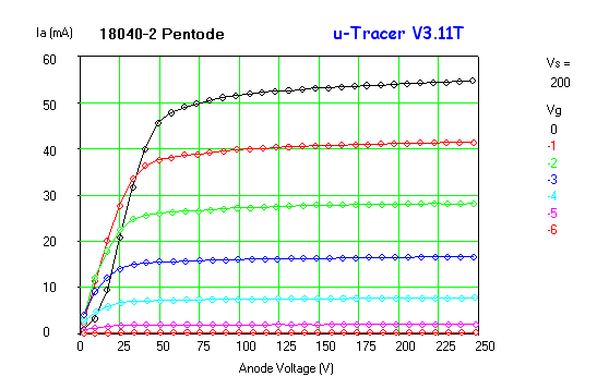

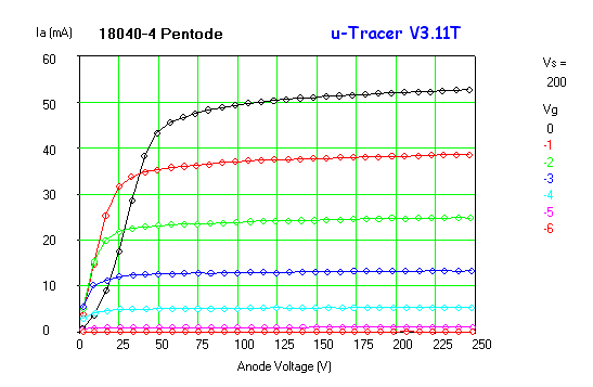

can you make a spice model for 18040 pentode with Ayumis method, please.
Lack of diagrams is no Ug1 =0 and -0.5 V.
Thank you.
I got my four samples a few days ago, and have traced them as pentodes. I'll curve trace as triodes sometime soon.
Good work Kevin. Thank you very much.
Differences in 18040_triode mode likely to be greater. With CCS and LED bias, anode voltage could be even 20% higher.
Maybe (just maybe) constant voltage source (gyrator) is a solution. I do not know, we'll see.
It seems to me that 18040 should be good as a voltage amplifier. Obviously, problem will be matching them.
