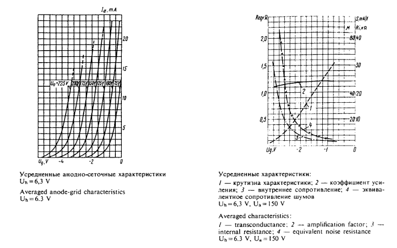

Hey Ian,
I generally run the 6S3P at between 7 - 12mA with good results.
Why so high?
Cheers
Ian
Linearity and noise performance mainly. It's designed to operate at relatively high currents (recommended up to 15mA) and linearity is not great at low currents. I also want to run them in the high transconductance region of their characteristic curves, I use them in low noise phono stages..
Interesting. What plate/cathode voltage are you using.
For my application linearity is not a big issue since the signal level is small and there is global NFB. My plan is to run it at 100V Vak, -1.6 Vgc and Ia of 1mA which still gives a gm of 20mA/V.

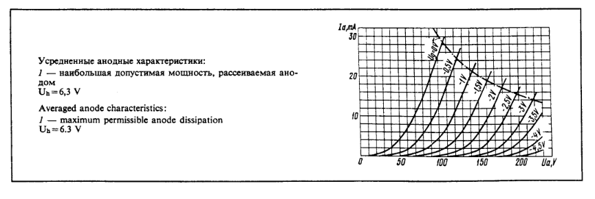

Curious, but from which Russian data-book/sheet did those 6S3P curves come from?
I have several, but the one I referred to specifically in this case is available here:
http://www.mif.pg.gda.pl/homepages/frank/sheets/112/6/6S3PEV.pdf
I do not know the specific origin of this data sheet, most Soviet era data sheets do not list specific vendors. It probably came out of some design bureau in Moscow or St. Petersburg. Russian language data sheets are packed with these tubes, complete with inspection stamp which is both on the tube and the data sheet.. (And the symbol for Reflektor, the only maker I have identified for the EV version)
Thanks! I was interested in looking at the "additional" tube info that Russian tubes seem to publish that USA tubes didn't provide.

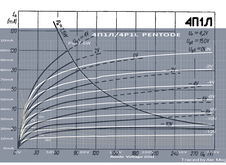

Freshly traced 4P1L with uTracer. Will create new models for triode-mode with starved filaments. Here is the Pentode curves:
4?1? / 4P1L Pentode Curves | Bartola Valves
@jackinnj , jazbo8 and all the pentode experts. Can you please kindly generate a more accurate model using your math magic?
Thanks,
Ale

mogliaa -- that's an interesting gm curve (gold dashed line) on the 4P1L pentode grid curve...typically they look more " S " like in shape: straight middle with bent over top and tucked under bottom.
Thanks,
Ale

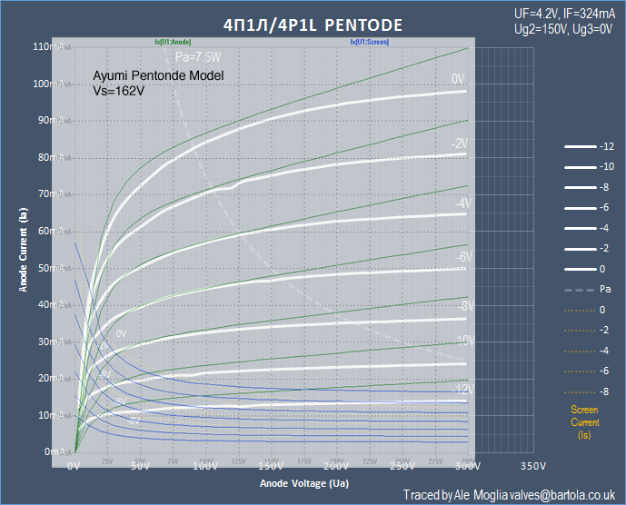

These are very nice looking curves but not quite the same as the datasheet due to manufacturing tolerance, in any case, for simulation purpose, the difference can be compensated by altering Vg2 a little bit, so the above model can still be used.
Yes, I tested 10 4P1L and all measured about 18-20% over data sheet specs. This one is 19% I believe. I took care of plotting screen current as generally is not a value available and thought it was good to have to adjust the model.

Does the Ayumi model cater for screen current? How can you adjust it?
Sorry I was not more clear, you do not need to modify the model itself, but instead make the adjustment by changing the voltage connected to the screen grid in the simulation circuit.
Thanks Jazz. I adjusted manually and got closer with Vs=162V instead of 150V. It's hard to do this manually as can't overlap images in real time. Anyway, it's not great matching.
I suppose I will have to stick to the Ayumi model then...
Fixed now. Thanks for pointing it out. Now the polynomial is of 10/11-order to better match transconductance curve.
