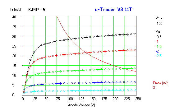

Kevin,

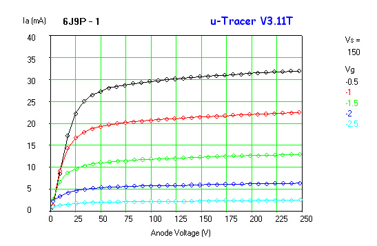

I have been struggling with this issue for sometime, while some may not agree, but I think the culprit lies in the Koren pentode model itself, which is used in both the alternate GUI (in uTracer) and Dmitry's Paint_kip. You can improve the results with Jack's custom Excel Solver routine or Robert's multi-parameter pentode model (see his post above), but I found it is easier to use Ayumi's methodology, while not flawless (especially around the knees), it can get very good matches between the models and the datasheets. I will be making a translated version of Ayumi's article on SPICE model building available once I get my PC back, hopefully soon... or you can read the original article with Google Translate, and take a look at the equivalent circuit used for the model.
I'm a little puzzled with the quality of pentode models in spice. I used the uTracer to curve trace eight 6ж9п today and selected one that seemed to match the published curves reasonably well and generated a spice model from it using the alternate gui.
Testing in LTSpice confirmed that it did not match the measured curves closely at all. Extensive tweaking over the course of several hours got me something that looks plausible, but I don't trust it.
I subsequently used the trace from one of the tubes to generate a model using paint_kip, and was able to get a good match in the tool, but when I tested it in LTSpice again the results were not great, although much better than the untweaked model I generated using the uTracer.
Is it that these models just don't do a good job with high transconductance pentodes or as I now suspect with pentodes in general?
I did a quick sloppy trace using paint_kip and generated a model, I then added this model to my LTSpice tube library and tested it, as you can see they do not match at all. (See attachments)
Kevin,
I'm not familiar with 6Z9P, but E180F. They are very similar.
First look ..... MU=84.8 is impossible. Create a model based on MU~55 or so.
Your curves with uTracer are correct based on the datasheet.
If you atach your uTracer curves for 6Z9P only, I will try to help.

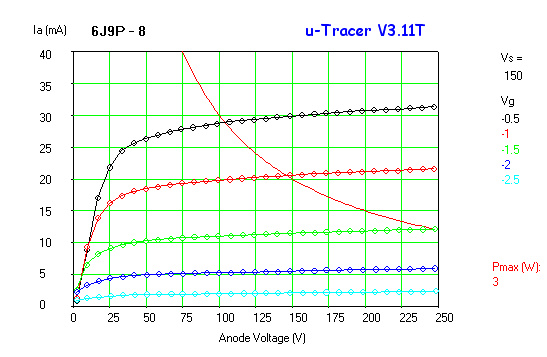

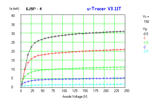

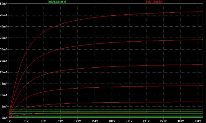

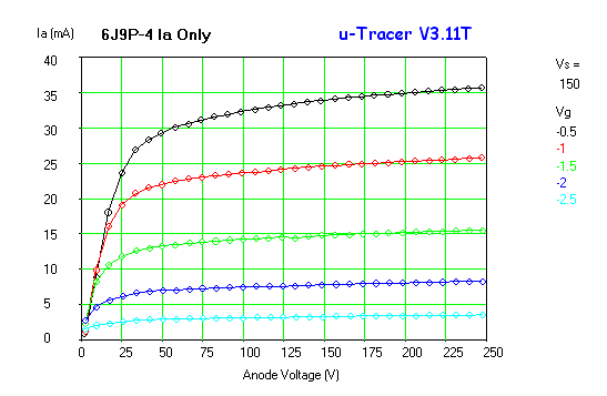

Much appreciated, here I have attached the traces of the 4 tubes that come closest to the data sheet parameters.
Edit: Interestingly enough I retraced 6j9p-4 and once again was not able to get a good fit with a mu under 80, testing in LTSpice revealed the same issue as shown in my earlier post. Changing the just mu in the model to 55 in LTSpice resulted in a good match. KG2 apparently has an effect on screen current which I am currently exploring.
Sanity check anyone: After some tweaking the following model seems to match both expected plate currents and screen currents quite well for a screen voltage of 150V:

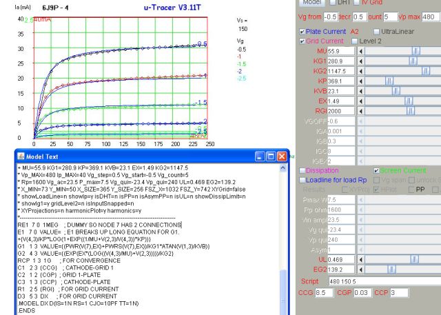

Kevin,
this is mine, done quickly and could be finalized.
Pay attention to the pinout P K G2 G1, due to a large IG2.
For me it is:
SUCKT 6J9P 1 2 3 4 P K G2 G1
Also, look capacitance values.
This is complete model:

Sorry for wrong paste, here is again

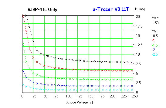

I needed to make some minor adjustments to KG2 because the screen grid current was lower than it should have been.
Interestingly enough the differences between my model and yours in LTspice were small with the exception of the screen grid current which based on the attached measurements is too low in both models. (Changing KG2 to 400 provides a reasonable approximation.)

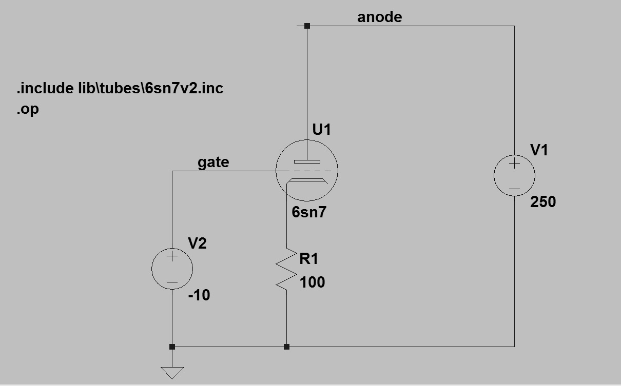

Dunno whats wrong tonight, I am getting strange simulation results no matter what I do. The curren tfrom V1 is always 1A, and nothing I do will ever make it change...is there something I need to adjust using these models? circuit as in attached picture, here is the netlist:
XU1 anode gate N001 6sn7
V1 anode 0 250
V2 gate 0 -10
R1 N001 0 100
.op
.include lib\tubes\6sn7v2.inc
.backanno
.end

Found a space in the model were there shouldn't have been one.
Here's the corrected model:

Looks like you may be trying to sim the curves for your 6SN7 model. If so here's the file I did LTSpice using your model.

many thanks cogsncogs!! Will try later today... In fact I was so desperate I tried another schematic that simulated fine in the past, and it still did - couldnt see the forest for the trees anymore, so many *** and ^^^ .....
again, many thanks!
@kevinkr: tried that , no difference. I think it is due to what cogsncogs pointed out. I should have known as I used Ayumi's models before, but I did not remember..... thanks anyway!
