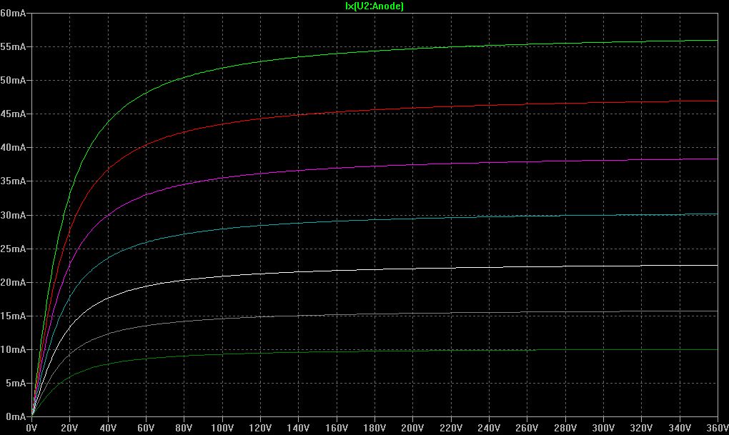

As close as it gets, here is an UL characteristic for the Russian 6P6S:
Params: MU=11.19 KP=37.5 EX=1.5 KVB=8.0 KG1=3430
6P6C

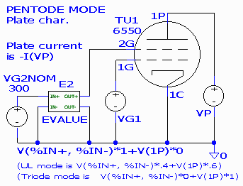

Dumb question, how do you plot UL characteristic in LTSpice?
A transformer model probably won't help since you're plotting the DC Transfer Characteristic -- It's probably more instructive to capture the data from the data sheet and plot the load line. From the load line you can make calculations of THD%

Plotting UL characteristic with SPICE, is easier than I thought, this is the basic setup from Norm Koren.

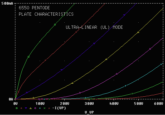

The GE datasheet does not have the Eg2 at 300V, so I am puzzled why Mr. Koren said the following in his article.
Pentode, triode, and UL mode plots for the GE 6550A are shown below. The 6550A data sheet is available from Frank's electron tube pages. It's gratifying to see the excellent agreement with data in all three modes.
Here is the 6550 UL characteristic from Koren's article, it very different from the one in the GE datasheet, so what gives?!

Just a follow-on to my post #54, so it turned out Koren's UL characteristic has Eg2=450V not 300V as I thought, in any case, the model looks nothing like the datasheet, so for him to say that "It's gratifying to see the excellent agreement with data in all three modes." was just nonsense. Wonder why no one bothered to challenge his claim when the article was posted back then...
Koren 6550A UL model vs. the GE datasheet:

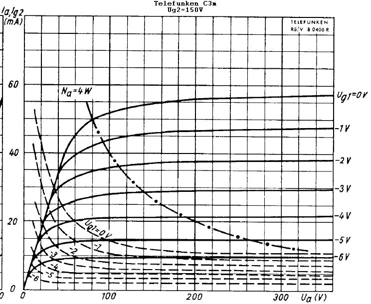

C3m spice model
Guys,
please check this model for C3M based on Telefunken data.
I made it for my personal use using a formulas from the net and final tuning with LT spice.
Thanks.
* C3M PENTODE; Telefunken data*
* Ug2=150V
* E74GD 18.7.2012.
.SUBCKT C3m 1 4 2 3 ; A K G2 G1;
+ PARAMS: MU= 19.99 EX= 1.233 KG1= 655.0 KP=115 KG2= 1400
+ KVB= 15.8 VCT= 0.00 RGI=220

Guys,
I put the model into my Excel spreadsheet -- seems to be a bit better than the "naive" model which Solver generates.
