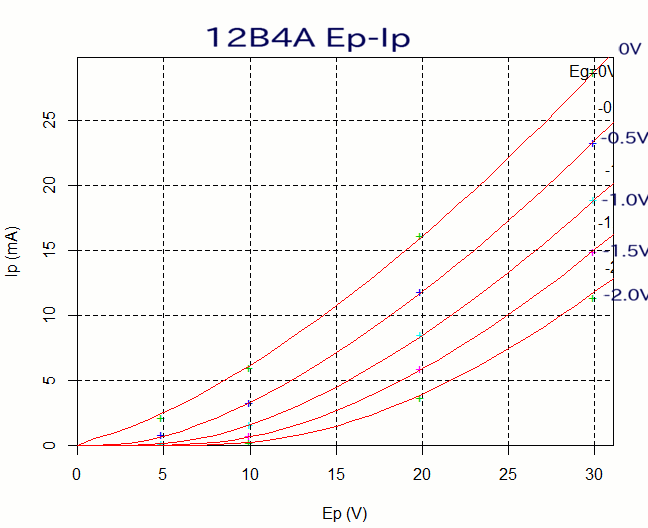

I have generated a tube model of 12B4A focused on
the low plate voltage region of up to DC30V.
My method is as follows:
Method: Ayumi's method
Ep-IP curve: measured by myself on GE's 12B4A
Obtained SPICE model is as below and Ep-Ip curve is shown
in the attachment.

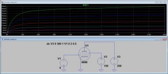

RajkoM would you mind posting instructions and screen captures here for curving tracing pentodes in LTspice - I'm not having much success and I need to vet some models I've created using my uTracer.. (I don't trust my pentode models at all, I suspect operator error due to inexperience.)
Edit: Note my source order. (Also I'm using an Ayumi tube model here, not one of the ones I generated) I just would like to see how other people do it, if different and/or if I am doing something stupid. This one looks reasonable but I have not checked it against a data sheet or on the bench yet.

Hi Raj,
I was actually thinking of the model testing protocol in LTspice rather than generating the models themselves. I have not done much testing of models prior to now and was wondering if I was on the right track or not.
My curve tracer can generate models directly from tubes I have swept, but they are only good if the ranges for tracing are appropriate. I've had a few good results with pentodes, and more than a few that were garbage or it could be that the pentodes in question just aren't very linear. Triodes are way easier. lol

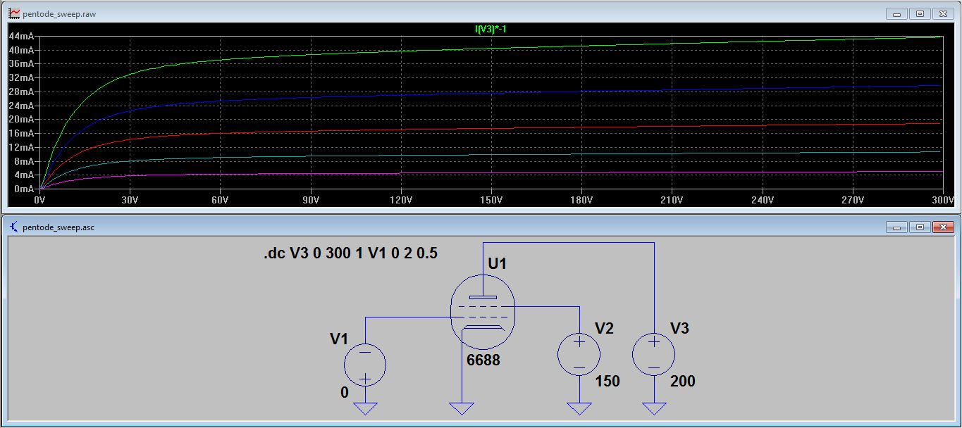

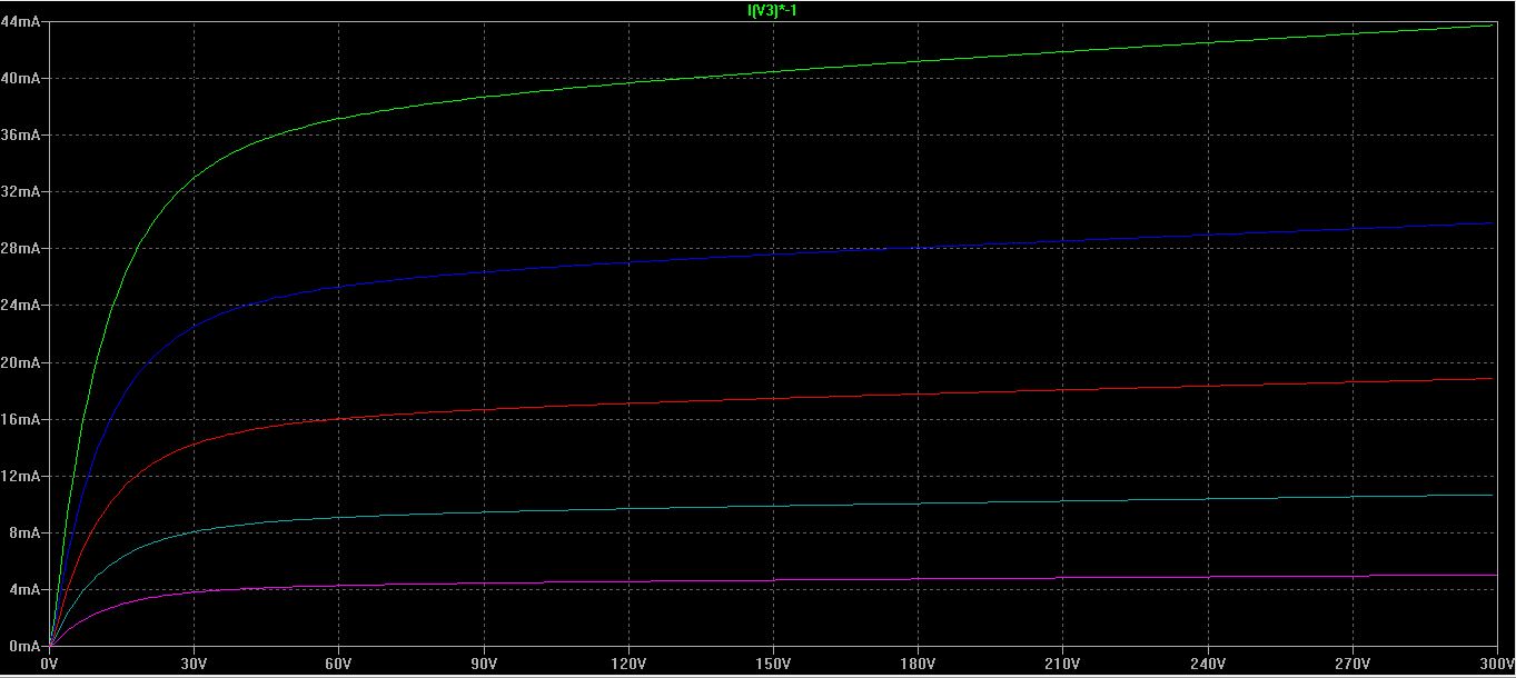

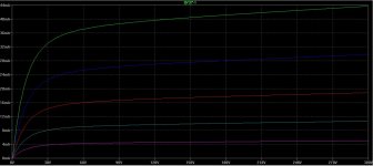

@kevinkr - The LTSpice schematic looks correct, and the curves as well. But I am not sure how your curve tracer can generate models directly... Are you using Dr. Dekker's uTracer?
In this thread, I posted a link to an alternative tube model for tetrod/pentod: Modeling and Simulation of the Power Amplifier for the RHIC 28 MHz Accelerating Cavity.pdf by S. Zheng and John Keane.
They work with high frequency, but a pentod/tetrod remain the same tube at any frequency. The parasitic caps will have more importance at high frequency, which force to use other montages, but the tube and its model remain the same. The curves they give for the 4CW150000 look pretty similar to the curves from its data sheet. That imply their model seam to be very good to modelize the tube at any Ua even when in saturation. In the paper, they give the SPICE model and how to calculate the model's parameters from the curves.

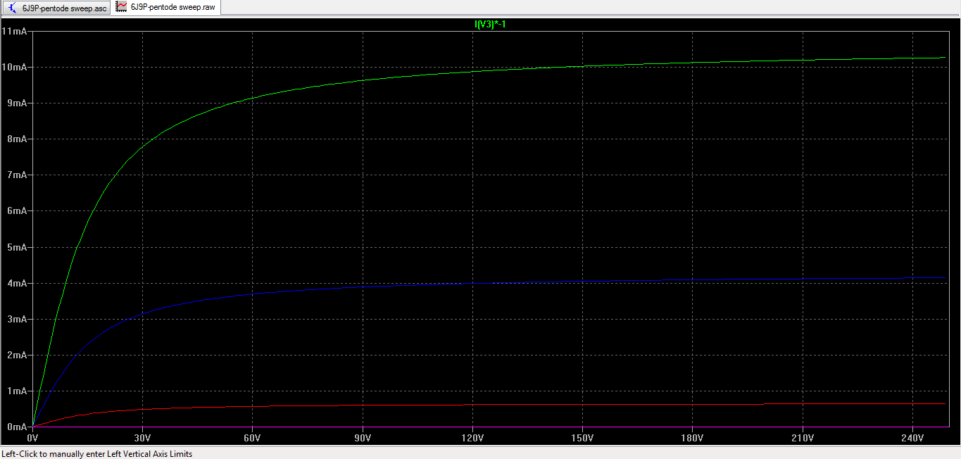

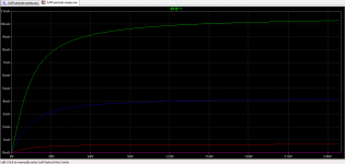

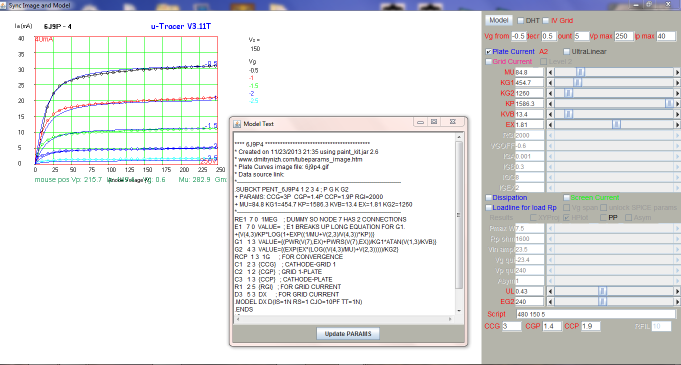

I'm a little puzzled with the quality of pentode models in spice. I used the uTracer to curve trace eight 6ж9п today and selected one that seemed to match the published curves reasonably well and generated a spice model from it using the alternate gui.
Testing in LTSpice confirmed that it did not match the measured curves closely at all. Extensive tweaking over the course of several hours got me something that looks plausible, but I don't trust it.
I subsequently used the trace from one of the tubes to generate a model using paint_kip, and was able to get a good match in the tool, but when I tested it in LTSpice again the results were not great, although much better than the untweaked model I generated using the uTracer.
Is it that these models just don't do a good job with high transconductance pentodes or as I now suspect with pentodes in general?
I did a quick sloppy trace using paint_kip and generated a model, I then added this model to my LTSpice tube library and tested it, as you can see they do not match at all. (See attachments)
