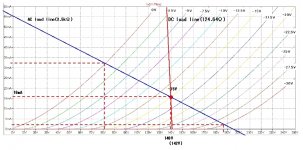

Looking for directly heated triode 5A6 Ltspice model
Dear All,
I have searched the forum in vain for 5A6 ltspice model. Is it possible to generate one based on the following data?
Datasheet with pentode loadlines, interelectrodes capacitance:
http://rtellason.com/tubedata/5A6.pdf
http://tubedata.jp/sheets/020/5/5A6.pdf

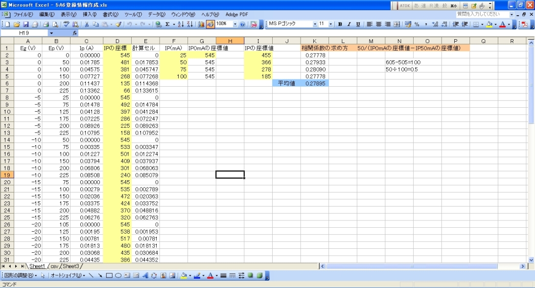

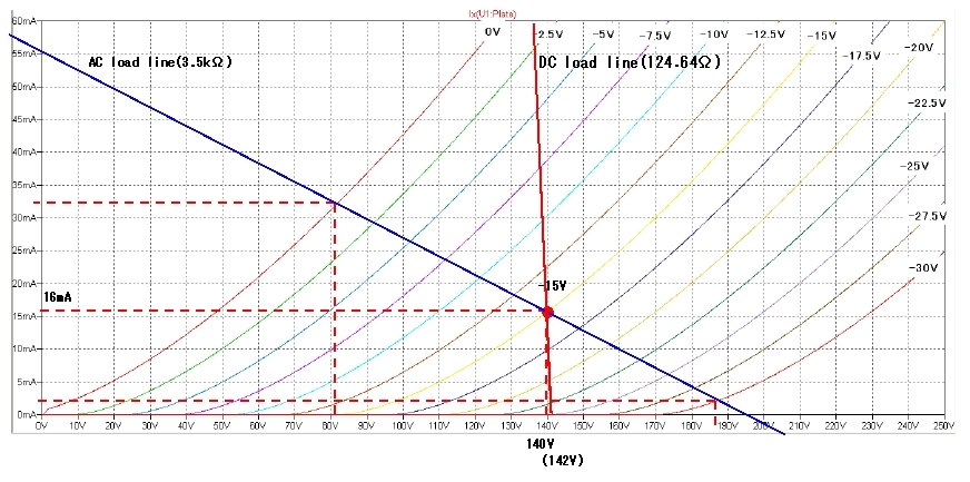

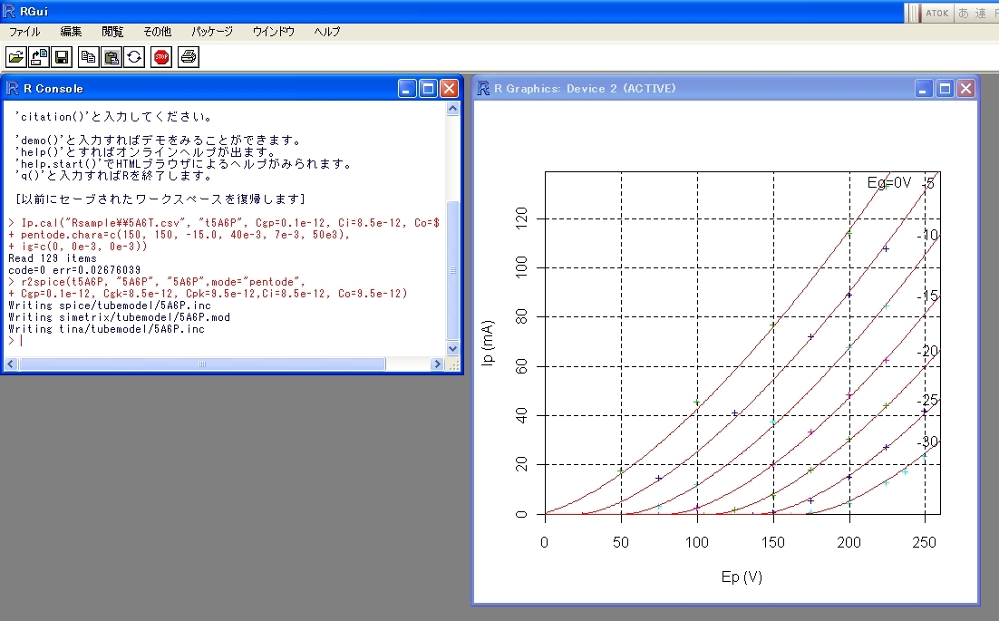

A Gentleman from Japan has made a triode strapped 5a6 loadlines:
5A6三結実測値からLTSPICEモデルの作成 ( オーディオ )
Any pentode or triode model are welcome.
Many thanks in advance.😀
Attached pictures are from the Japanese gentleman's website.

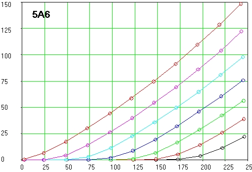

5A6 SPICE Models
Since the models are derived from a single traced sample, please do not expect high accuracy.
Triode-Connected Model

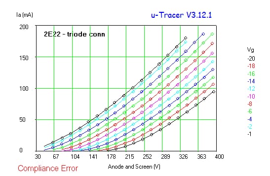

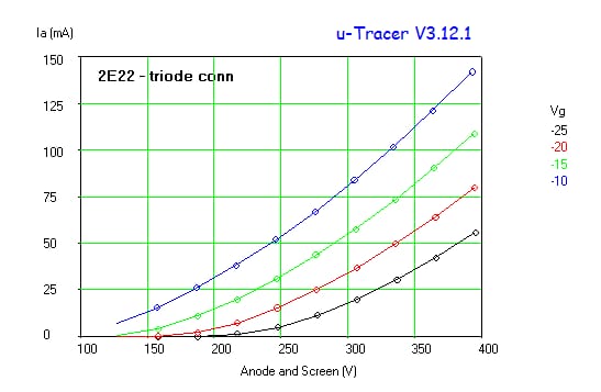

Unfortunately, the traced triode curves did not converge, so please try a different range for Vg, say 0V to -20V in -2V steps. Alternatively, since you have the uTracer, you can follow Dr. Reefman's instruction and generate the SPICE models directly.
2E22 SPICE Model
With a bit of tweaking, I managed to create the pentode model for the 2E22:

So, is there a tutorial somewhere that tells me how to generate Spice models? I hate to keep troubling the rest of you! At the moment I am awaiting delivery of a nearly 100 year old radio that I would like to restore to operation. It uses ancient tubes (triodes only) that are likely to be of little interest to anyone here. I take it that some of you use a digital curve tracer of one kind or another. In fact I see the uTracer mentioned not far above and from looking at their website I get some information. At the moment it is too expensive for my purposes. That perception could change if I do too much more tube work but for now I would need a cheaper hardware option, if there are any, or is it possible to generate the models from datasheet curves?
