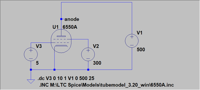

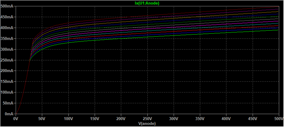

Plotting the results when sweeping multiple voltage sources
Hi. Just got around to trying this. Easy enough to setup the voltage sources.
How do I get LTSpice to plot nice plate characteristics?
I've done a lot of searching but maybe I'm using the wrong keywords.
They are not really models, just simple schematics. All you need to do in the schematic is to sweep the voltage sources on the plate and the grid for a triode. For the pentode, you add another voltage source for the screen grid, and set the voltage per the datasheets. Before you can do that, make sure you have the correct symbol for the pentode, since many SPICE models online have their pins swapped around.

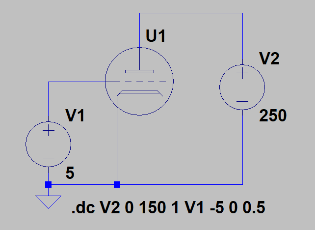

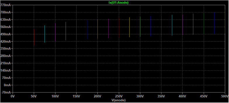

:: View topic - Generic "transient" tube curve and loadline file
Try:
.dc v1 0 500 1 v3 -5 0 0.5
This sweeps plate voltage 0-500 in steps of 1V and steps grid voltage -5 to 0 volts in steps of 0.5V. That's the order Jazbo8 had, you swapped the order of V3 and V1
