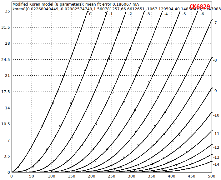

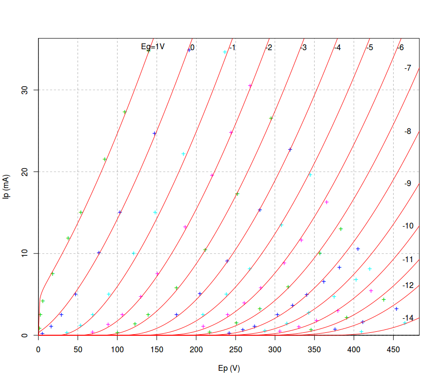

Not to take away from jelanier's post, but here's two models I just made for use in LTspice, one in Curve Captor and one using Ayumi's method... 😉
Curve Captor:
Code:
* CK6829 LTSpice model
* Modified Koren model (8 parameters): mean fit error 0.186067mA
* Traced by Wayne Clay on 06/17/2018 using Engauge Digitizer and
* Curve Captor v0.9.1 from Raytheon data sheet
.subckt CK6829 P G K
Bp P K I=
+ (0.02268049449m)*uramp(V(P,K)*ln(1.0+(-0.02982574749)+exp((1.560781257)+
+ (1.560781257)*((66.6612651)+(-1067.129594m)*V(G,K))*V(G,K)/sqrt((40.14838418)**2+
+ (V(P,K)-(9.147083081))**2)))/(1.560781257))**(1.370120586)
Cgp G P 3.1p ; 0.7p added (2.4p)
Cgk G K 3.7p ; 0.7p added (3.0p)
Cpk P K 0.57p ; 0.2p added (0.37p)
Rpk P K 1G
d3 G K dx1
.model dx1 d(is=1n rs=2k cjo=1pf N=1.5 tt=1n)
.ends CK6829
Code:
* Generic triode model: CK6829_AN
* Copyright 2003--2008 by Ayumi Nakabayashi, All rights reserved.
* Version 3.10, Generated on Sun Jun 17 20:48:19 2018
* Plate
* | Grid
* | | Cathode
.SUBCKT CK6829_AN A G K
BGG GG 0 V=V(G,K)+0.17652075
BM1 M1 0 V=(0.019871805*(URAMP(V(A,K))+1e-10))**-1.5762085
BM2 M2 0 V=(0.48761325*(URAMP(V(GG)+URAMP(V(A,K))/25.784611)+1e-10))**3.0762085
BP P 0 V=0.0047751592*(URAMP(V(GG)+URAMP(V(A,K))/52.879225)+1e-10)**1.5
BIK IK 0 V=U(V(GG))*V(P)+(1-U(V(GG)))*0.005163113*V(M1)*V(M2)
BIG IG 0 V=0.0023875796*URAMP(V(G,K))**1.5*(URAMP(V(G,K))/(URAMP(V(A,K))+URAMP(V(G,K)))*1.2+0.4)
BIAK A K I=URAMP(V(IK,IG)-URAMP(V(IK,IG)-(0.0025236727*URAMP(V(A,K))**1.5)))+1e-10*V(A,K)
BIGK G K I=V(IG)
* CAPS
CGA G A 3.1p ; 0.7p added (2.4p)
CGK G K 3.7p ; 0.7p added (3.0p)
CAK A K 0.57p ; 0.2p added (0.37p)
.ENDS
