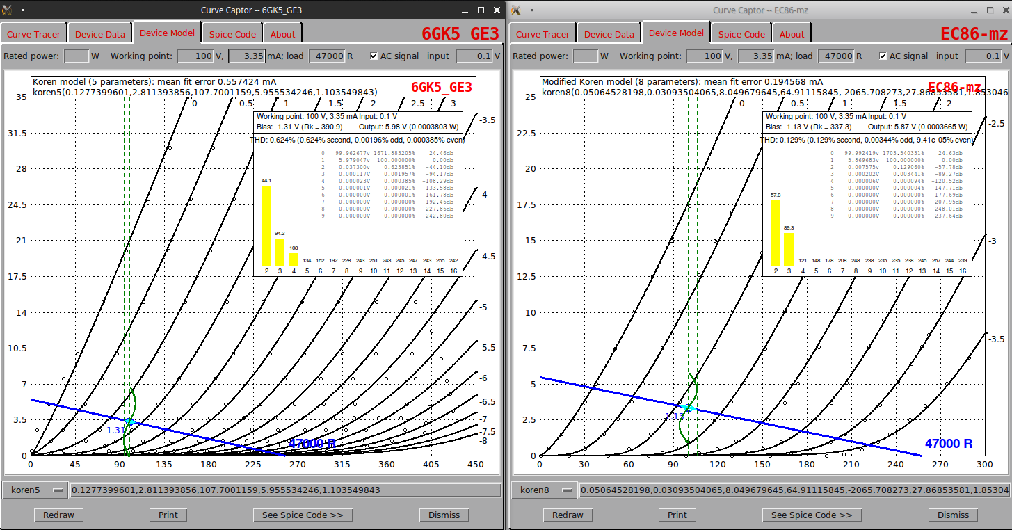

Vacuum Tube SPICE Models
Is EC86 close enough to 6GK5 to make simulations meaningful using the former model?
I wouldn't think so. The 6GK5 (mu=78) has a semi-remote characteristic, whereas the EC86 (mu=68) looks to be much more linear.

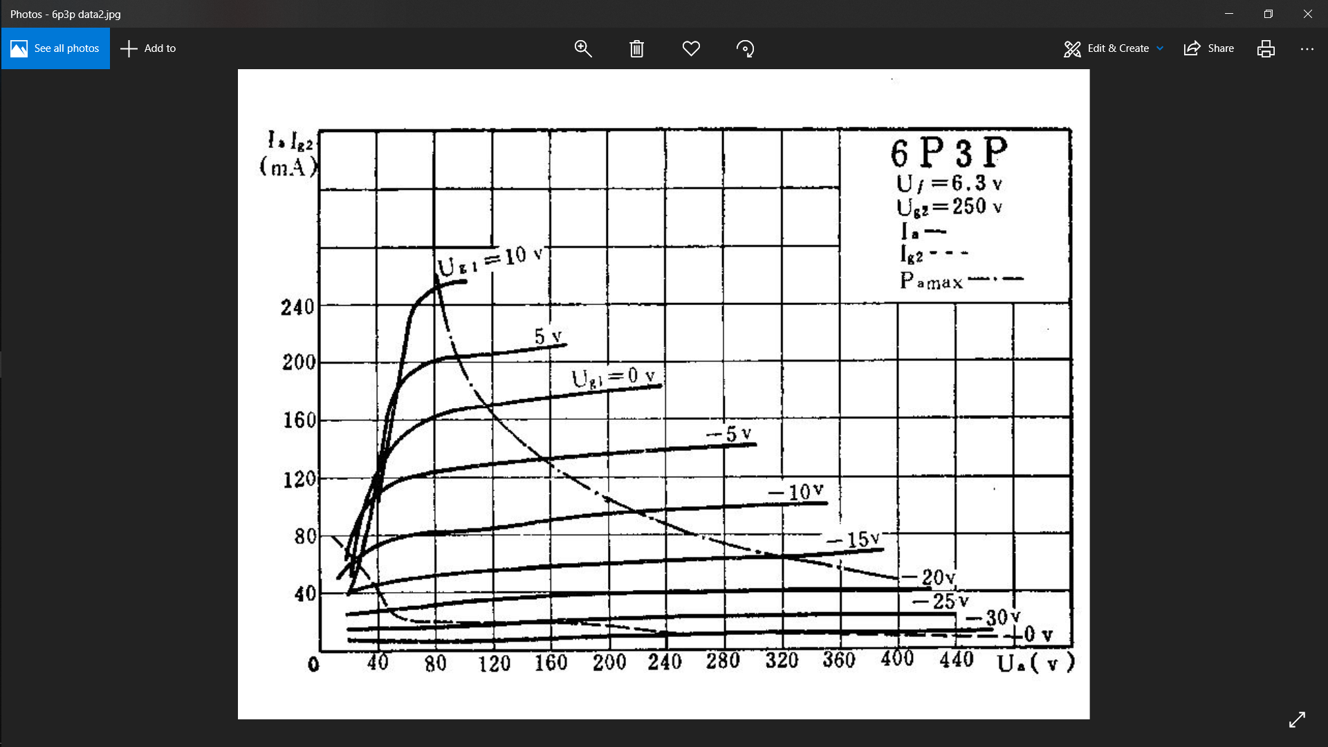

Disabled Account
Joined 2013

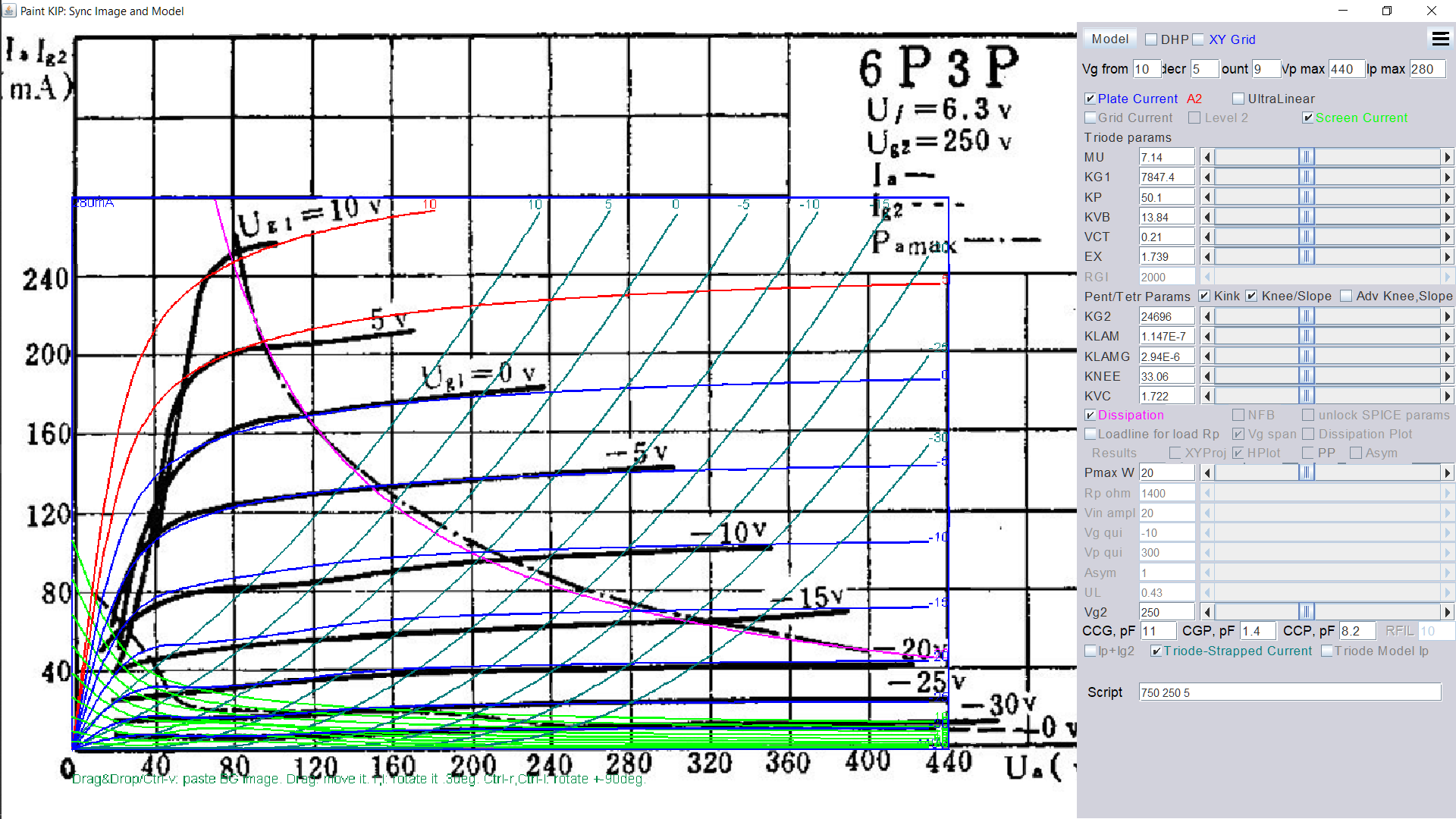

Tube model paint tools developer has some updates, some improvement in pentode with the addition of knee, kink and other like slop (klam, klamg), you may want to download it to see how it compared with other models.
Code:
**** 6P3P ******************************************
* Created on 08/29/2018 08:14 using paint_kip.jar
* [url=http://www.dmitrynizh.com/tubeparams_image.htm]Model Paint Tools: Trace Tube Parameters over Plate Curves, Interactively[/url]

* The following triode model is derived from pentode model, see above.
* In the triode model, all spice parameters come directly from the pentode model, except for Kg1,
* which for triode-strapped pentodes is derived from pentode's Kg1, Kg2 and Kvc as

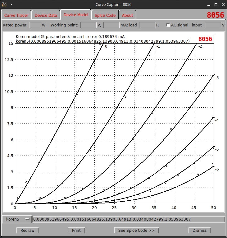

8056 spice model
Code:
* 8056 LTSpice model
* Koren model (5 parameters): mean fit error 0.189674mA
* Traced by Wayne Clay on 09/10/2018 using Engauge Digigtizer and
* Curve Captor v0.9.1 from RCA data sheet
.subckt 8056  P G K
    Bp  P K  I=(0.0008951966495m)*uramp(V(P,K)*ln(1.0+exp((0.001516064825)+
+ (0.001516064825)*(13903.64913)*V(G,K)/sqrt((0.03408042799k)+
+ (V(P,K))**2)))/(0.001516064825))**(1.053963307)
    Cgp G P 2.3p ; 0.2p added (2.1p) Grid to plate
    Cgk G K 4.2p ; 0.2p added (4.0p) Grid to cathode, shell and heater
    Cpk P K 1.9p ; 0.2p added (1.7p) Plate to cathode, shell and heater
    Rpk P K 1G ; to avoid floating nodes
    d3  G K dx1
.model dx1 d(is=1n rs=2k cjo=1pf N=1.5 tt=1n)
.ends 8056
